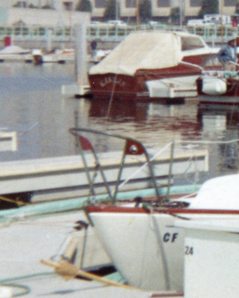

This was our configuration for 20 years. Perko lights. It got them off the deck and outboard of the headsail.
1-islander rick094.jpg (198.23 KiB) Viewed 6705 times
1-Dad 122.jpg (870.4 KiB) Viewed 6705 times
Smooth sailing.

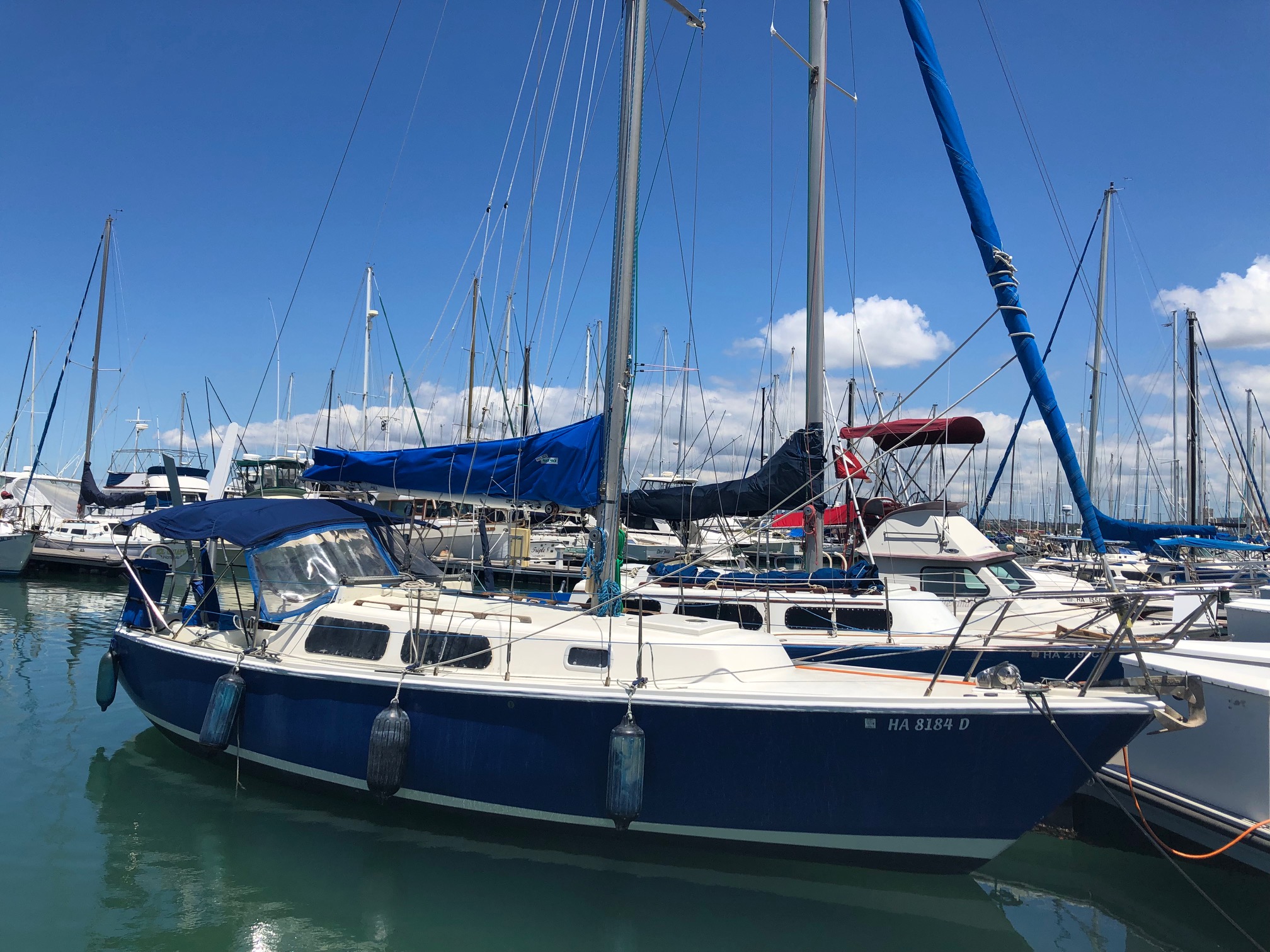

Thanks for the photos. Your bow looks just like mine although my PO put a solar powered fan behind where the roller furler drum is located. I may have to remove it or reposition the nav lights and mount the bow roller where one of the nav lights is located. Do you have any problems with deploying or retrieving the anchor with it slightly off the center?
Did you put any kind of shim under the bow roller to compensate for the raised rim on the bow?
rickmartyn
Posts: 15
Joined: Tue Oct 29, 2019 1:30 pm
Location: 1978 Cal 2-27 "Lagom" at Channel Islands Harbor (Oxnard, CA), and Sonora, CA
I haven't had any problems at all with the off center (and slightly angled to starboard side) mounting. I did put some plastic "shims" made of StarBoard under the bow roller to level it out. I think you can see them stacked up if you zoom in on the fourth photo.
