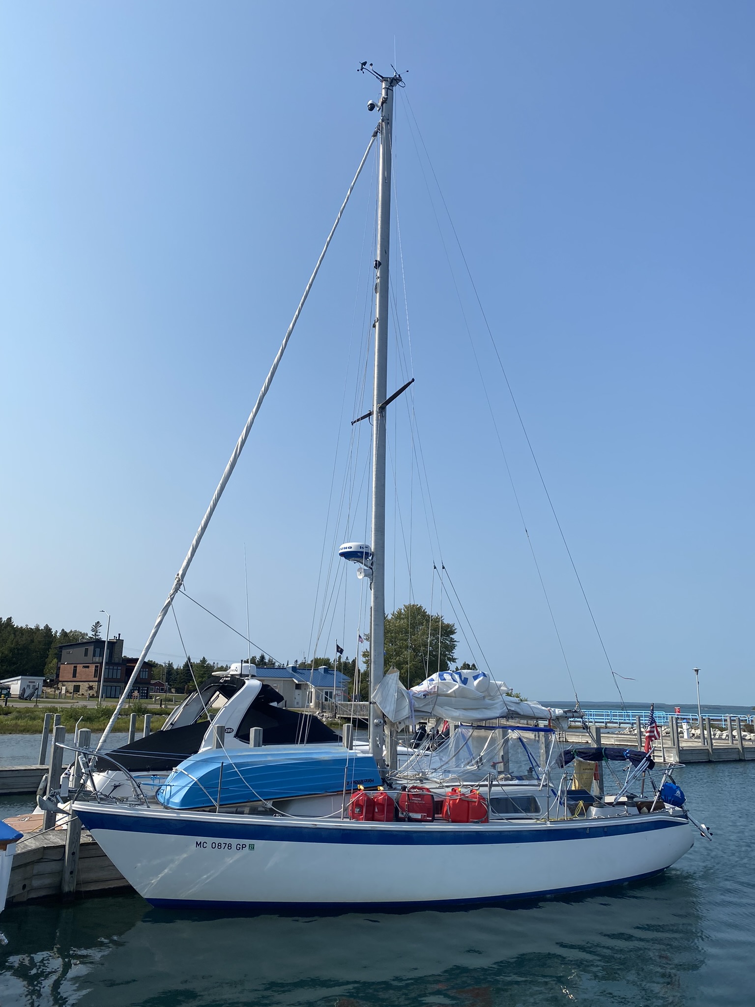

Hey all! I was given this 2-30 in January of 2024 by a friend who knew I would finish a refit and sail her! I feathered out and glassed all the holes in the deck (just under 650 in all) and started over. Sanded off all the non-skid and painted the deck with awlgrip. Everything leads back to the cockpit now. Single line reefing with 2 reefs. Built a dodger, did a valve job on the A4, built a new muffler, installed a heater, a ladder, AIS, a new radio, and an outboard bracket. Built a false floor between the head and the sink with storage underneath, makes the head a lot more comfortable and adds a little storage. Built a propane locker in the port lazarette, installed a propane range. New window for the port aft deadlight. Anchor roller. PTZ camera near the top of the mast, Furuno RADAR, new table-top for the galley, complete electrical replacement and lots of red and white LED lights. All new stanchions from a different boat, dyneema lifelines, water filtration system, a couple of 135Ah LiFEPO4 batteries and charging system, new DST810. Also installed a Pelagic tiller pilot which is wonderful. Replaced the head as well.
I made it out over 100 times last year. longest trip was 2 weeks from Marquette, MI to the North Channel and back. This year looks like it'll have a little less sailing time.
This winter I recut all the sheaves in the mast to accept 3/8 line rather than the cables that were in it. All new halyards and wind instruments are in the mail right now. My lovely wife bought me Starlink for Christmas. I got a trashed 7 foot fiberglass dinghy and rebuilt that over the winter. Rebuilt the cap on the rudderstock and built a new aluminum tiller.
I'm looking for a nice little diesel if anyone has any comments on that I'd be very interested.
Thinking about replacing the forestay and backstay, not sure. Also considering a tri-color light.
Also looking for a working jib in decent shape and a trysail.
I did all the work myself. If you have any questions, I really enjoy meeting new people and solving problems!
