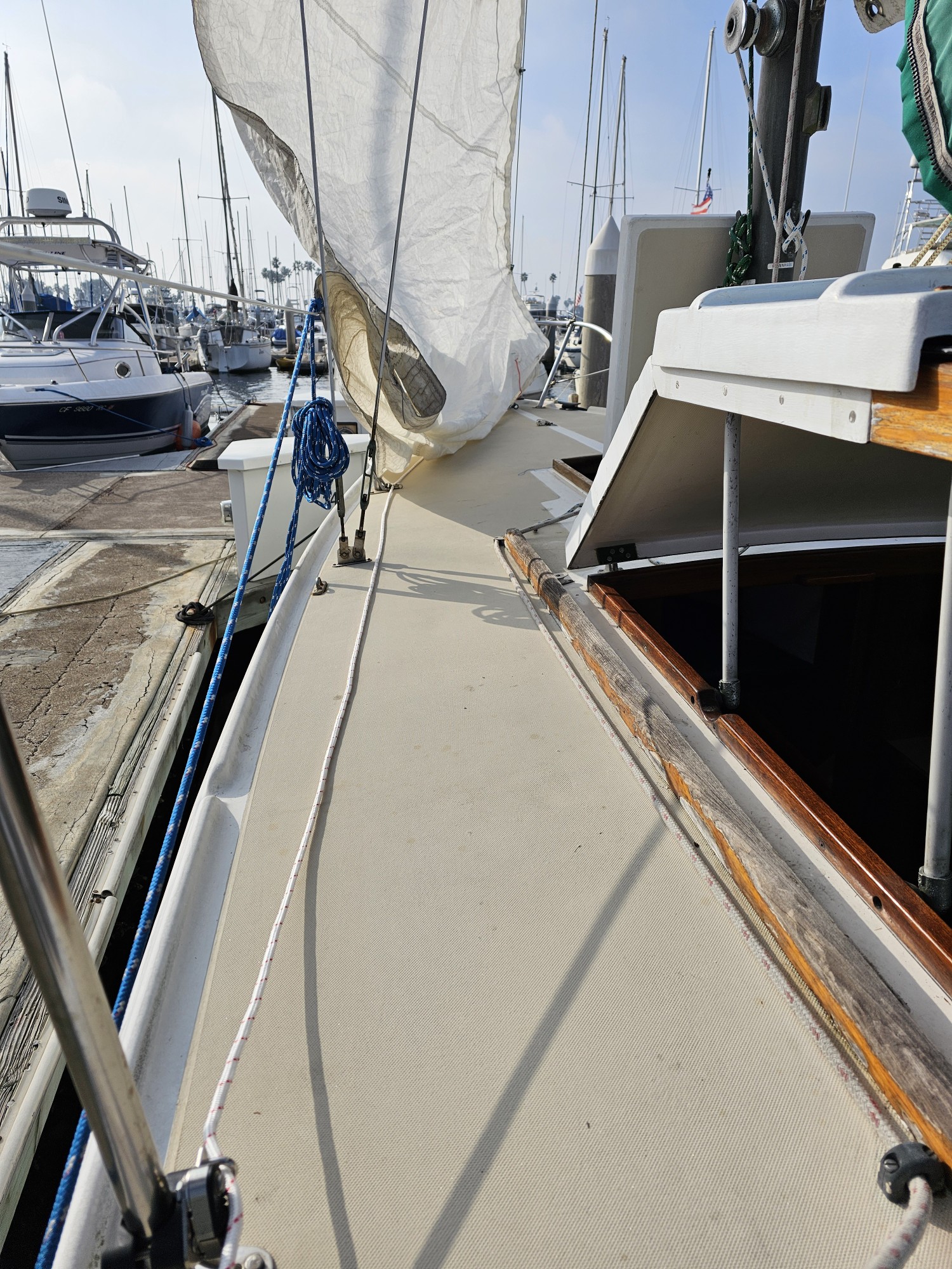

Bringing the jib down on a calm day.

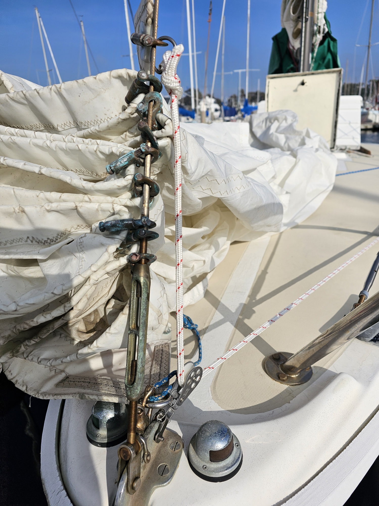

A 'D' ring slipped on to the top sail snap, light line to a base mounted block.

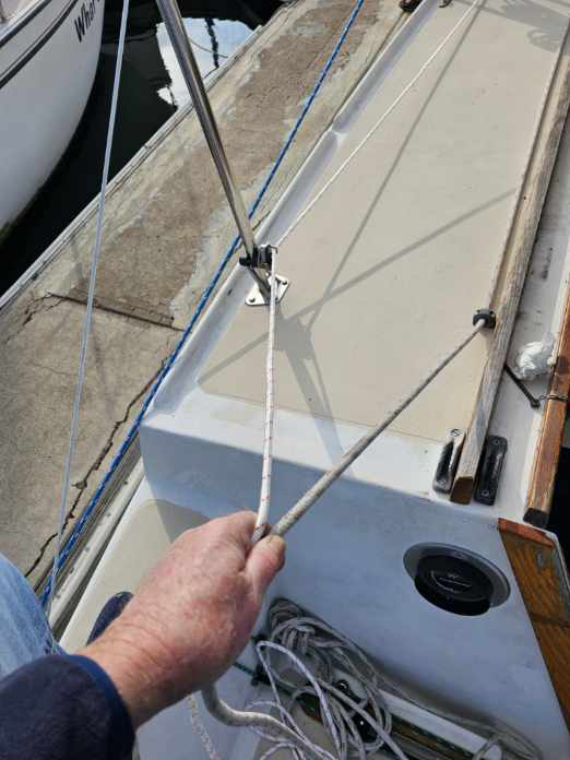

The line led aft using blocks on stanchions and a cam cleat, like roller furling.

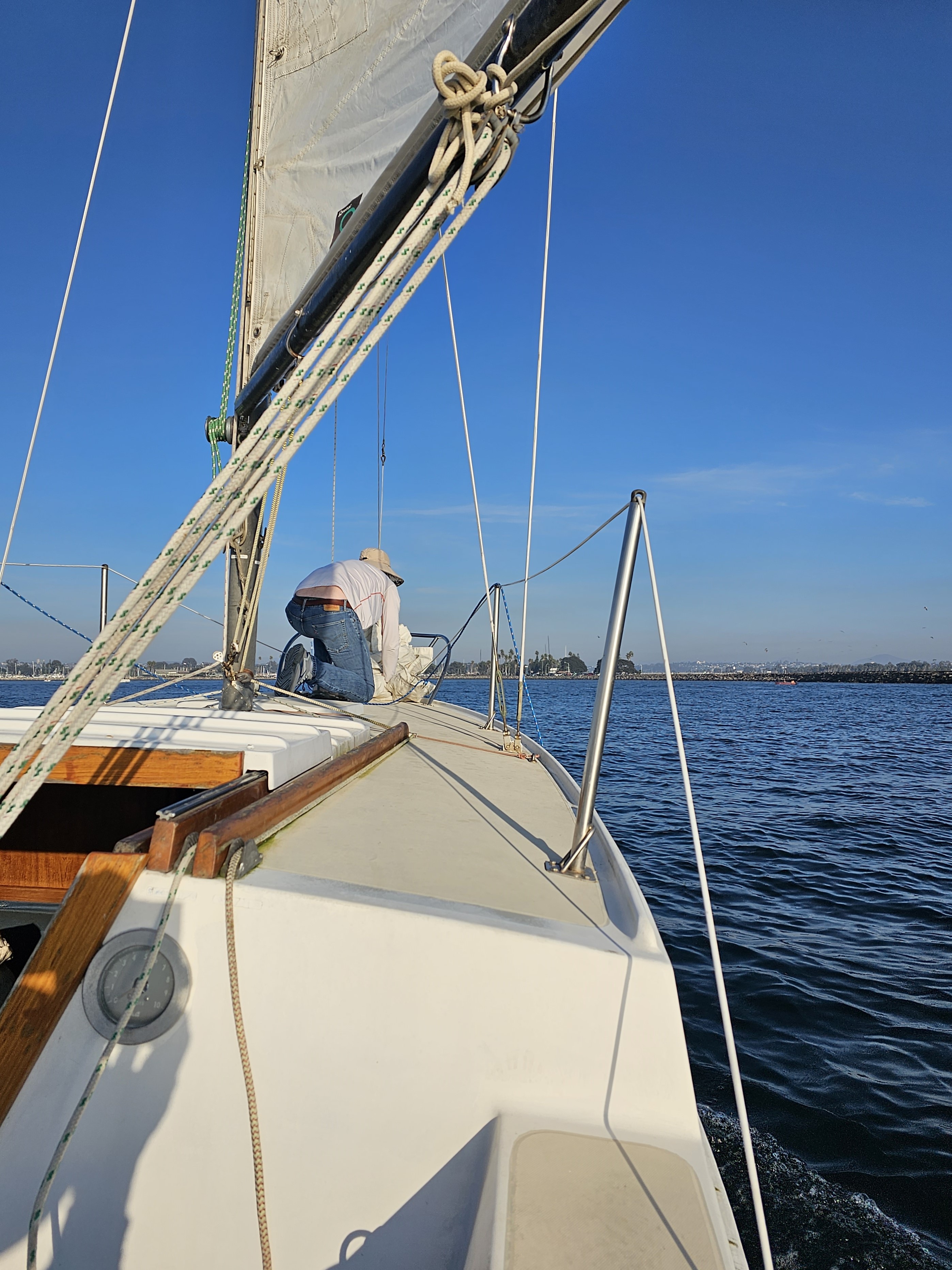

Using the furling line in conjunction with the aft led jib halyard.

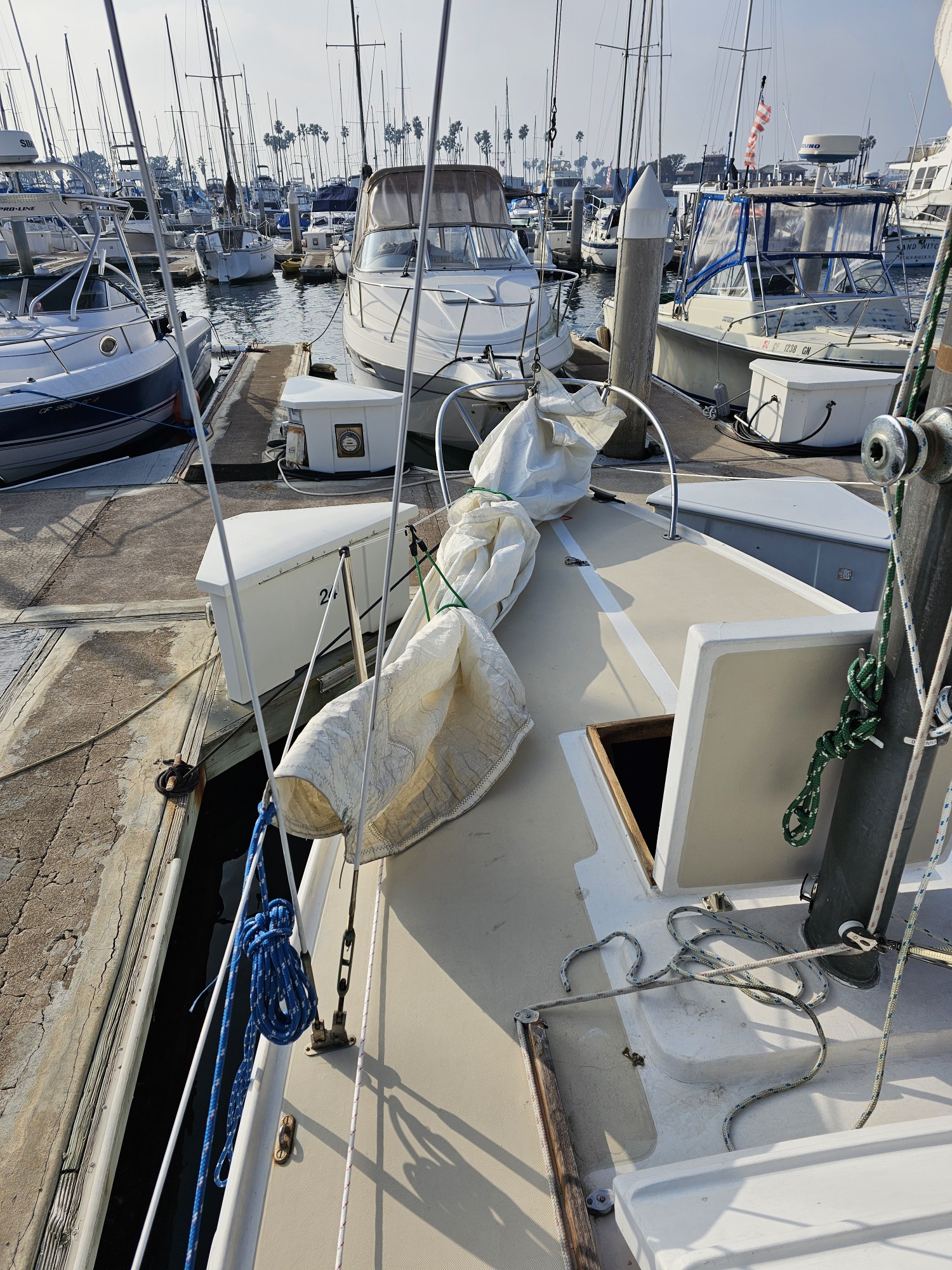

Using the furling line, halyard, and the sheets you can drop the sail to the deck and hold it there, all from the cockpit. A short trip to the foredeck to throw some bungee cords around the sail and you are done. If we were expecting the wind to increase we would have the working jib already hanked on below the Genoa. You just need to unsnap the Genoa feed it down the deck hatch and raise the working jib. Nothing really new here but it is surprising to still see so many sailors struggling with the jib.
