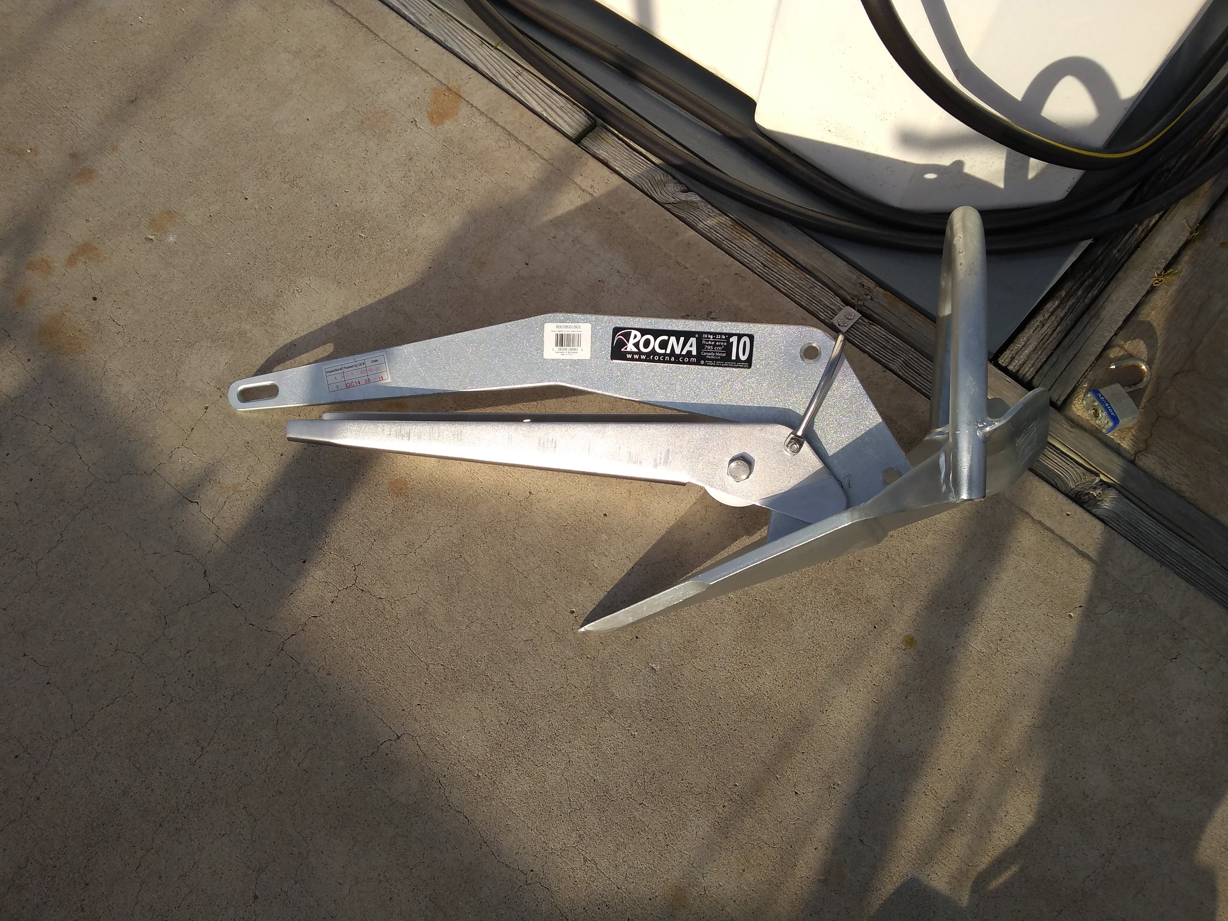

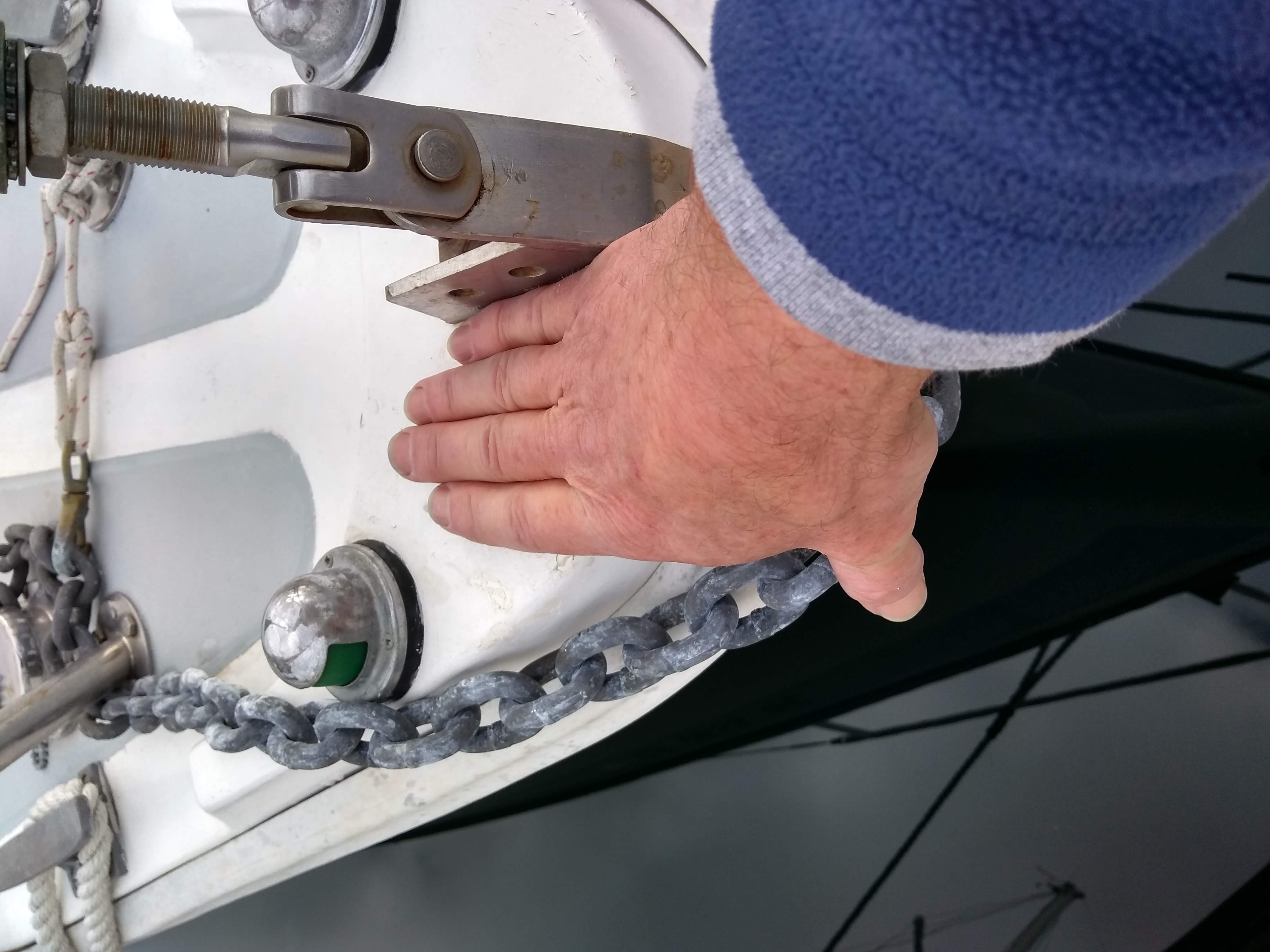

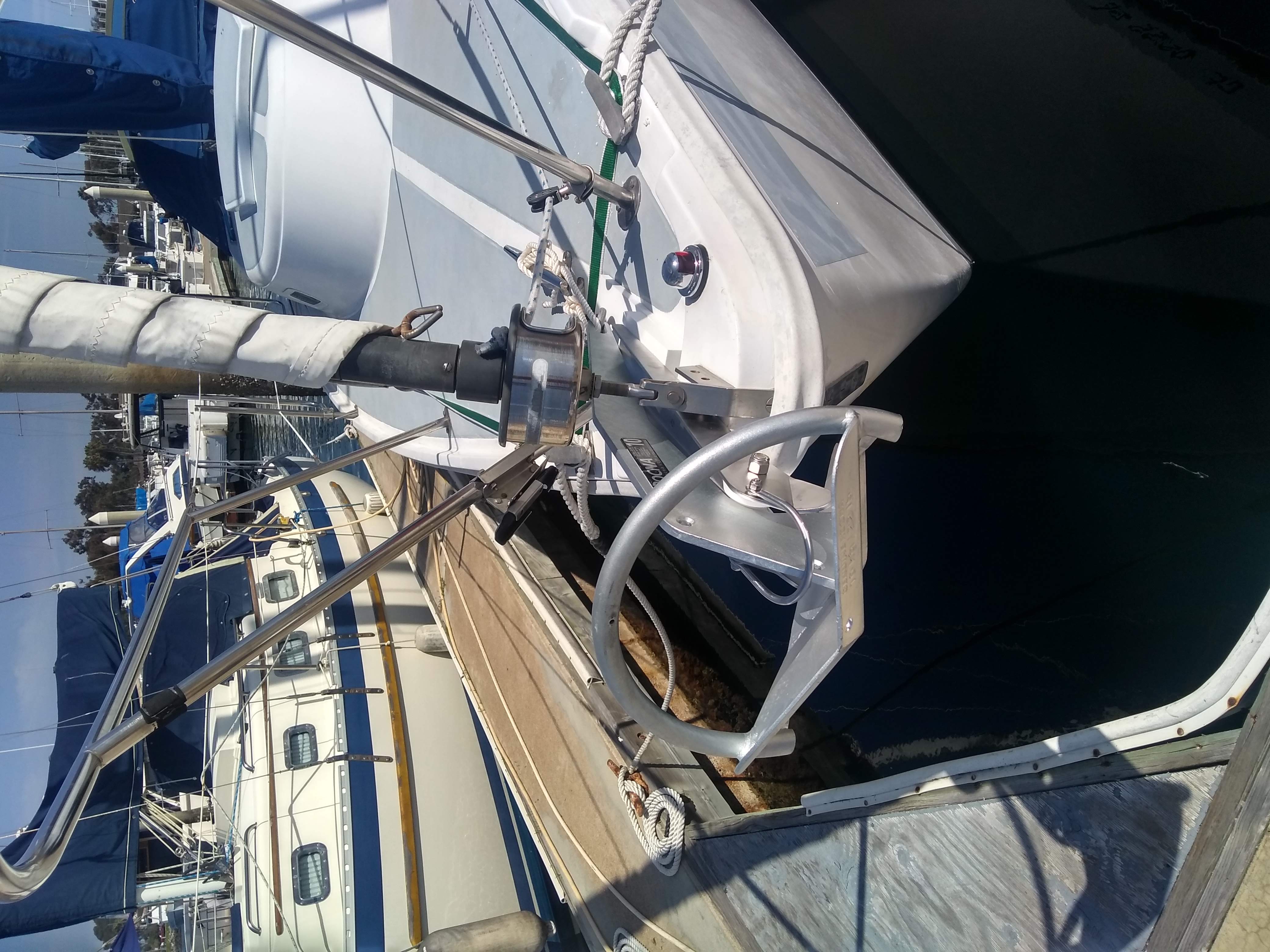

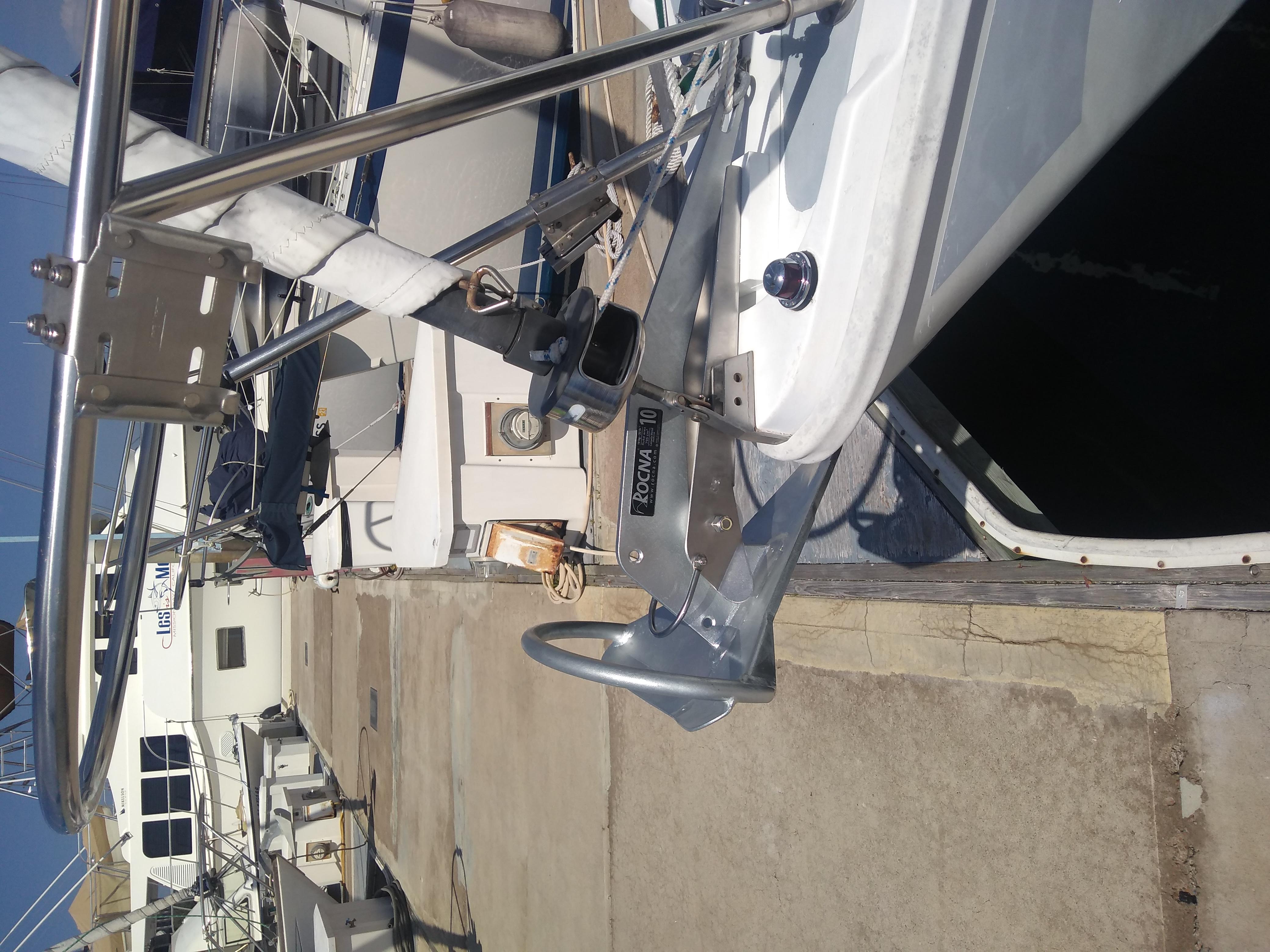

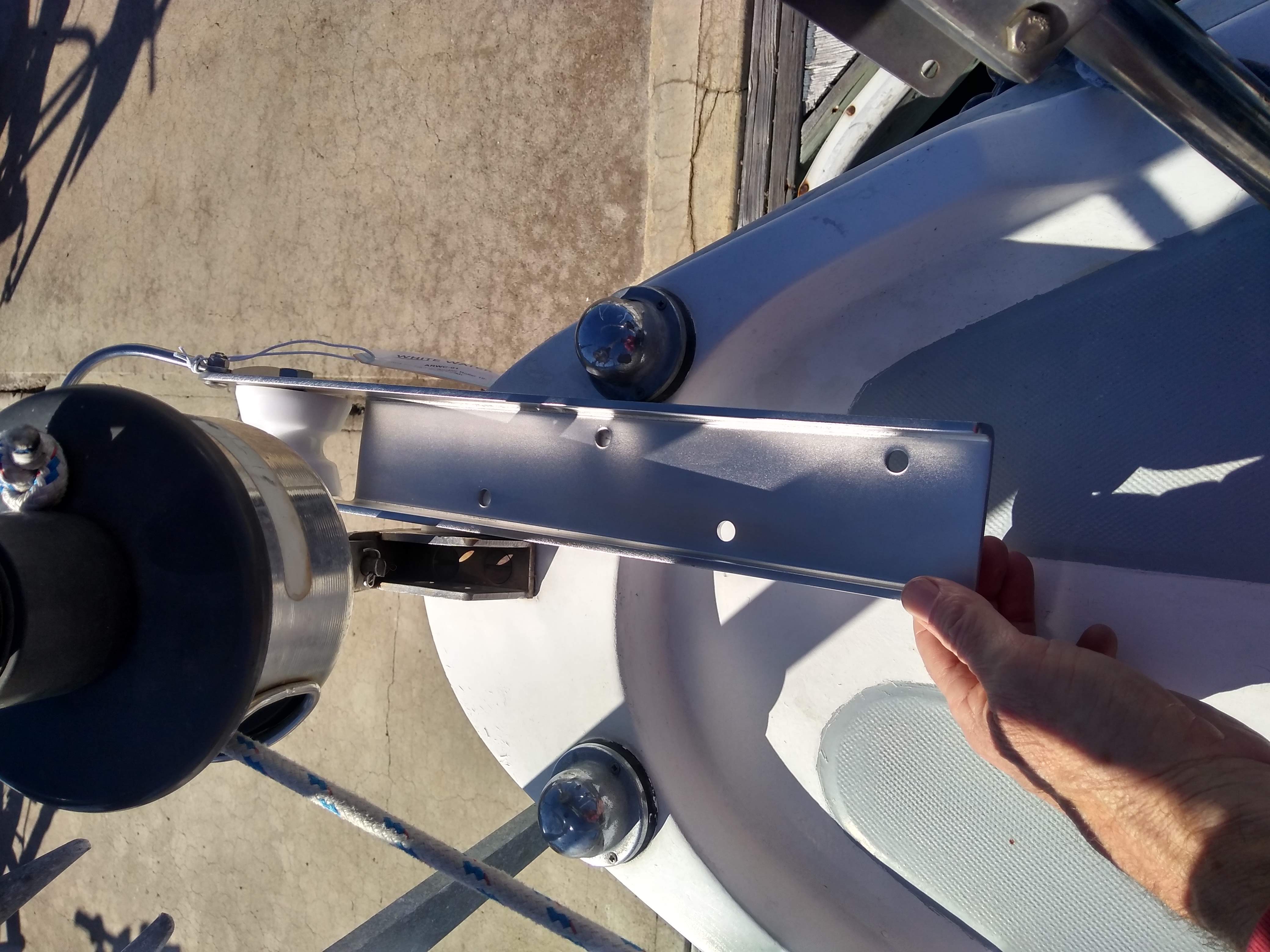

I added a bow roller and large cleat to my 1978 Cal 2-27 a couple of years ago to handle a 22 lb Rocna. I think this link will still work for pictures I posted once before.
https://photos.app.goo.gl/EoVcHqiZoHfEBneh8
Let me know if you can't get to the pics or if you have any questions about what I did.
Rick
(Edited) I think I figured out how to get the pics in the post itself:
