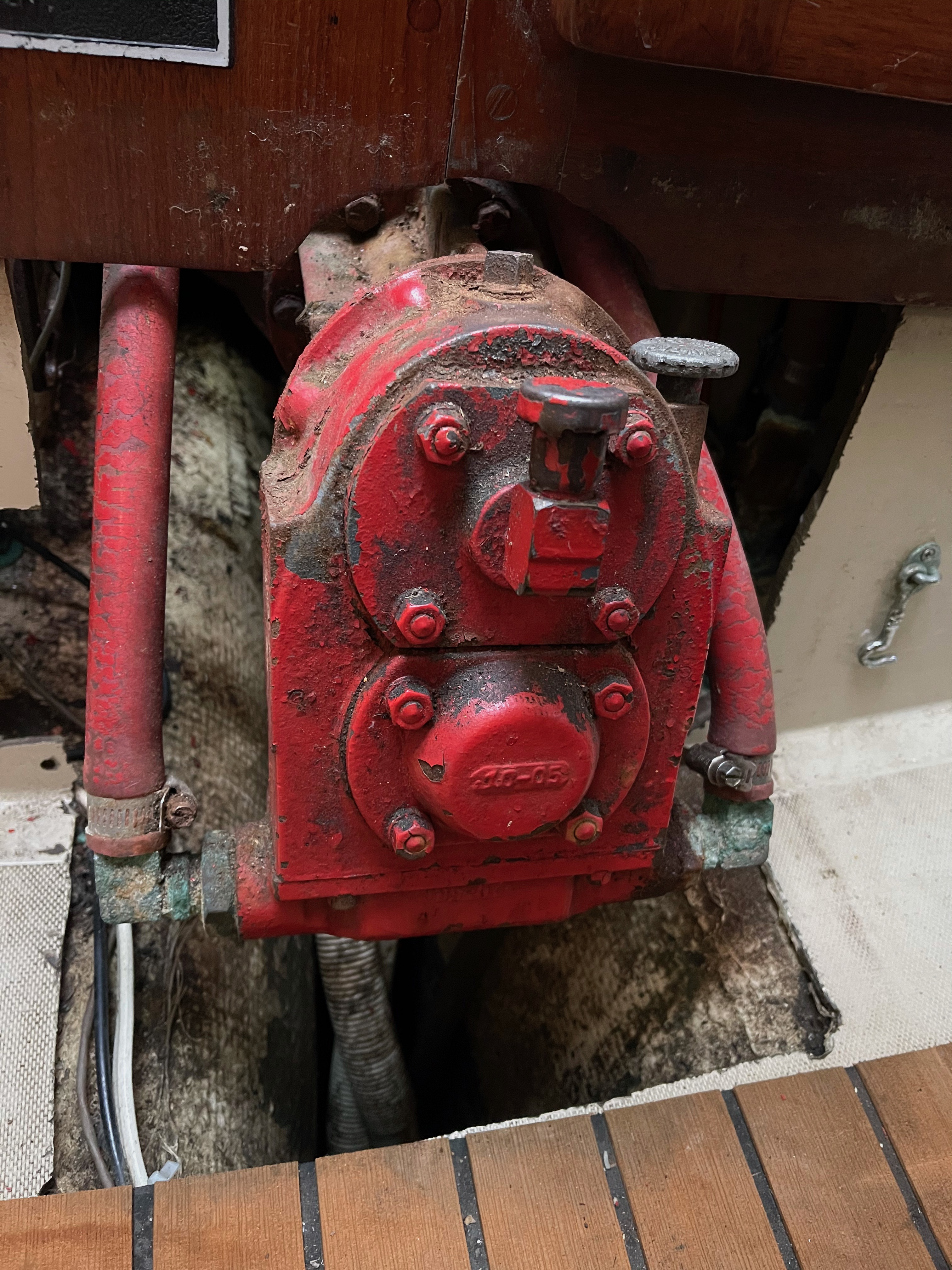

I got my 1978 34-III back from the yard today where it had a bunch of work done including an engine service. After motoring for a little while, there was a lot of smoke coming from the breather on the gear. It was very hot. It never did this before.

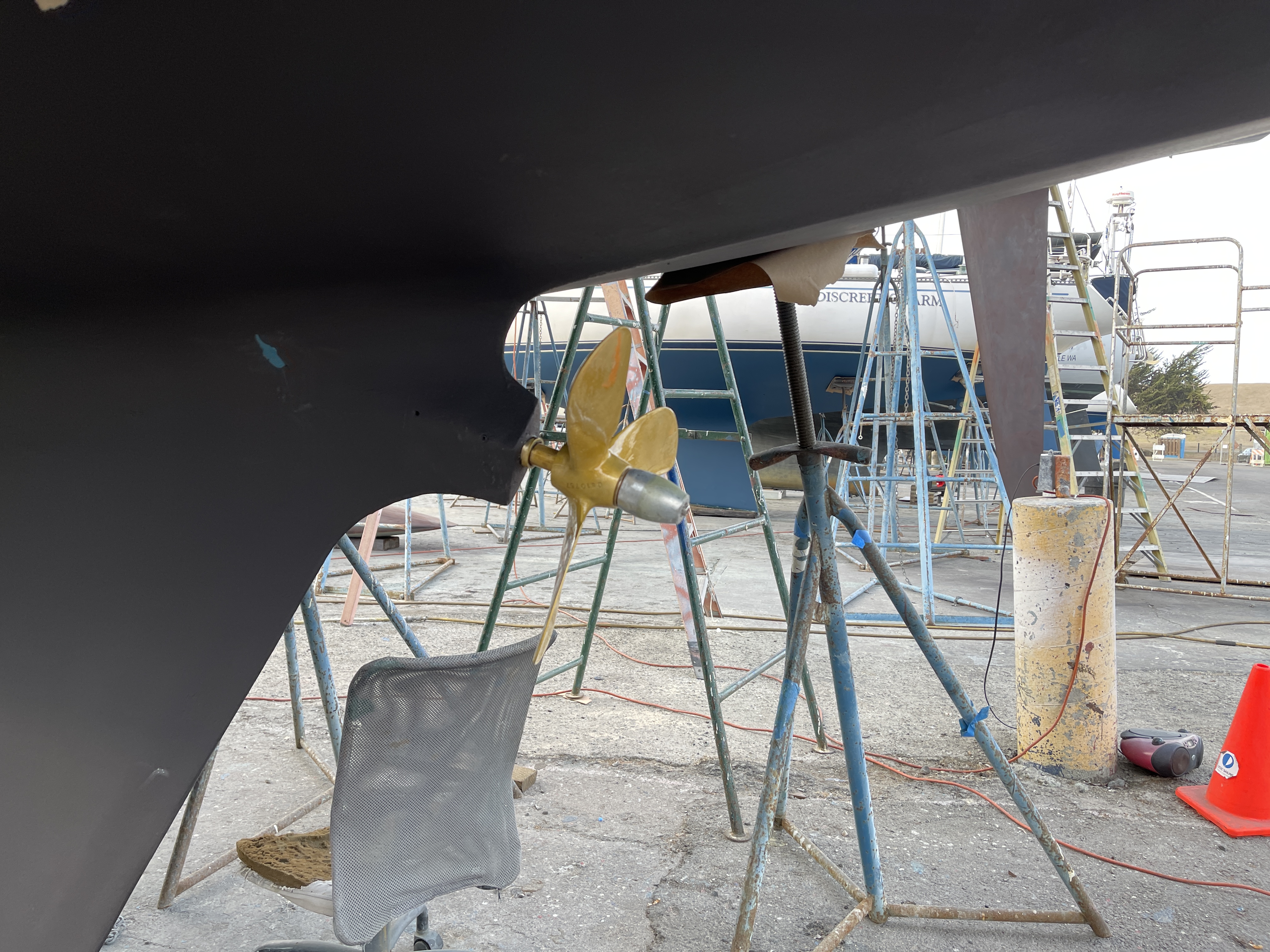

I'd asked them to change the oil in that and the Paragon V-Drive. I also replaced the old 2 blade prop with the recommended (and tested on this boat/engine) Campbell Sailer 3 blade 16x9, but I don't think that should cause this.
The engine ran and sounded great. The exhaust looked good.

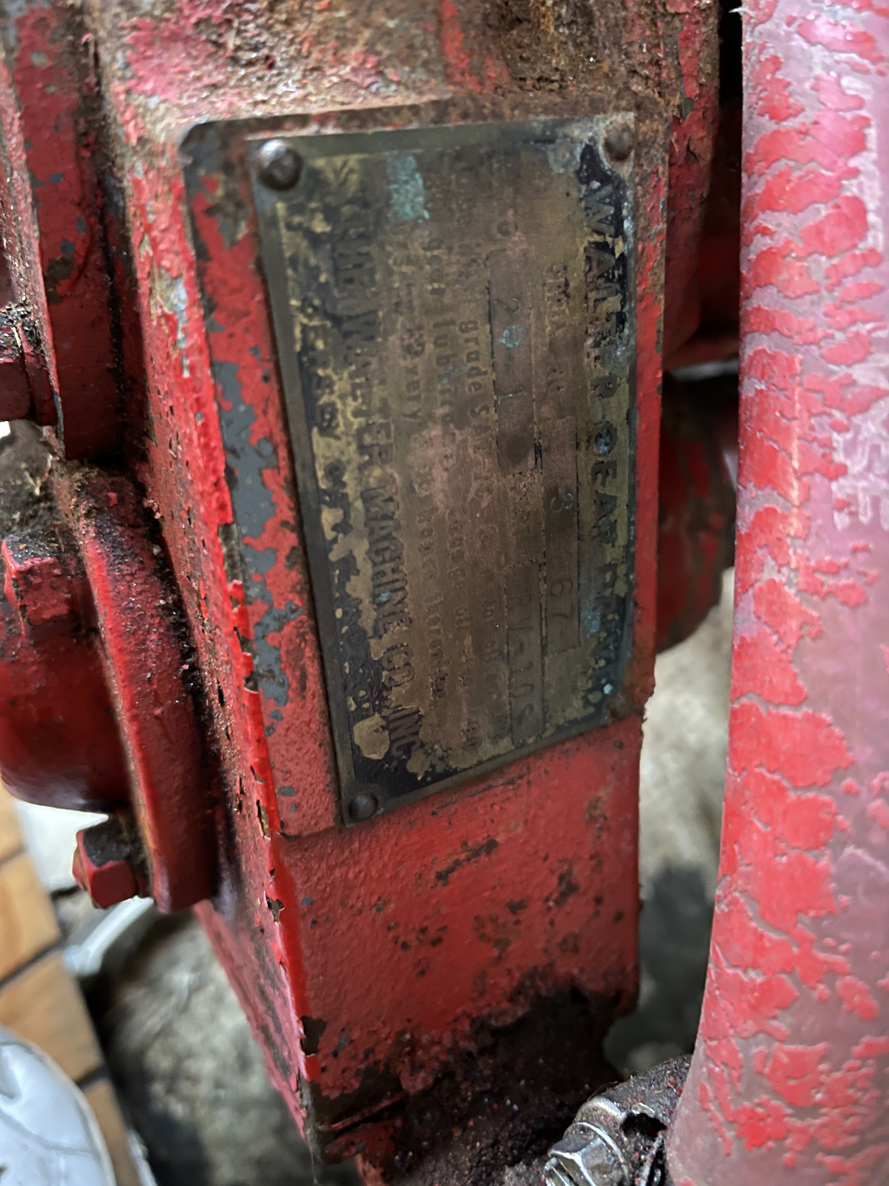

Where do you check the oil on this?

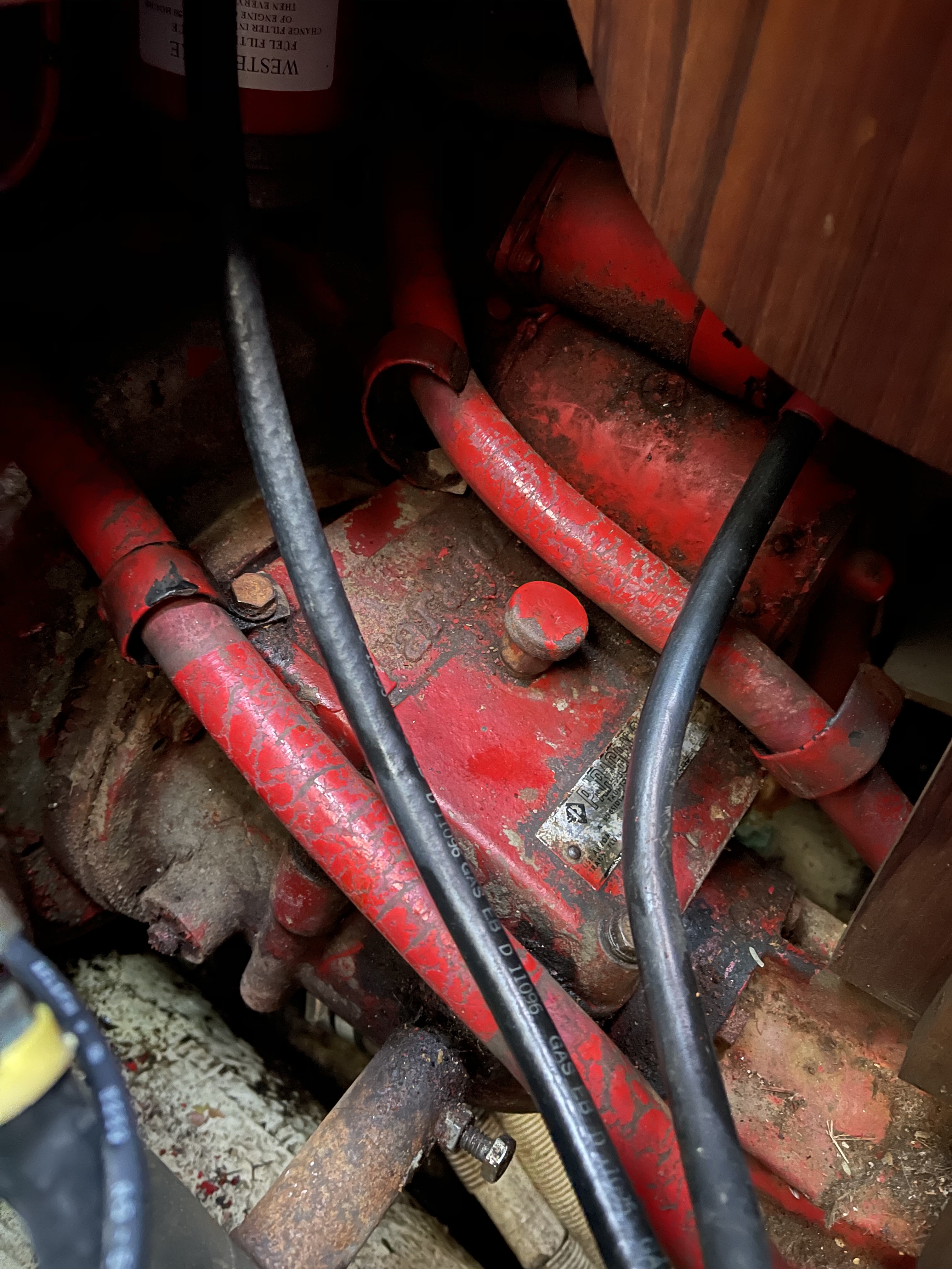

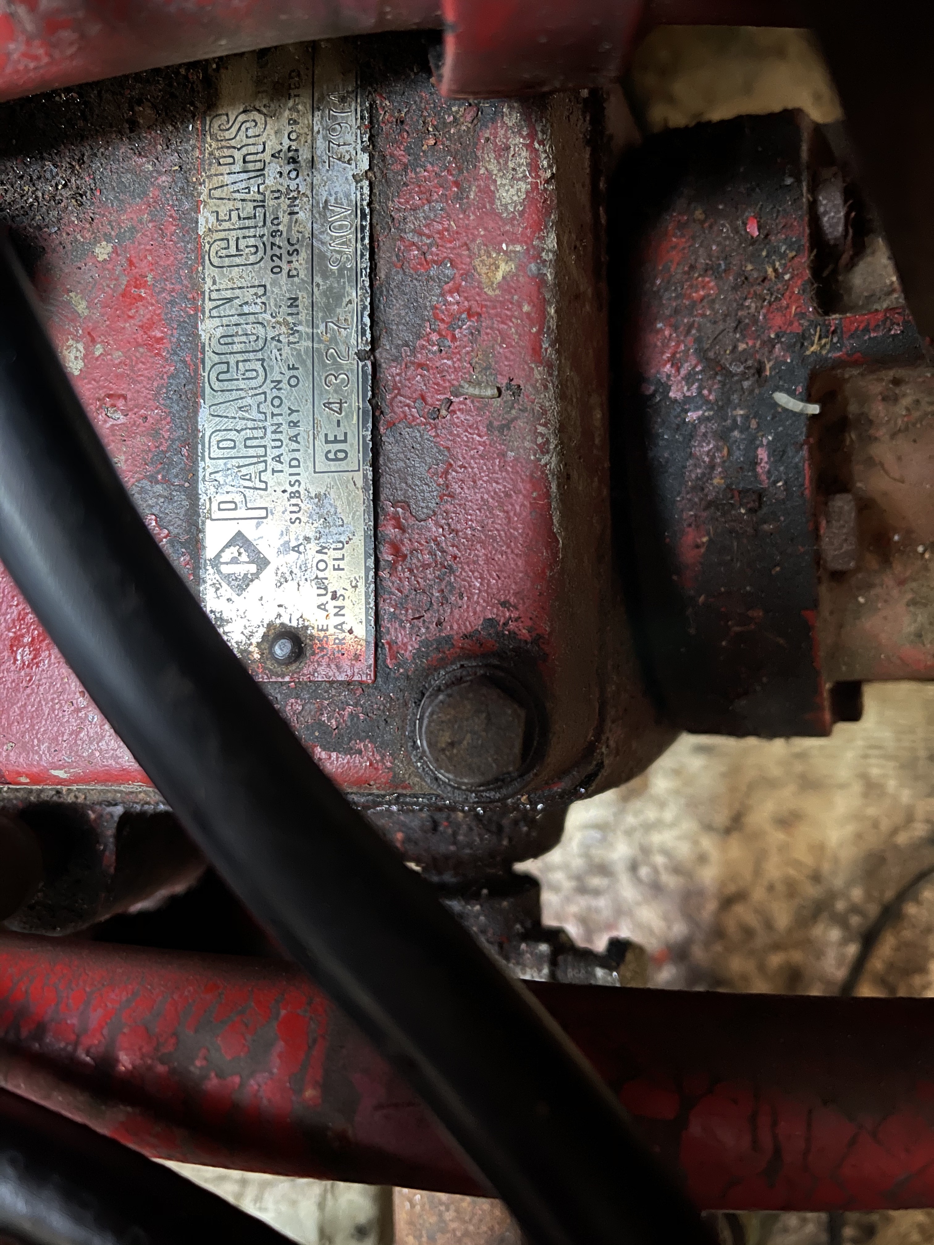

How is it cooled? There are lines going to the v-drive, but not the gear.
Thanks!
Hi Mary, I hesitated to make any comments about your transmission and V-drive hoping that someone would step up with some more precise information. It sounds like Bob may have the manual that you need. That would be great if he could get a copy to you. The only information I can relate to you would be about the V-drive and transmission on my 67 Cal 28. Which may not be the same or even similar. But I'm going to go ahead and toss the information out there and hope that someone with information that would directly pertain to your situation will correct me. The V drive and the transmission on the 28 had a shared lubrication source. Meaning there were no seals in between the V drive and the transmission. If you overfilled or under-filled the assembly you would get overheating. If you mixed your types of lubrication without completely draining the assembly and refilling it with a different type you could get overheating. I do believe that you have fresh water cooling so the air bubbles in the raw water cooling system after a haul out would not be your issue. If the lubrication was mixed or there was a lot of debris from the transmission it can clog the small holes that connect the V-drive to the transmission. This means that if you fill from the V-drive sometimes you have to run the engine or wait a while for the fluid to fill up the transmission. If you just do a quick fill off of the V-drive it's possible the transmission would not get it's lubrication filled adequately. The only time I pay someone to do a job for me it's because I want them to have the responsibility of it turning out right. I would get in touch with the yard and explain the problem and see if they come up with logical Solutions or at least explanations before I did any fretting or work on the perceived problem. If they have the solution I would praise them in the media, conversely if they have no explanation or solution I would blackball them in the community. If you pay someone to do a job and it's not right they should suffer the consequence. I know I come off sounding like a crotchety old man but I guess that's what I am.
Oh also I forgot to mention that for the 28 you needed to hold the shift lever in reverse and if You released it it would go to neutral. It would lock in forward. I can't say that the transmission in your 34 is a similar design.
Check your dipstick on the port side of your V-drive to see if the level is overfilled or under-filled. Also look at the consistency of the fluid if it is frothy you know you have a mix problem.

Hopefully the yard isn't too far away. My only advice is just a repeat and that is to check the level of the fluid. If I had to guess, I would say the yard drained the old fluid and forgot to put in the new. I would not run it without making sure I am wrong.

Anyway.. my good friends who picked up the boat believe that the oil type may be wrong in the transmission. There are separate oil types in each section. I will replace the oil when I can get back to Alameda sometime in January and go from there.
