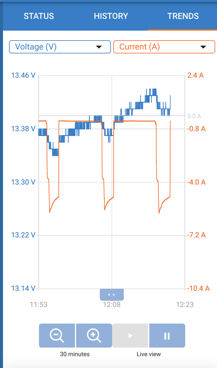

Hi Mary: here's my trace for the Isotherm. You really have to use the PC/macOS desktop version of the Victron app to get anything useful. The fridge turns on and draws 5-6A for 2-3 minutes, with a duty cycle depending on external temperature, fridge fill level, internal. temperature setting. With average setting and configuration the duty cycle is about 20-30% on and the remaining time off.

I will download the app for my computer to check like you did, but I believe mine does the same draw. I do not think it cycles on as often, though.. even with the sun shining directly on it. I have it installed where the oven once was (different galley location than your boat). It has some open space to port/behind the fridge, and I left a space open on top in the counter for ventilation.
