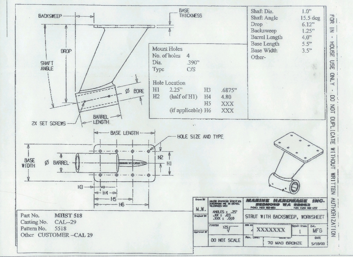

Could be worse , my diver told me I have a broken prop shaft strut. Any thoughts ? Prop shaft turns freely ,not to freely ,but slight tension from the stuffing box ,cutlass bearing seems ok and the prop shaft is true. Engine alignment is ok . I'm assuming I hit a dead head while sailing and tweaked the strut . Probably only going to get worse . No ingress of water yet . Will find out how good State Farm insurance is.
Anybody have specs on a new prop shaft support . For a cal 29 ?
I will check some of our detailed drawings, I know we had one from Lapworth that was labeled as prop shaft angle.
Here you go.
