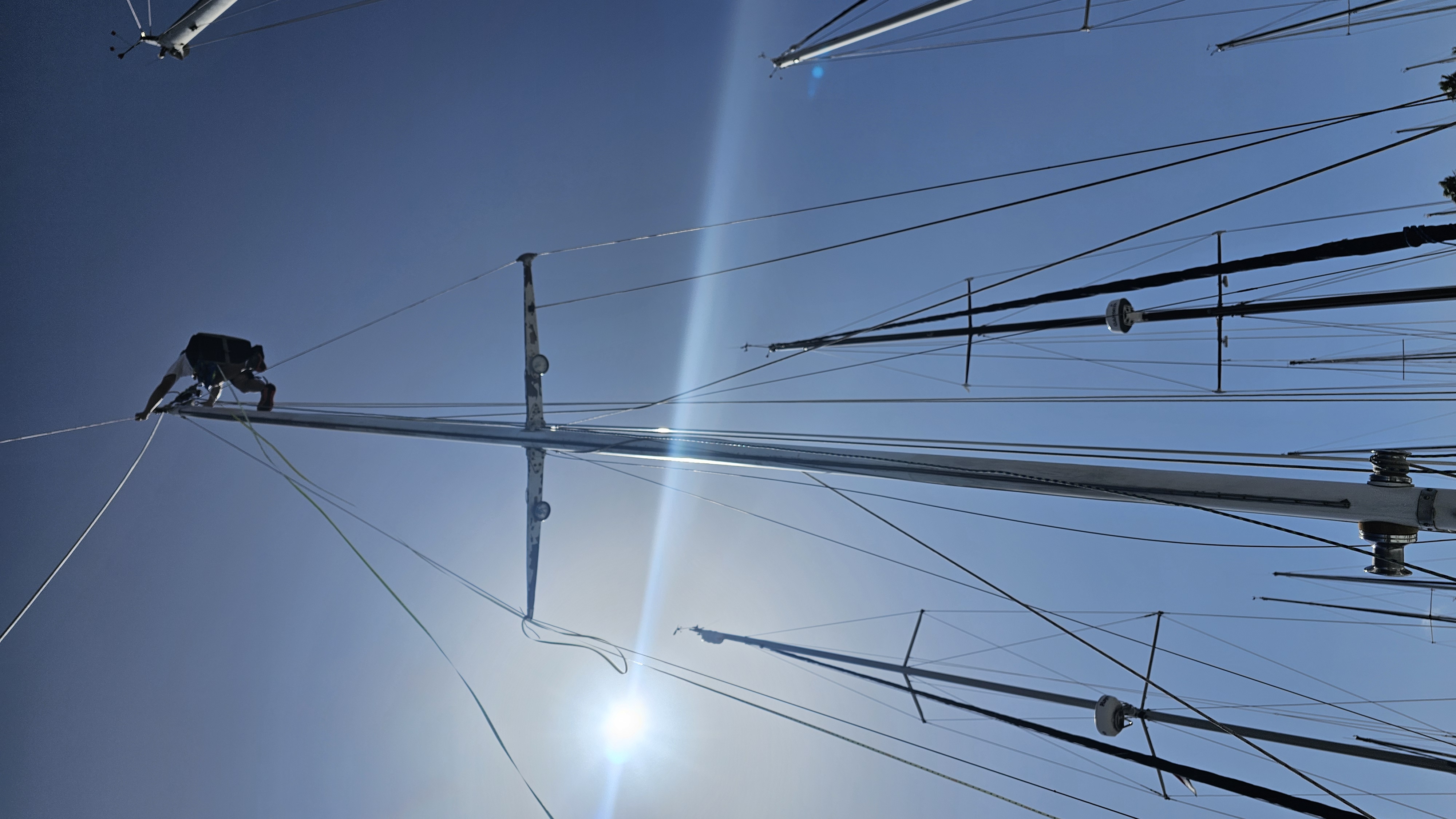

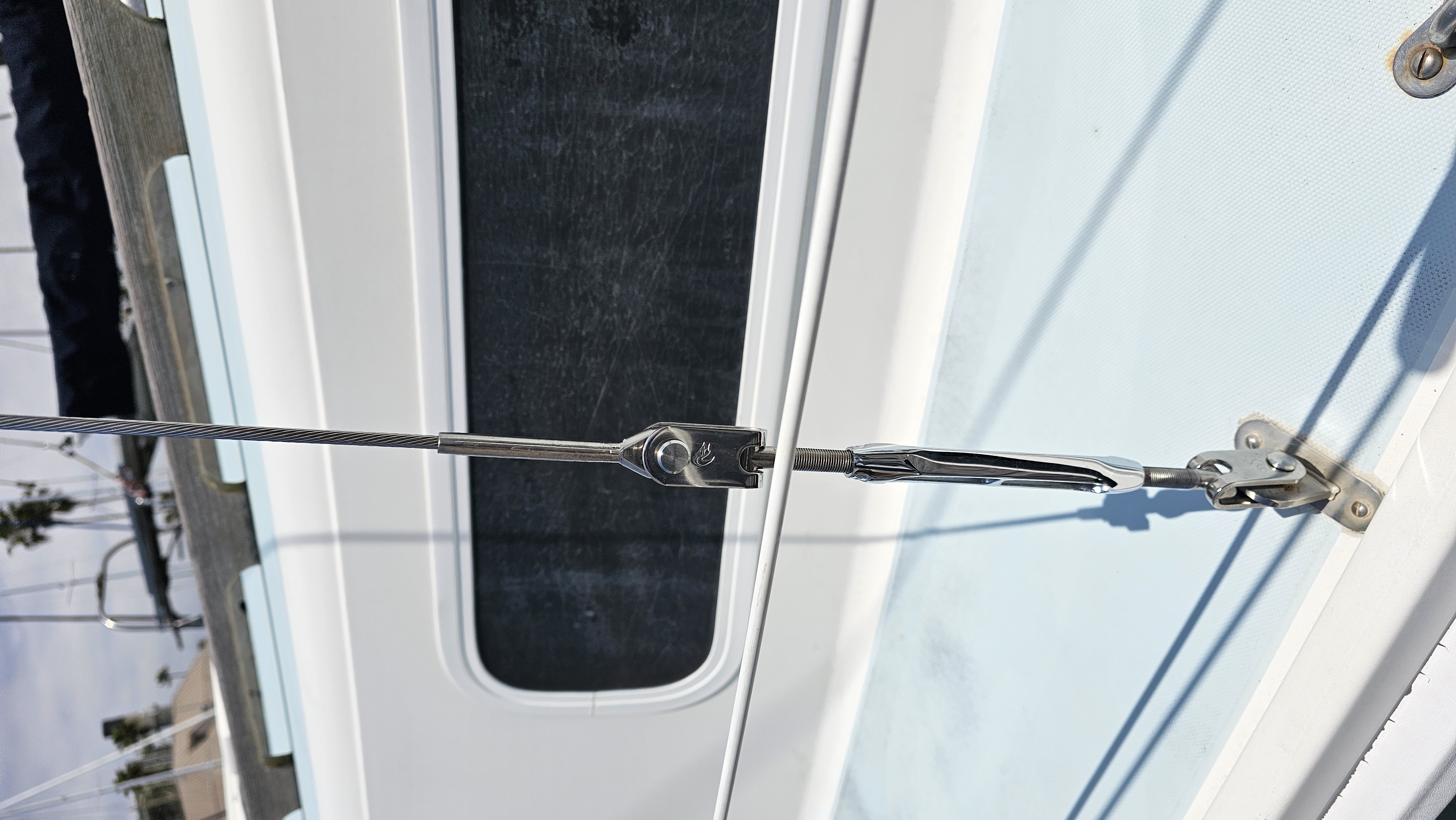

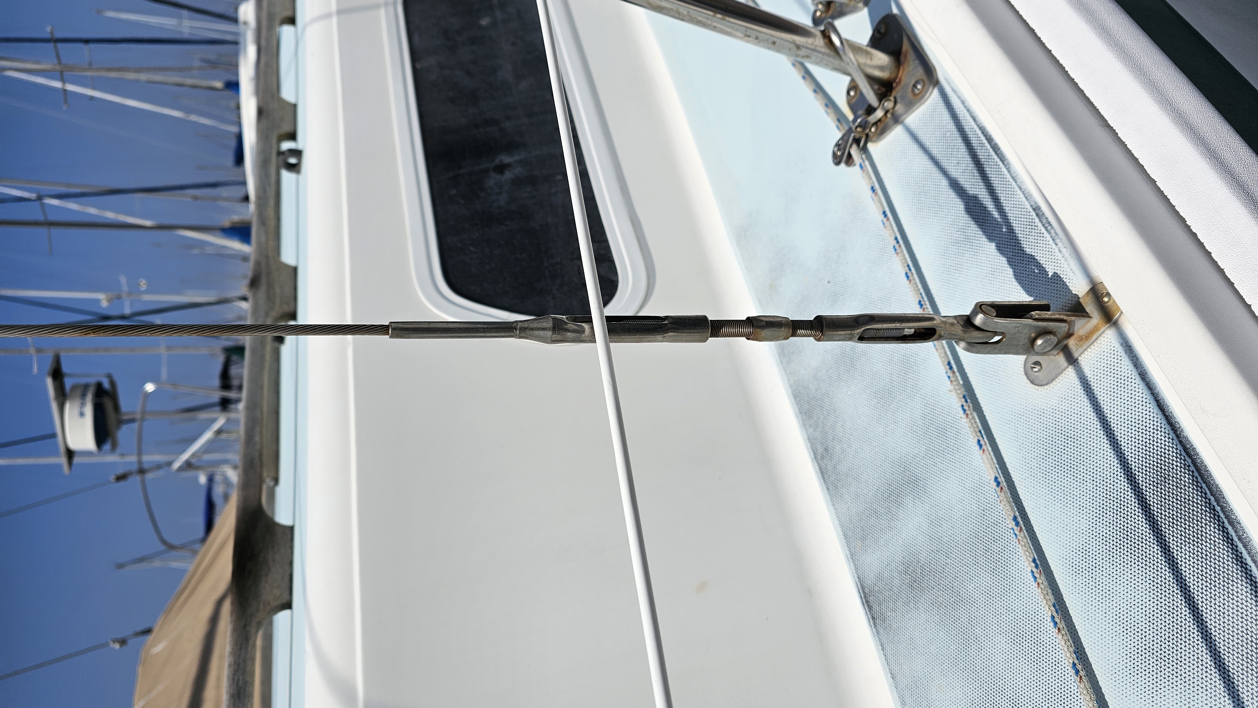

I met him down at the boat the next week to get started. The aft starboard lower turnbuckle had snapped during our last trip. So I had run a halyard in its place. He wanted to check the turnbuckles and the rig tension before he went up the mast.
After considerable measurements he tackled the aft port lower turnbuckle. As soon as he started to loosen it, it snapped. He chuckled and said you did say the rigging was bad. I ran another halyard to replace that lower and he dug into the real work.
I had requested a change in the quote to have isolated chromed bronze turnbuckles.Even though it gives more failure points it will allow me to swap turnbuckles or shrouds without having to replace the whole thing.
Probably silly but in all my years of sailing I have never had a shroud fail, only turnbuckles. This was to be the first of many additions to the bare bones quote.

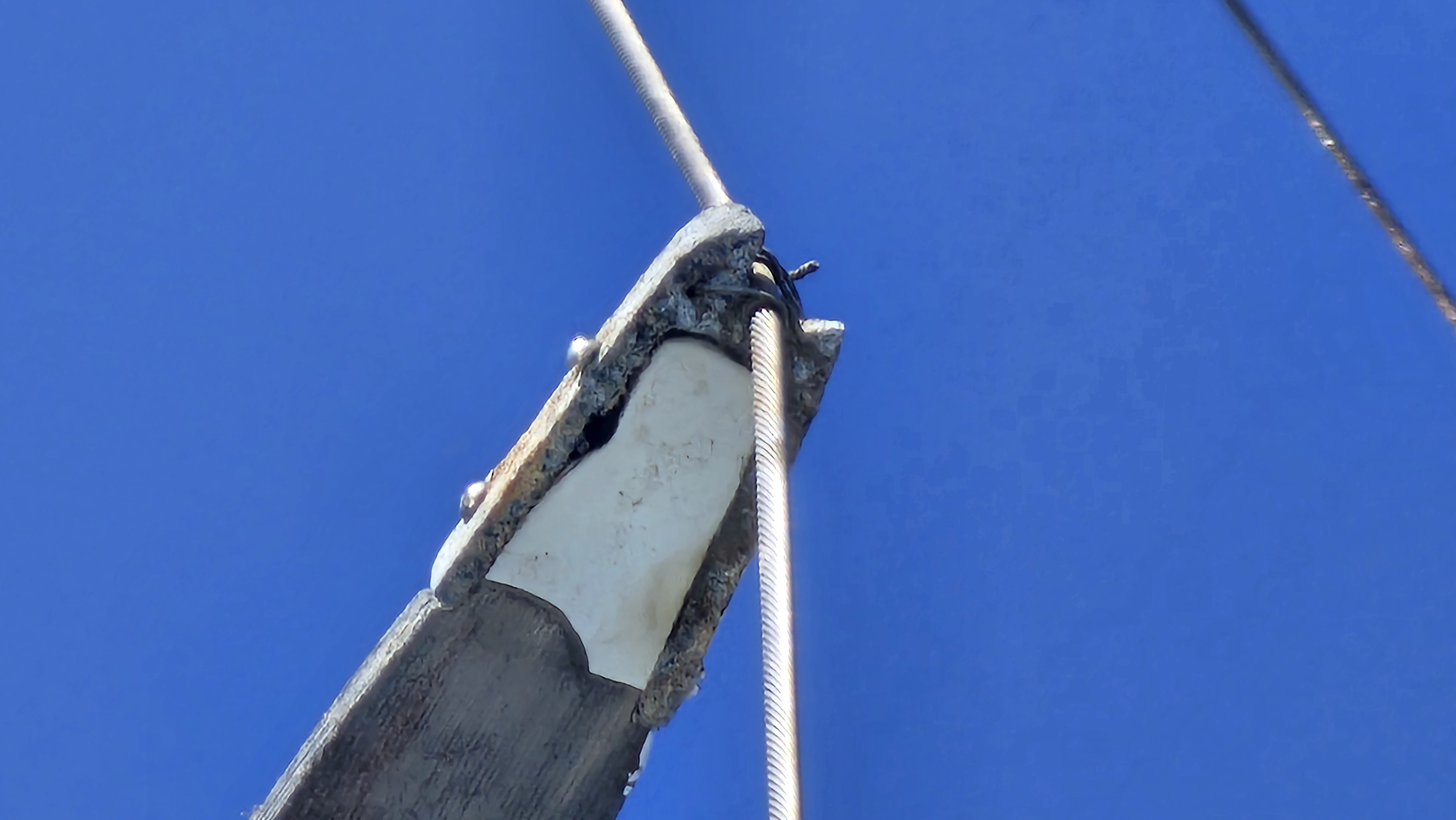

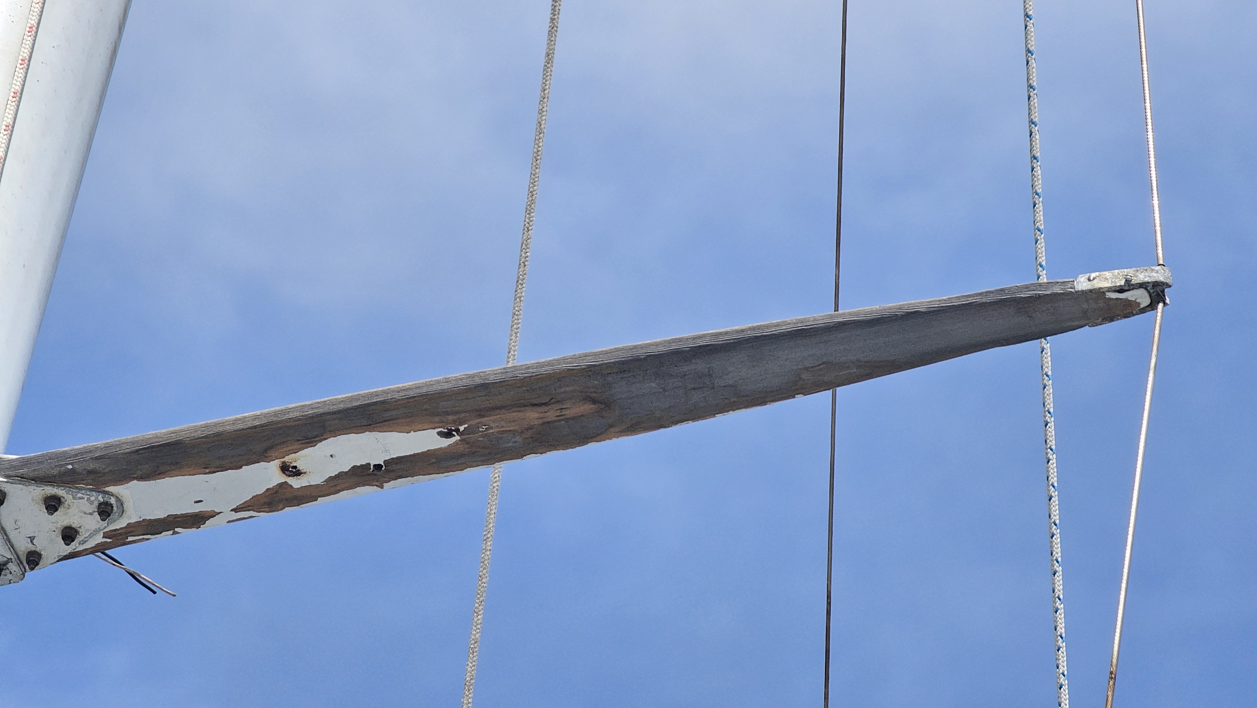

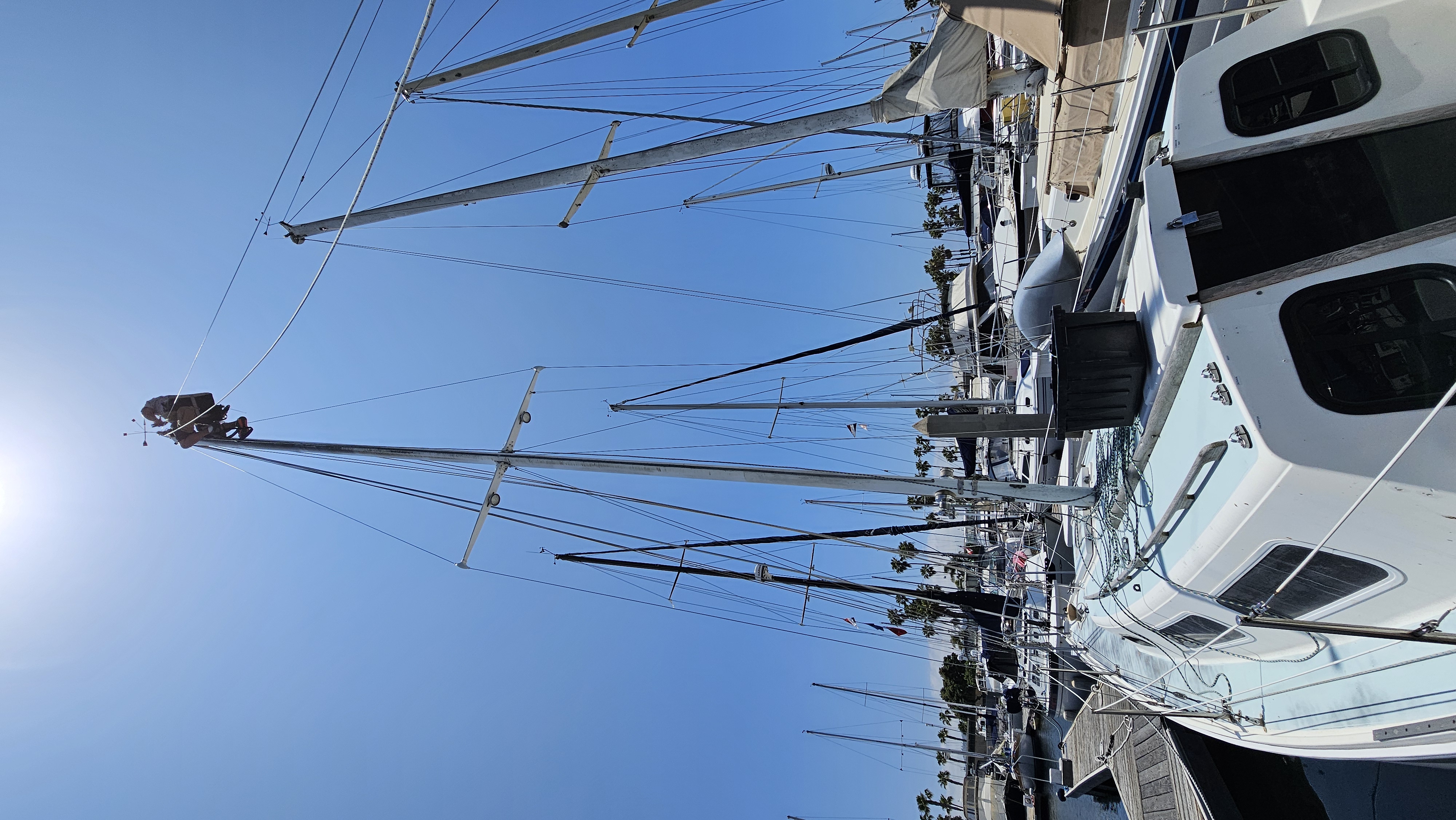

The next was he discovered the spreader tips had corroded away. So we needed to add new spreader tips.
Next, since he was working on the spreaders we needed to sand and paint them.
He needed to remove the spreader lights in order to do that, so the spreader lights needed to be rebuilt.

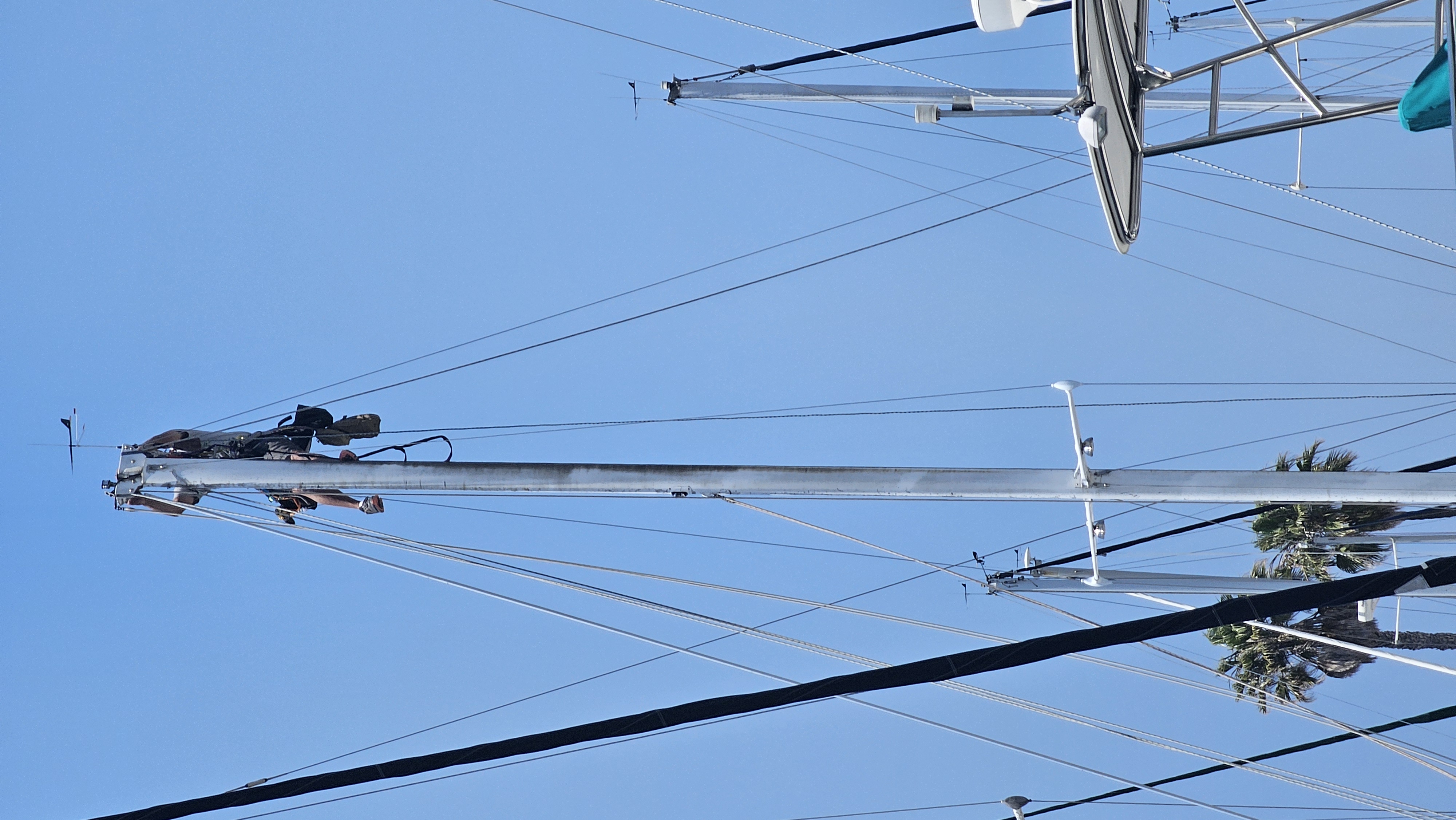

Once he started getting the wiring apart it was apparent that the steaming light was toast. So a new steaming light was added to the mix. While he was at the top of the mast he noticed that the base of the antenna was destroyed. So a new antenna and installation was added.
But that got in the way of the Windex so that needed to be replaced. He noticed the bulb was out in the anchor light so he went to replace that and the fitting fell apart. So a new anchor light.

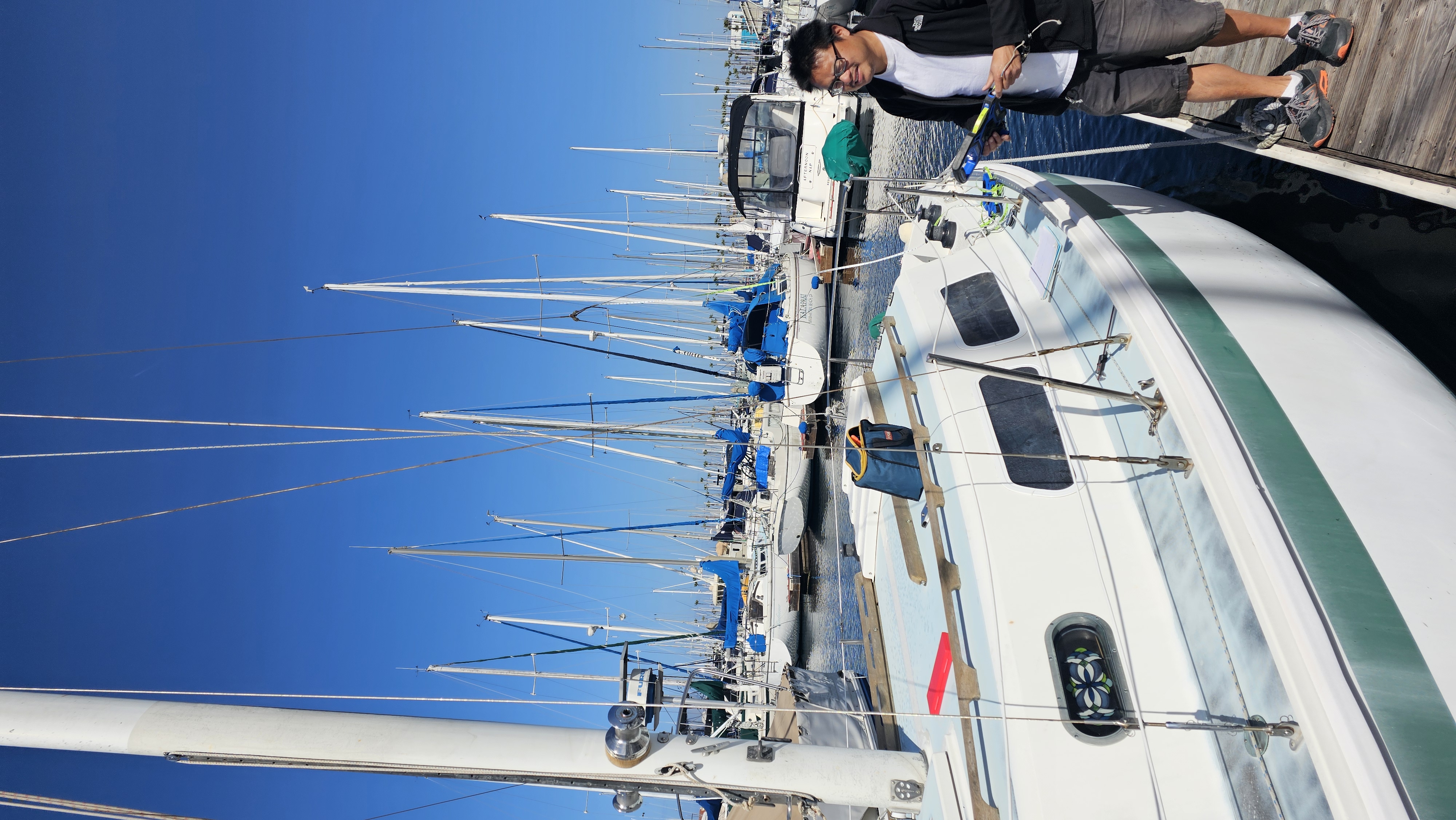

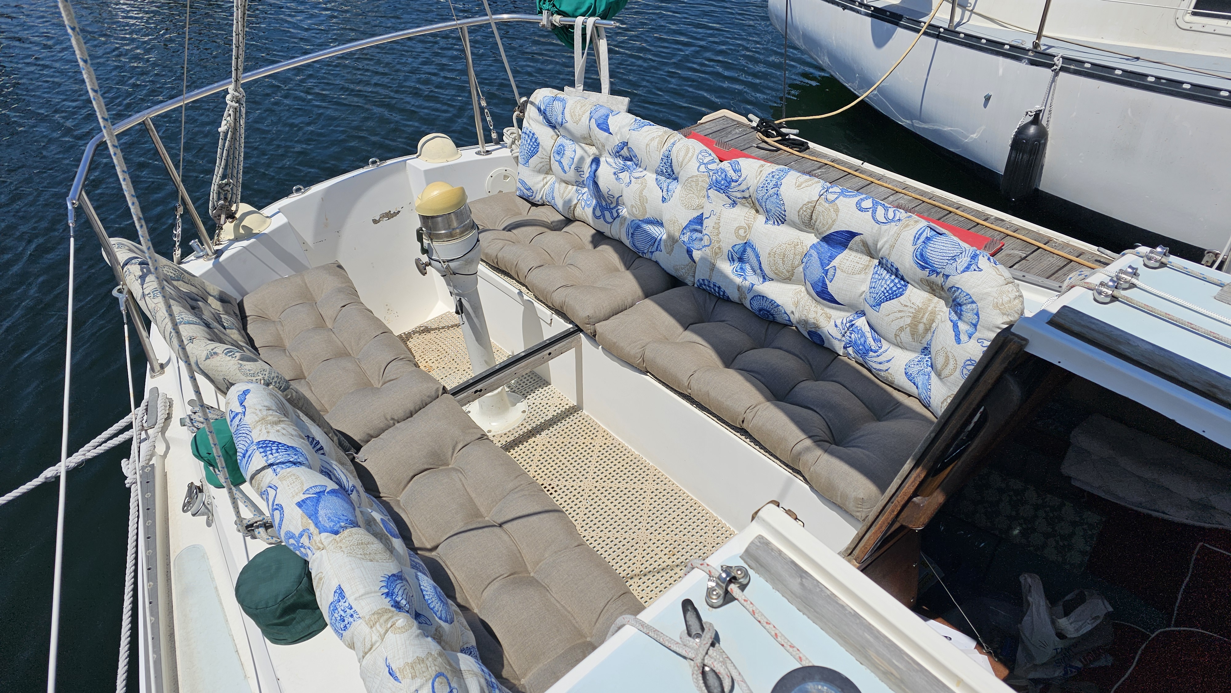

The lowers originally had been a lighter weight cable but for a small additional charge I could upgrade to the same size as the cap shrouds and backstay, so that made sense. He completed the task and it was beautiful. He did the initial tuning and we were ready to go. But the buying floodgates had opened. The mate insisted we replace our cockpit cushions.

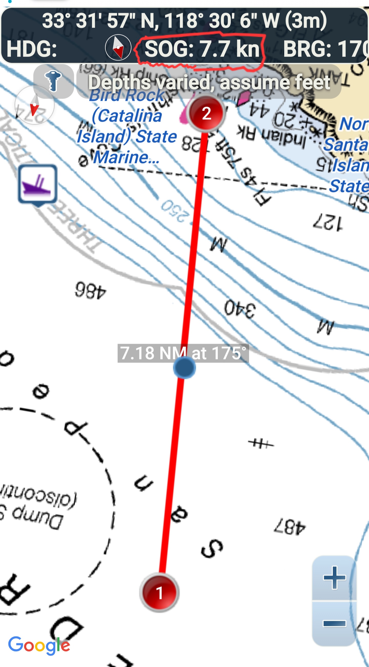

As is normal the wind keeps building as we get closer to the island. We are just off of beam reach and I have the sails set full.
With the flat seas are speed keeps building. As we get into the funneling effect near the island I'm reading 7.7 knots speed over ground.
Screenshot_20250812_155809_Marine Ways(1).jpg (514.54 KiB) Viewed 3031 times
Over a knot higher than calculated hull speed. We are flying!
