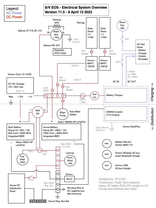

Very interesting. One question though. It looks like you have a 12V/12V converter. I have one as well to keep instrument voltage regulated. But it looks like the output is connected to the start battery output. That I don't understand.

Hi Allen: I too live in Palo Alto. In Barron Park! I’ll answer your question best I can and add some things that I went through, this isn’t particularly relevant to a Cal 34 but some may be interested. I still have to post my installation details and I’m working on it.
Allen said >> It looks like you have a 12V/12V converter. I have one as well to keep instrument voltage regulated. But it looks like the output is connected to the start battery output. That I don't understand.
1. Yes, I have a Victron non-isolated (though isolated would work too) Orion 12-12/30 12V to 12V at 30A battery-to-battery charger [1, 2, 3, 5]. There are a number of ways to handle charging both starter and main batteries and I just chose battery-to-battery charger. Lots of arguments about this issue, which battery to connect to the alternator, how to wire batteries and switch(es). I learned a lot about all this during my trip back from Hawaii when I had alternator & regulator problems, I may get into that on this thread, we’ll see.
2. I have had problems with my NMEA 2k instruments and spikes (particularly the Airmar DSTs built during COVID when they changed sourcing on a key power component due to supply chain issues - and now a well-known problem with these DSTs). Solution is to use something like an Victron Orion but you dont need 30A, you can use the 9A [6].
3. There were a few considerations for the battery-to-battery charger: (a) My Victron MultiPlus-Compact-2000-120V-EN only charges at 4A on the secondary charger. Thats not quite enough for me to charge the Relion 50Ah lithium starter. (b) I used to use a Sterling charger [4], Sterling makes great products, fantastic support from the designer in the UK but no short-circuit protection and I accidentally shorted it offshore and it was a nightmare. The Victron chargers are short-circuit protected. (I’ll come back to wiring and “what I learned about ABYC, what’s not in ABYC, how I screwed up, what I do now” in a later post if anyone is interested, it did affect my layout on my Cal 34).

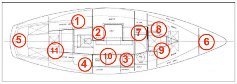

Here's some details of my Cal 2-34 installation. Not saying this is the best way to do things or even the best way for my boat. There are surely a few things I would do differently now.

Shown below.
1. Electrical panel is a standard Catalina. https://www.catalinadirect.com/shop-by- ... -x-19quot/ Everything electrical went over the custom chart table which was built in the port quarter berth. The quarter berth holds the fuel tank (moved from behind the engine to give better access), a Seaward water heater (never use it). All the VHF, AIS (x2, Class B and Class A), antenna splitter, MFD, emergency instrument power etc. is here to above the chart table. Victron battery monitor, fuel gauge, USB outlets. It’s very tight. I put thumbscrews on the panel so I can pull it out completely, easily and quickly.
2. The 50Ah and 300Ah Relion lithium batteries are in a locker under the bench settee. It’s a tight fit along with all the breakers and fuses. I dont think any other chemistry would fit. Some breakers (the windlass and alternator master disconnect are outside the locker and you have to follow ABYC for these). One practical piece of advice. I didn’t seal the ends of the platforms that hold the batteries level. I dropped a nut and it rolled under the platform. Cant get it out. It makes a really annoying noise offshore. Turns out thats a big deal when you are listening for chafe, mast pumping etc.
3. Fridge wiring was tricky. Have to feed it back, then across the engine compartment and all the way along the starboard side.
4. AC outlets at chart table, here at location 4, over the sink, in the forward cabin, under the bench settee. This location was the toughest.
5. All outside instruments goes on the bimini: satellite, Airmar WeatherStation, active radar reflector, GPS (x2), spare VHF, AIS antenna
6. Lewmar windlass 70A wiring threads all the way from aft along the port side in the various locker compartments. Nightmare.
7. Secondary instrument section around the Airmar DST. I have an Actisense terminator here so I can monitor the NMEA power injection.
8. Mast lights. Installing a separate Blue Sea switch box here saved me 6 breakers on the main electrical panel. The wood trim comes off fairly easily on my Cal 2-34.
9. Water pump for the two Nauta tanks under the forward better. Another nightmare route.
10. Electricals under the sink. There’s a Shurflo deck wash pump here.
11. Electricals in the engine bay. Balmar regulator and Sterling APD.

- Cal 2-34 EOS electrical layout.jpeg (67.92 KiB) Viewed 55412 times

Thanks for the clarification. Just amazing. Your boat looks wonderful. Looks like you are on dock 6. I am on dock 3. About the only thing our boats have in common is I have a 12V to 12V converter but now that you explain yours, they are not even in common. Thanks for the detailed explination.
