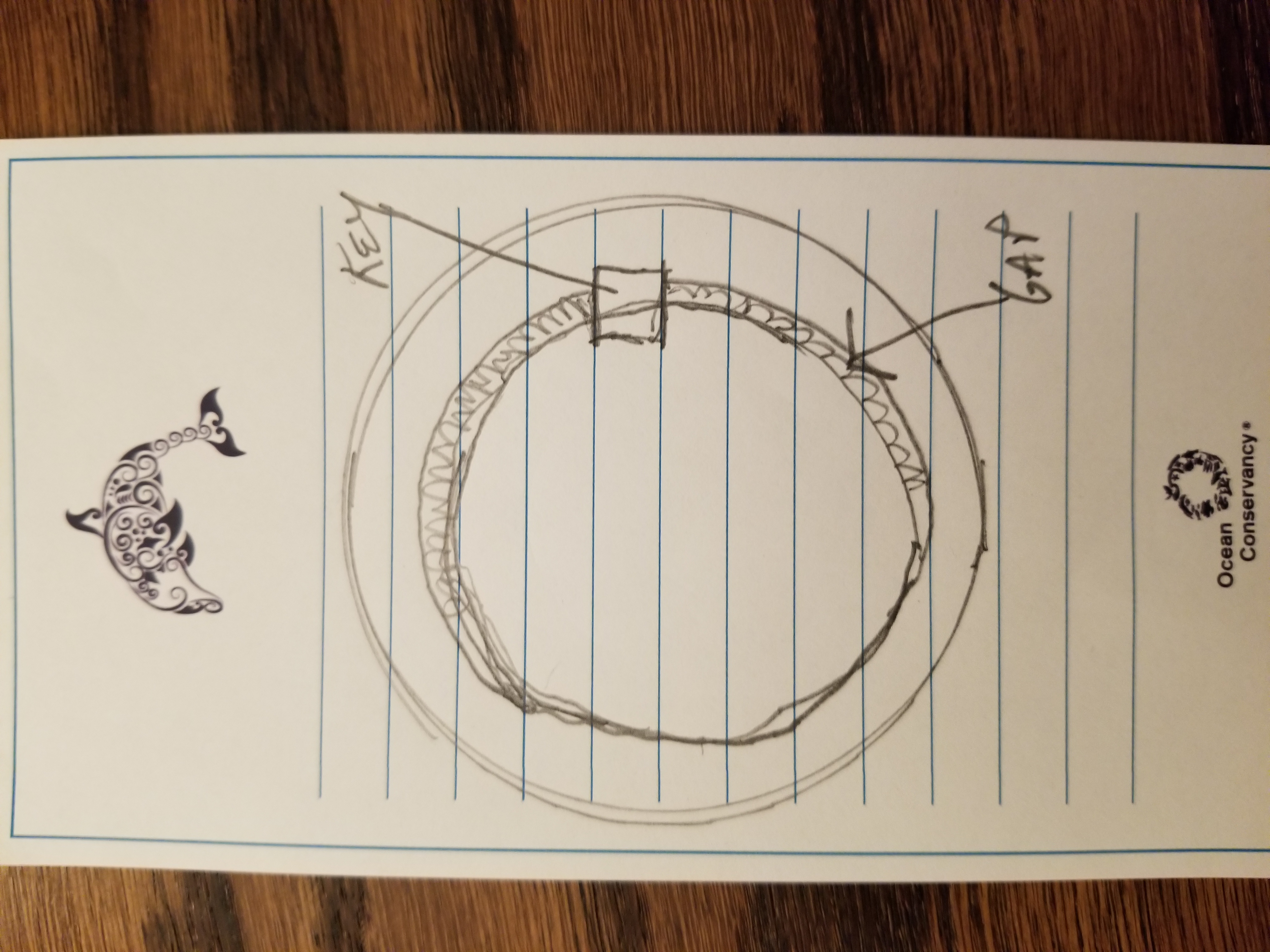

Hi Mary just a thought. If your mechanic needed to rekey the shaft sometimes that can put it off center especially if the hub was worn. It did not appear from the video that the shaft is bent just that it's origin is off center. Just a little sketch that's extremely exaggerated to show what I mean.
if this is the case no amount of alignment can solve the problem. I would check the hub and the prop shaft first to make sure that that this isn't the problem before trying to make any adjustments to the position of the engine or v drive. If it is the problem it can be shimmed with a sleeve before you consider replacing the prop shaft.

rcvesselstyn wrote: Wed Mar 09, 2022 6:34 pm Hi Mary just a thought. If your mechanic needed to rekey the shaft sometimes that can put it off center especially if the hub was worn. It did not appear from the video that the shaft is bent just that it's origin is off center. Just a little sketch that's extremely exaggerated to show what I mean. 20220309_181803.jpg if this is the case no amount of alignment can solve the problem. I would check the hub and the prop shaft first to make sure that that this isn't the problem before trying to make any adjustments to the position of the engine or v drive. If it is the problem it can be shimmed with a sleeve before you consider replacing the prop shaft.
That's what I'm thinking, also. If the shaft was aligned before and the key was added, this makes the most sense to me.. at least as a first thing to try. Its difficult to see, though. The mechanic says the shaft is worn.
