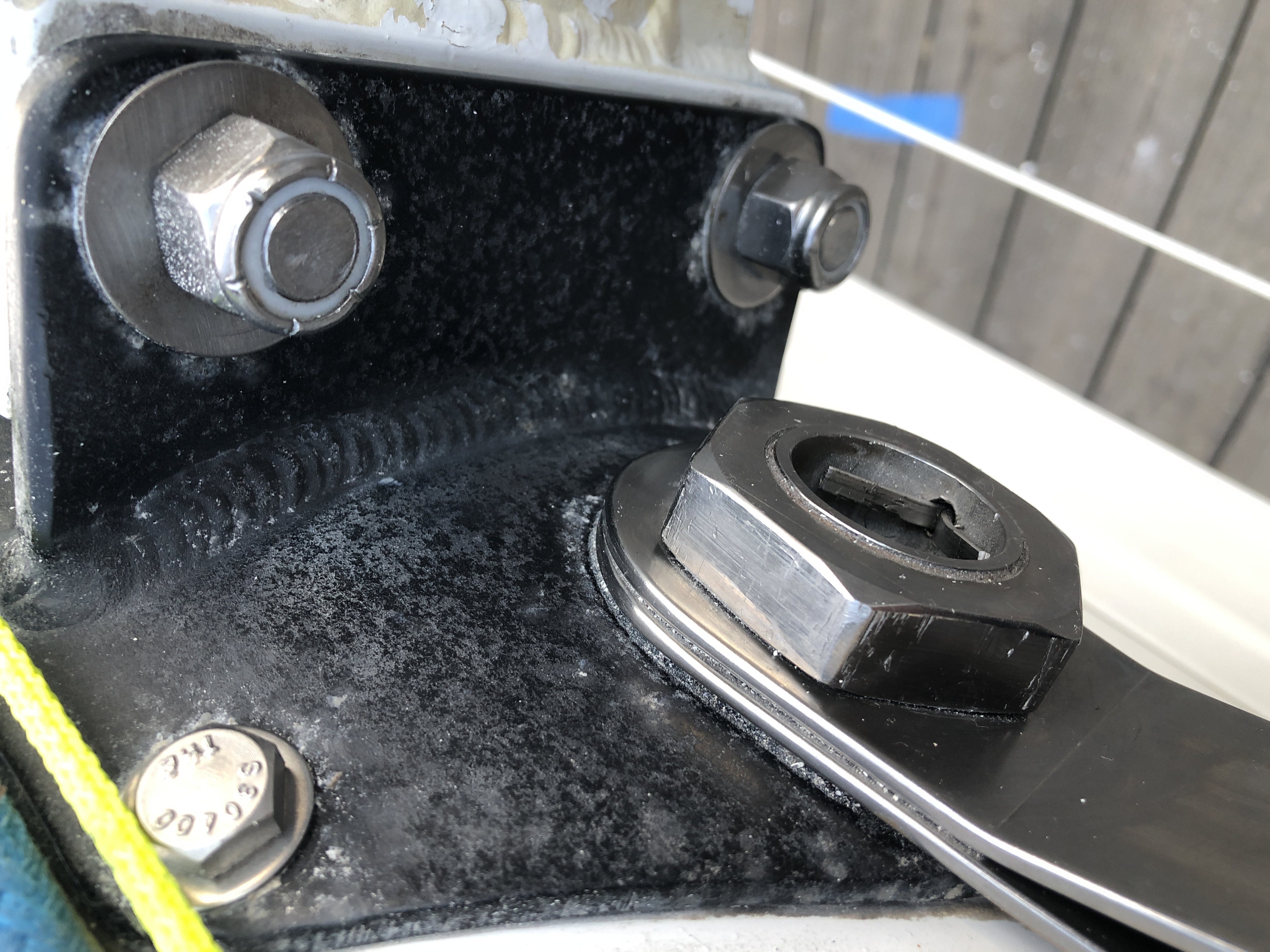

>> How difficult is it to remove the aluminum spreaders?
Here are my 2-34 spreaders. No idea if they are original. Two bolts to remove on each side, look like 3/8". You are looking at them here and the Schaefer shroud tangs plus the through-mast dowel with its 1+" nut is below. I checked and there is clear space between spreader and mast so they come straight out. I honestly don't think these spreaders would take very long to remove because even if one is wedged in, you can use the tough spreader as a long lever arm to get it out.

Mary>> How difficult is it to remove the aluminum spreaders?
I forgot to add:
Mine are aluminum. Welded. Somewhere you also asked if they were hollow and mine are. They have a small, about 3/16", hole drilled near the bracket on the underside to drain, though they look pretty much sealed. Somewhere you also asked about pitting and corrosion. Mine are painted. A bit better paint and different from my mast. Looks like typical pale yellow zinc-based barrier and then several coats of what feels like 2-part brilliant white epoxy finish because it's really tough, much tougher than my mast paint. There is some wear at the spreader ends. There is wear at one end, the tips, due to shrouds. There is wear at the other end as the "bars" that end the spreaders bears against the brackets under load. But nothing to worry about. Not much corrosion and nothing that rises to the level of pitting. The spreaders, brackets, definitely the tangs and hardware look way newer than the mast and its other fittings (like the rivets for the mast wiring conduit for example) and it could be that a lot of mast hardware, possibly including the spreaders, was replaced at some point. If I look at the level of wear on the "new" mast parts it is about the same as on all the boom fittings on the mast (gooseneck etc), so my guess would be it was all replaced at the time the boom was fitted around 2015 or so. I didn't worry at all about looks, I wasn't going to strip and re-paint the mast, that would have cost a fortune not least because of the environmental and OSHA stuff. My mast now looks like what Tom calls camouflage, mostly white with some yellow and some bare aluminum. My guess in a few years it will be mostly bare aluminum !
