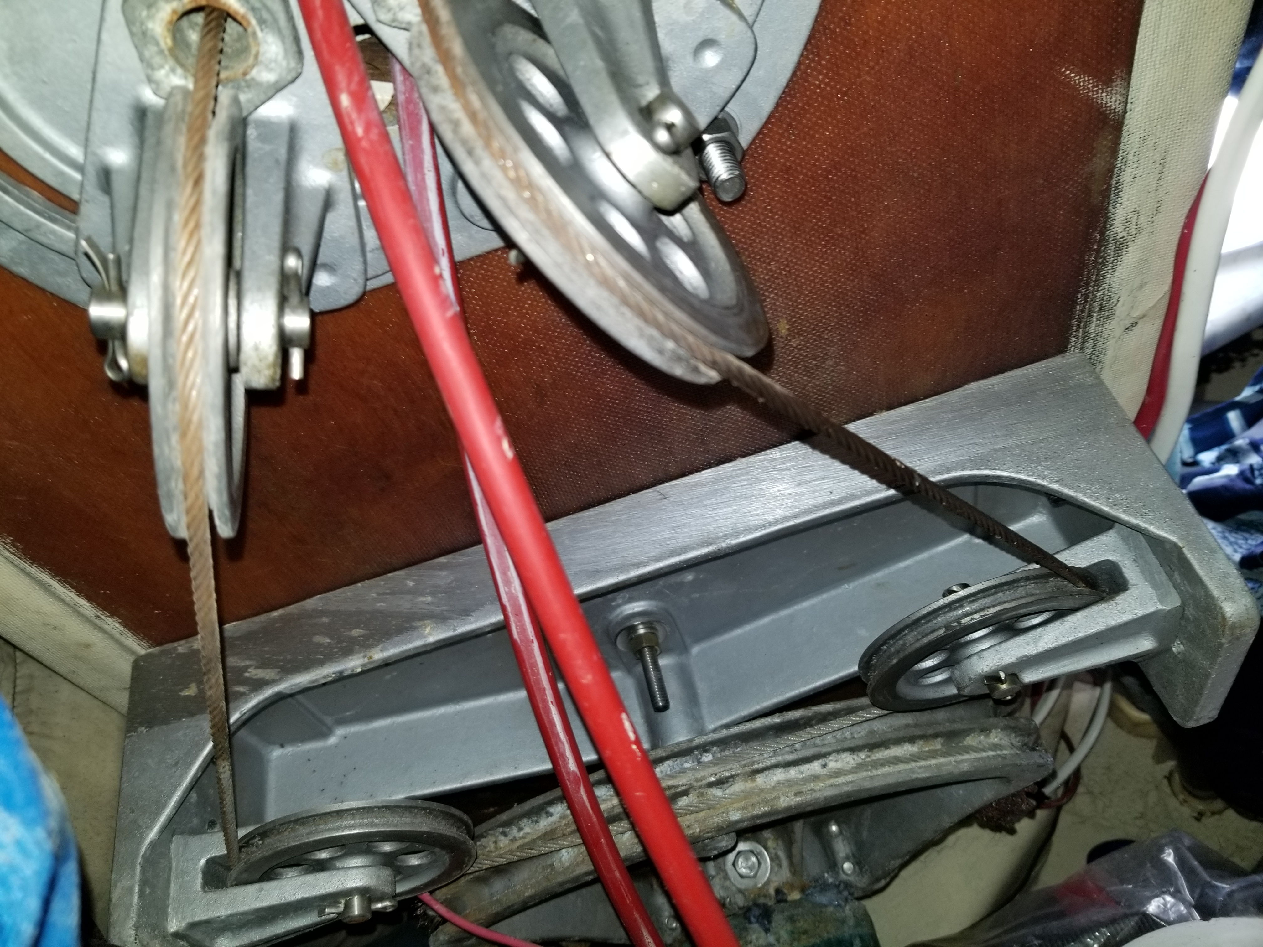

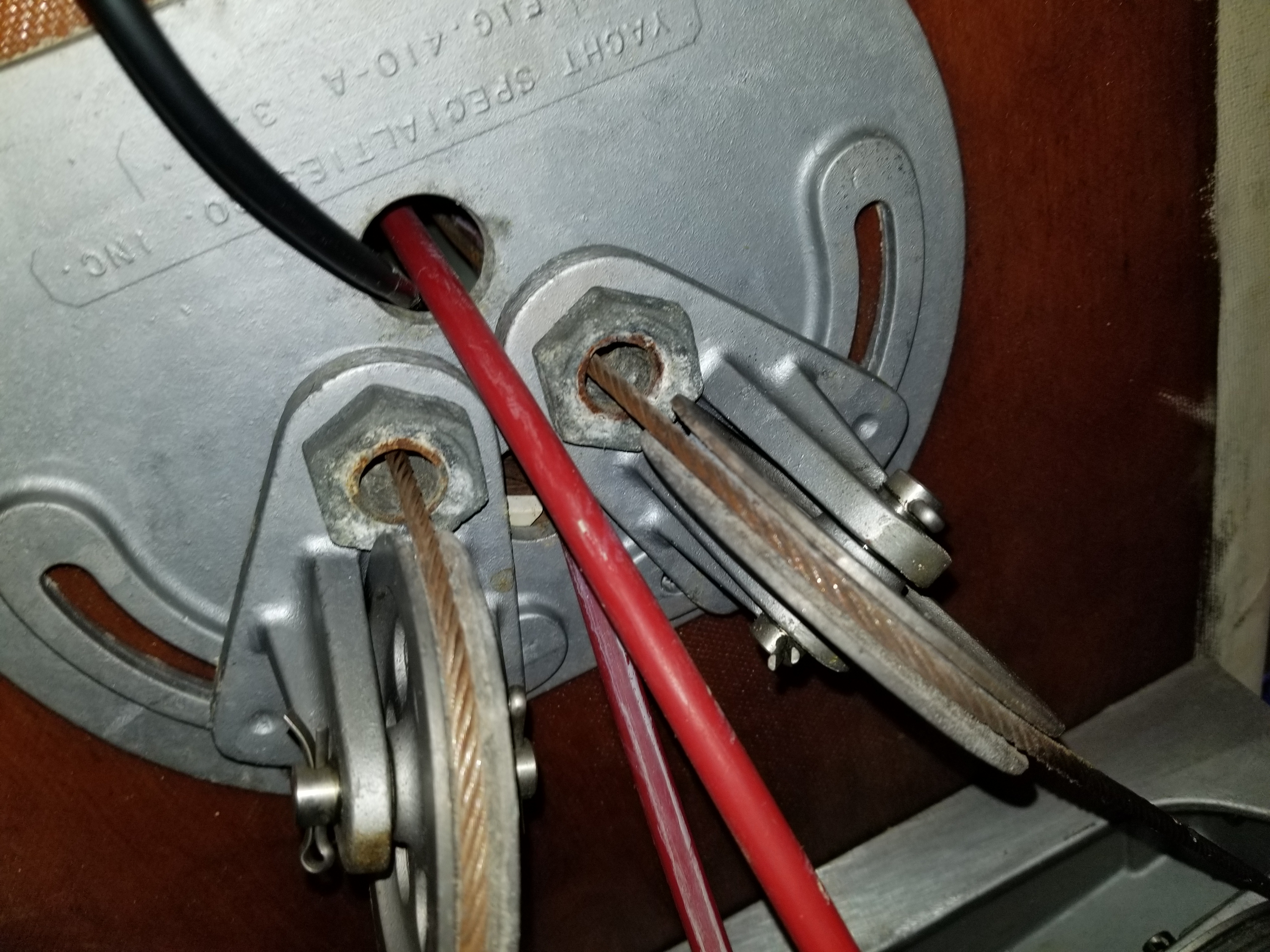

Hi Matt. I will take a couple of shots of how my Cal 2-29 is rigged up. It's very similar but no conduit. I'll be going down to the boat after this storm passes just to make sure everything is okay and I'll stick my head in the lazarette and get you a couple of pictures. It will probably be a couple of days cause the storm won't be over till Friday and then we've got New Year's, but I'll post them when I get them.

Thanks very much - this is very helpful to see. Thanks for the pictures!
