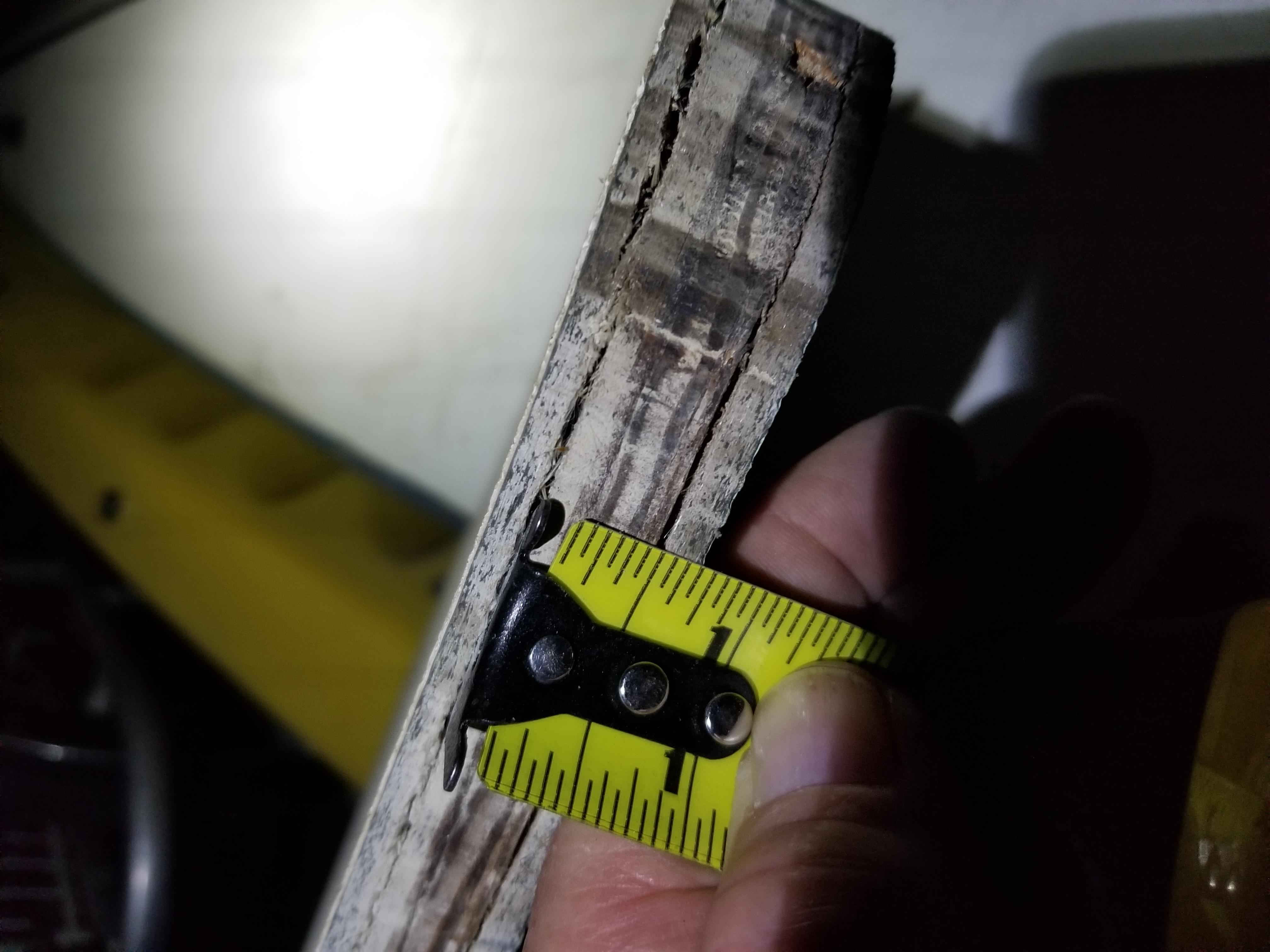

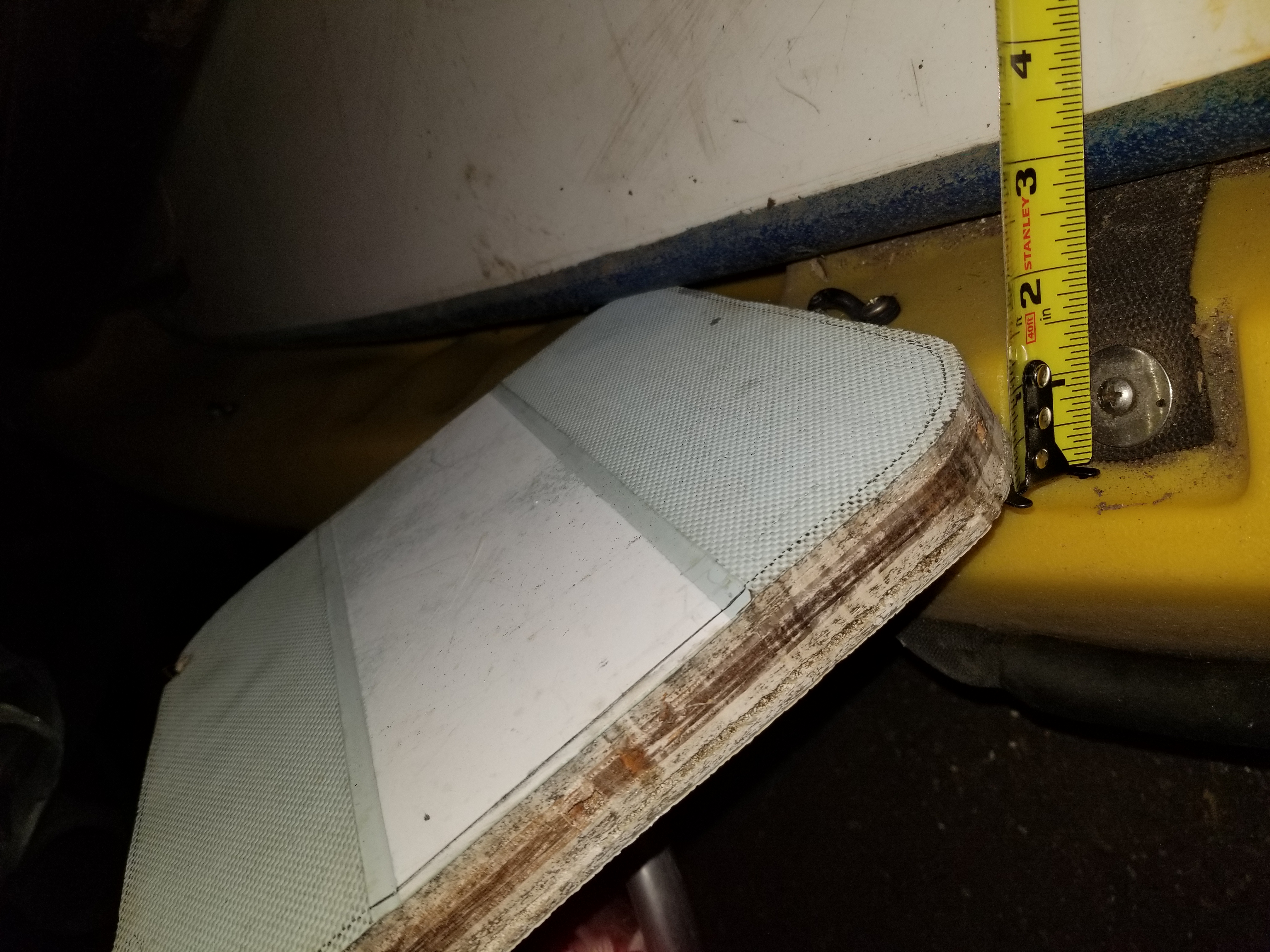

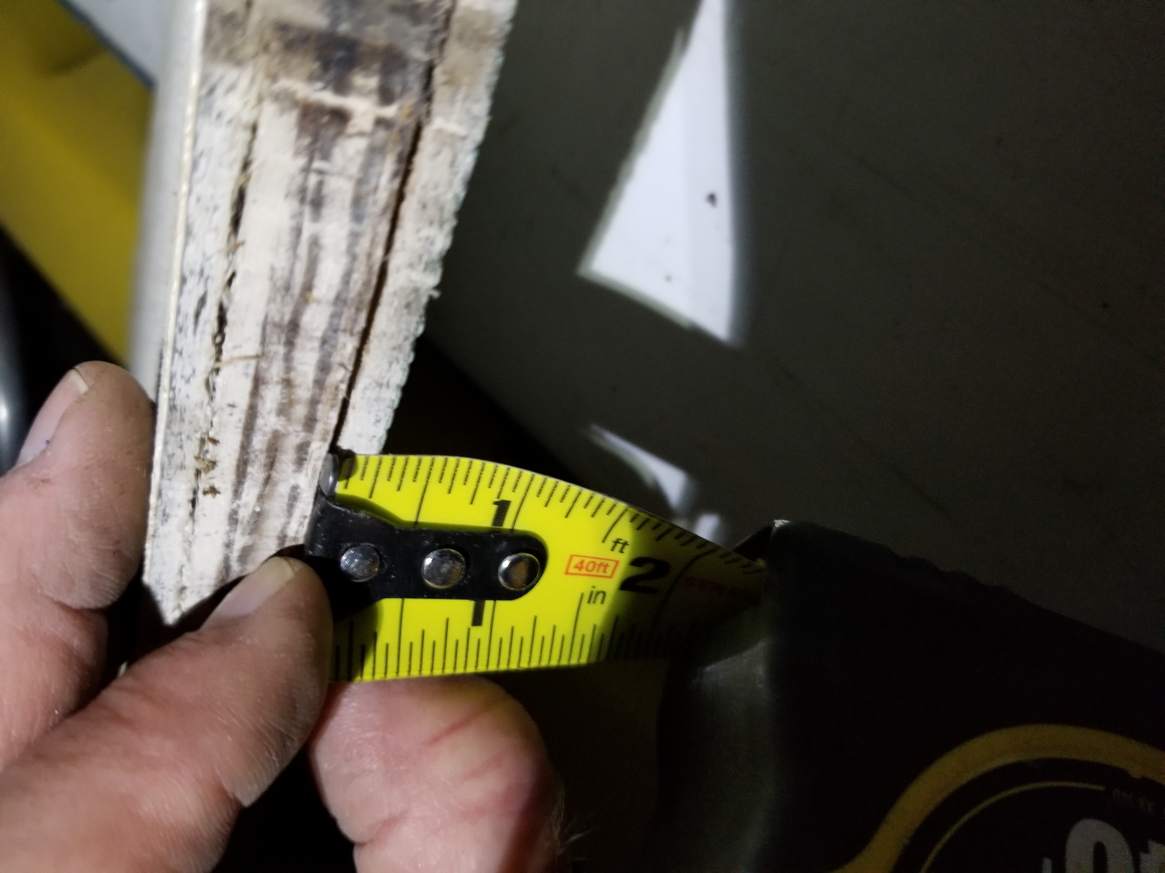

I had the boat checked out today by a guy who does fiberglass work to price fixing the little cracks in teh deck where it beat the dock last year in a storm. he priced it about where I expected, but he told me the deck core is soft up front. Not fatal yet, but soft, real soft. I know the hull is solid, and maybe some flex should be expected for a 50 year old boat, but investing thousands of dollars in redoing the deck just isnt going to happen. he knows a guy that tkes old boats like this for parts, salvages what he can from it, mast, rails, engine, all the good stuff, and does away with the rest. how scared should I be of the soft deck up front in front of the forward hatch? My beam of death is in good shape. I'm considering cutting my losses at this point and buying a better boat once i sell my house.
1969 CAL 29
Go with your gut. The more time and effort you invest in a boat the harder it is to part with her. However concerning your foredeck
This is a shot of it's construction. You have about a quarter of an inch of hand laid fiberglass and then 3/4 of an inch of marine plywood and then a layer of fiberglass on the interior. My boat is a later 2 29 in has a quarter inch fiberglass liner in the entire forward section of the boat
The flexing will not kill your boat. It is extremely sturdy. If you're planning on challenging the North Sea in a Gale then I think you should fix it. Otherwise I would live with it until you had the opportunity to peel off the inner plywood and fiberglass and replace it with a fresh sheet of 3/4 inch marine plywood and a single layer of fiberglass roving. Unlike a lot of the older sailboats out there these Cals were heavily built and sail well. But as I said before, you've gotta go with your gut. A sailboat is an emotional relationship not a practical one.
