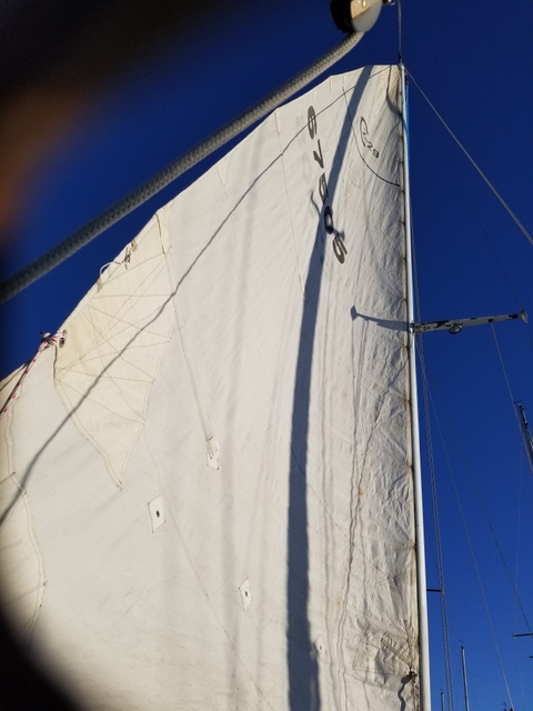

Our mainsail was first hoisted in 1982. We have had a fair amount of work done on it over the years. Due to its baggy state with any breeze over 7 knots the boat sailed more efficiently with the main reefed. We decided for its 40th birthday to put it into retirement.

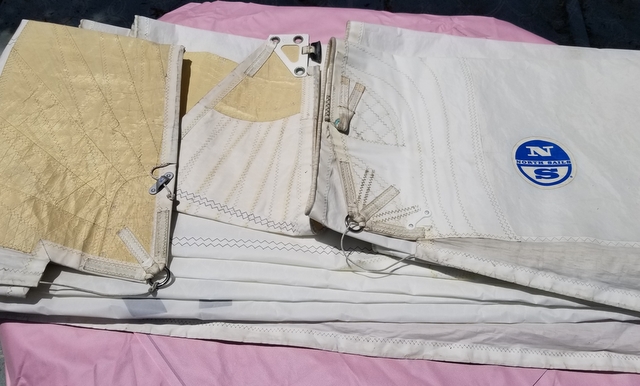

This is going to be great!... This is going to be expensive! The brakes came on. The CFO determined it wasn't going to happen. We could maybe do 25% of a new sail. So I did a quick check of Minnie's inventory and they had a few mains that were within our measurement range. Thankfully Etchells have close to the same mainsail measurements as our Cal 2 29. That means the last season Etchells race sails are possibly new sails for us. These sails were cut for a boat that's 4000 pounds lighter. That means they will be flatter, but flatter is what I'm looking for. So I got to spend Saturday morning in Costa Mesa going through Minnie's inventory. I found a stiff Dacron 9.5 oz. North with Kevlar reinforcement. It had seen little use one season. It met our criteria except no reef and it had a bolt rope for a slotted mast instead of slides.
Minnies said they'd knock a $100 off the price and throw in some sunburned battens. Sold! Now to set it up for our boat.

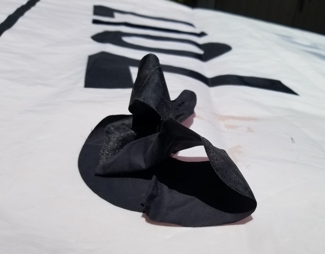

The first item was to remove the old numbers. Simple enough, just peel them off.

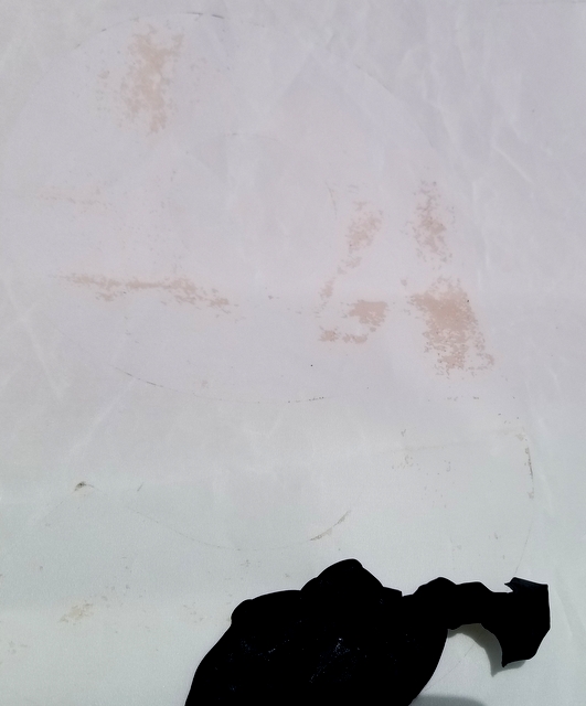

Aakk, what about all that sticky residue?

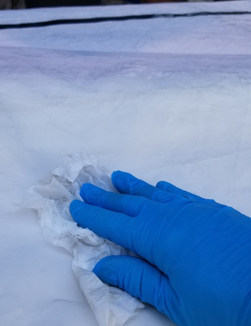

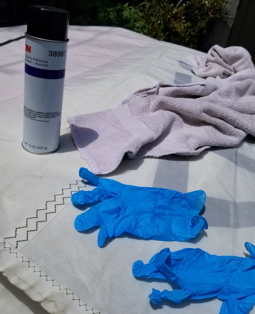

The best way to remove the residue is to use a dry terrycloth towel to rub off the thick stuff. then use 3M adhesive remover 38987, spraying it on a fresh towel. Remember whatever you don't remove with the first towel will turn to a gooey mess with the adhesive remover.
Once you have removed the residue you should wipe the area with a damp towel. When it has dried rub a Kleenex across the area to check for any residual stickiness as this will catch dirt and turn yellowish. It is more time consuming but I advise you work on one number at a time because it is very easy to lose track of the sticky area.

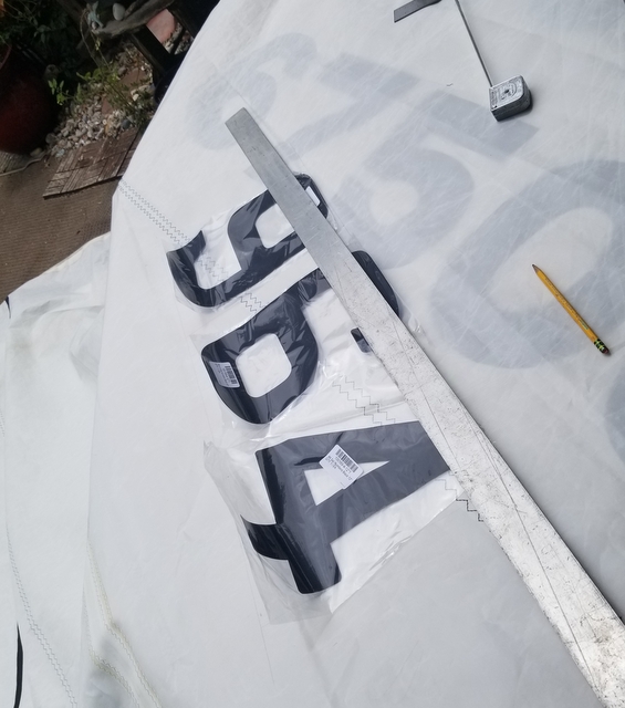

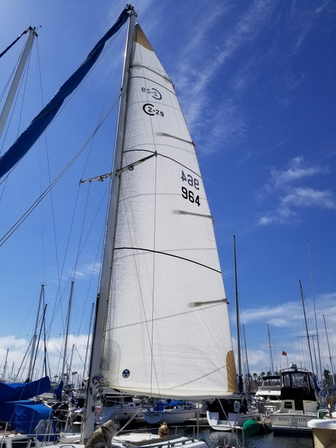

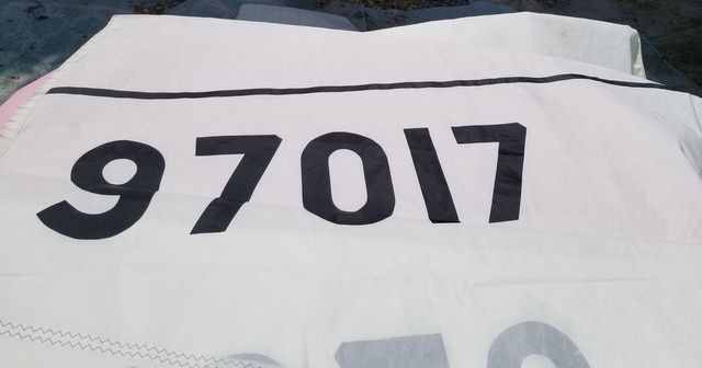

Now to put on our numbers and our insignia. Sailrite to the rescue with pre-cut and sticky back numbers.

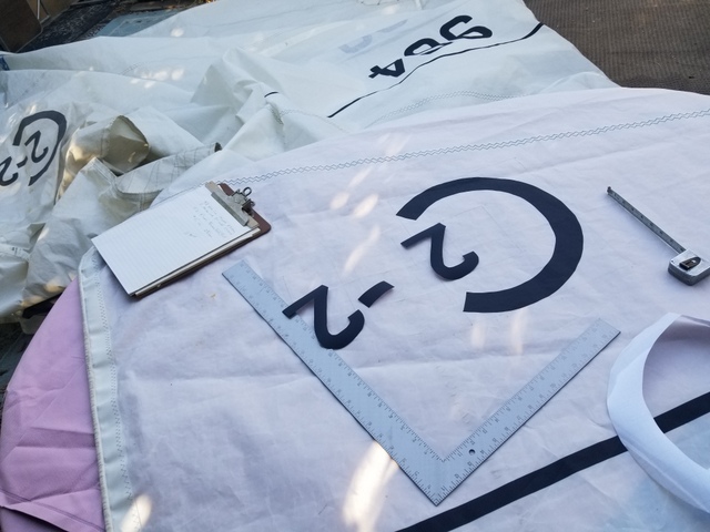

Take the time to make accurate measurements and mark the sail with pencil. I have seen many lofts just run a single line and mark the spacing. This has not worked for me. I make a box for each element. It guarantees everything is straight and spaced uniformly.

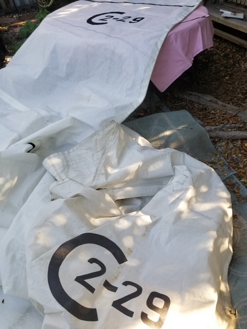

The insignia is another matter. Bulk sheets of pre-glued material are available through Sailrite. We made a pattern using baking parchment paper. We cut these out and then traced it onto the back of the fabric. Then we cut the fabric. I say we, but I mean the mate. I never could color inside the lines.
We used the same technique of marking boxes for each element.

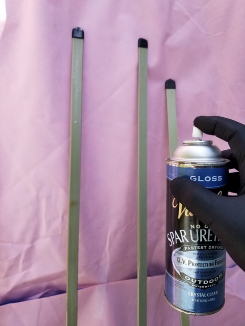

Next was to tackle the sunburned battens. They required gloves to handle because after sitting in the sun they were raw fiberglass. A quick spray of uv protectant urethane and they were like new.

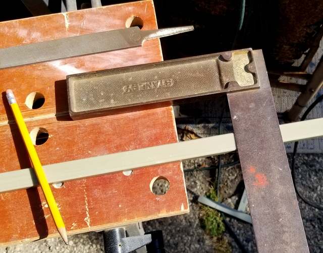

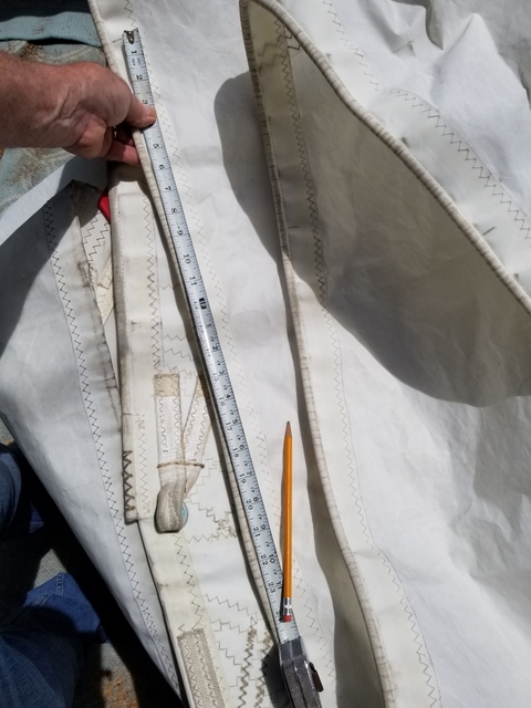

We needed to adjust their length. Each one was about a foot too long. Marking the batten while holding it in at the right tension was easy with two of us.
With a easy cut with the saber saw and a little filing of the edges they were done.

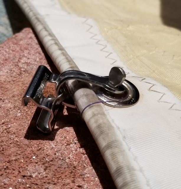

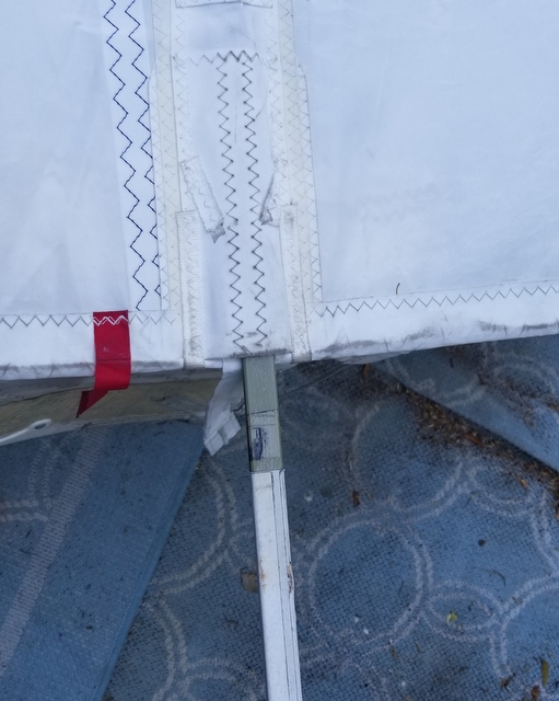

Lastly changing from bolt rope to slides. Sailrite has a good video on the process. First we had to measure and mark the locations for the grommets.

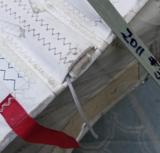

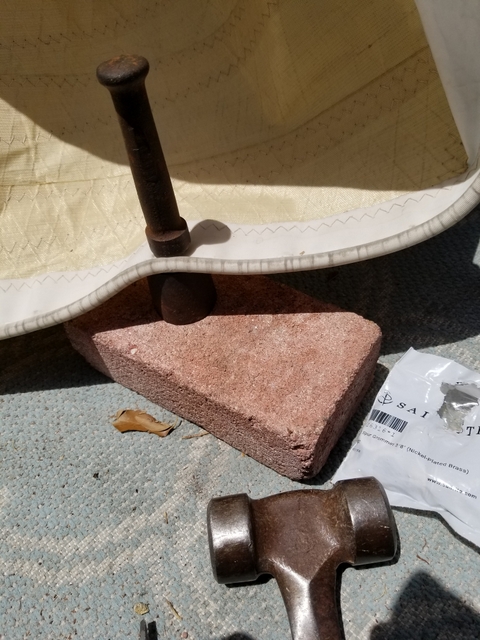

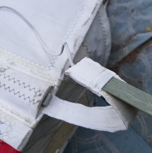

The full batten has a box that requires using webbing instead of a grommet and shackle so that needed to be taken into account when measuring. After measuring and marking we used a inverted grommet as a guide to punch the holes.

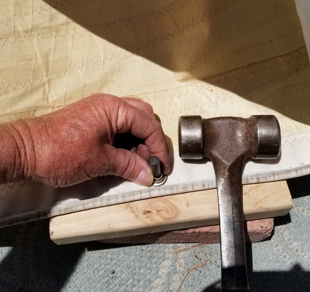

Then using the proper tool we seated the grommets.
We had to buy new slides from Sailrite because the old style we had on our previous sail wouldn't accommodate the shackle. When my daughter worked for a loft I was surprised that even they bought supplies from them. Adding the slide, plastic protector and shackle was simple.

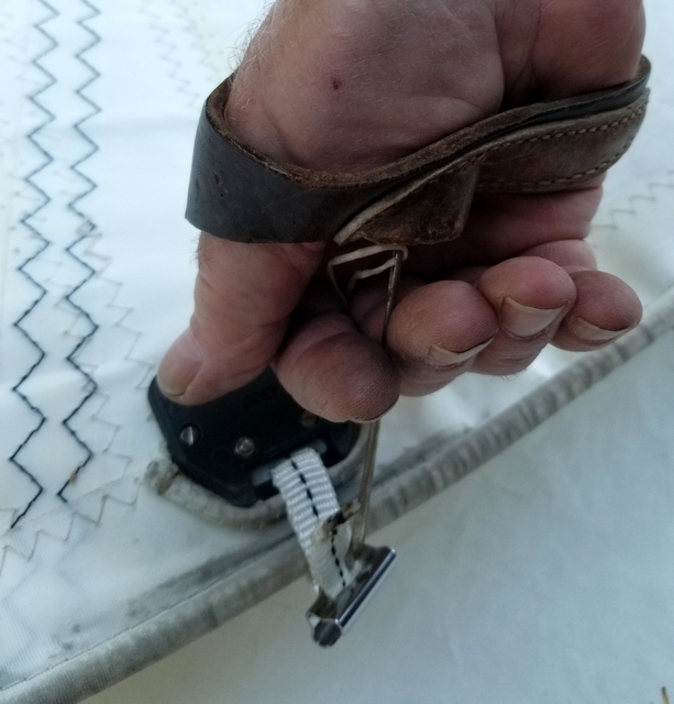

I stitched the webbing on the batten box with waxed twine using a palm, only took a few minutes.

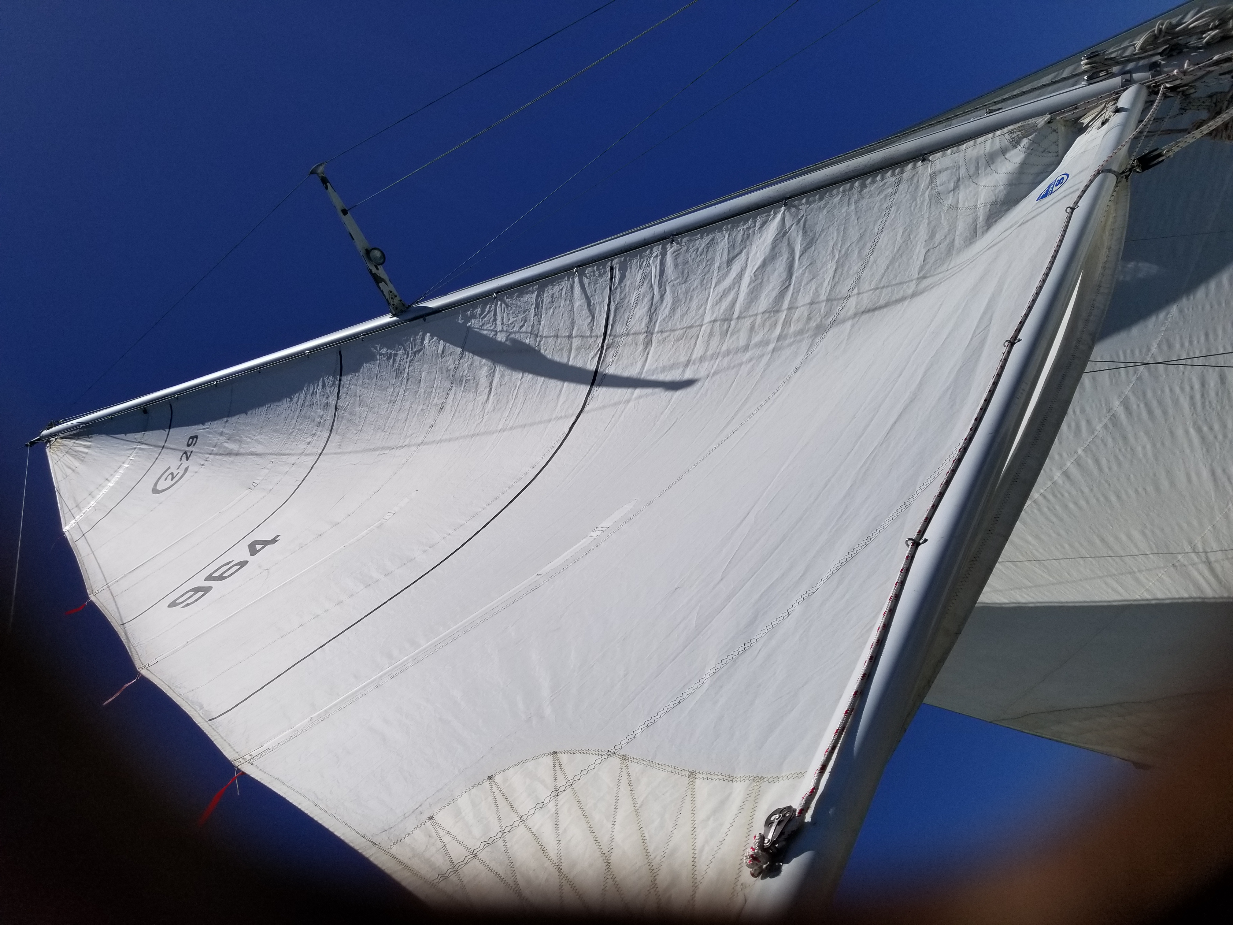

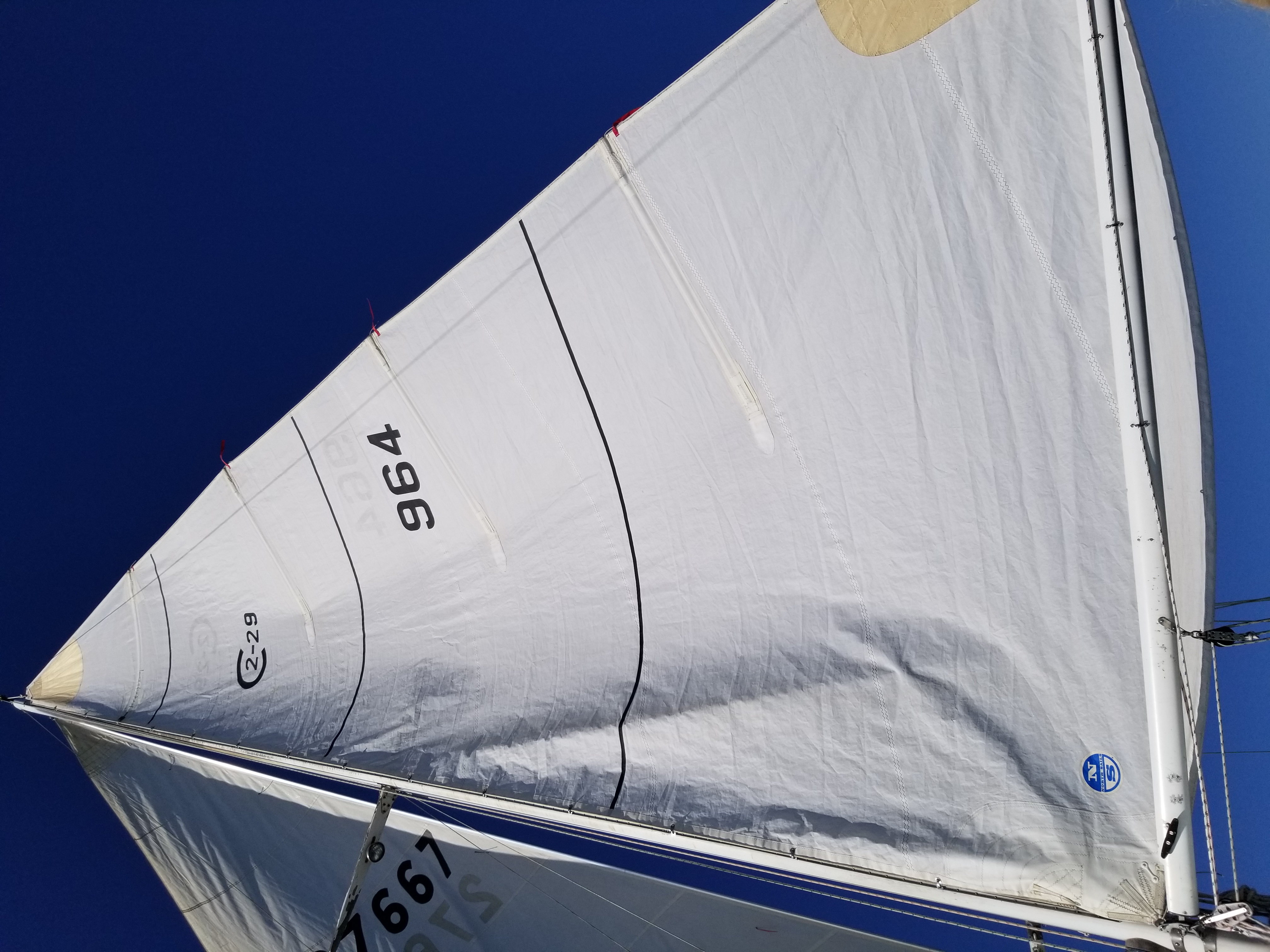

Finally I transferred the clew slug from the old sail to the new clew. We were ready to hoist our " new " sail!
Wow, it looks great! How does it perform compared to your old sail?

Thanks Chris and Mary. We haven't had a chance to try it out yet. We got it raised on late Sunday afternoon and then found that I'll have to re rig the outhaul. Out of all the old blocks that I have I couldn't find any that would do the job. So I've jury rigged it for this weekend and we are waiting for some new Harkens to be delivered.

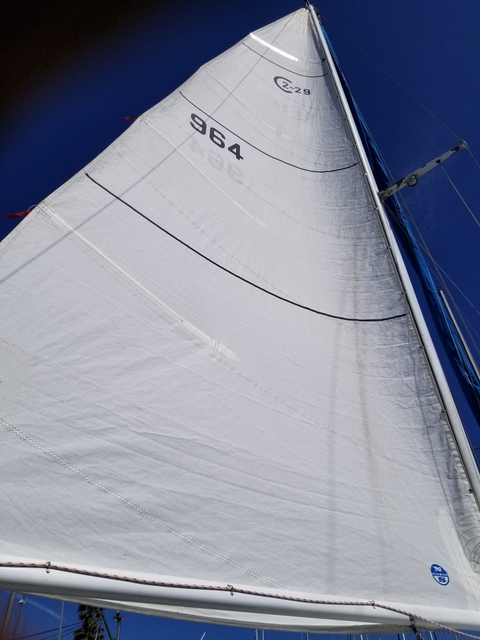

I look forward to the performance review. The shape looks really good. I'd expect a lot more forward motion and a lot less heeling. Sometimes it's shocking how much bad sails make sailing unpleasant and how much good sails make it a joy.
Trying to get the most out of a boat with old sails is an entertaining challenge. I've probably learned more tweaking an old sail for maximum performance then I have with a crisp fresh sail. Even with all the adjusting eventually the old sail exposes its limitations with the heavy weather helm and poor performance on the wind. When every trick has been tried there is that slow realization the only a newer sail will take the performance to the next level. Still trying to solve the problems of a old sail is a education. I can hardly wait to learn this new sail's personality.
We got a chance to try out the new sail today. The wind was blowing 7 to 12 with an average of 10 knots. We flew. With the old sail we would be struggling in the gusts but with this sail we just went faster. I was in heaven. The mate with saying it was so nice not to have me griping about the baggy sail.
