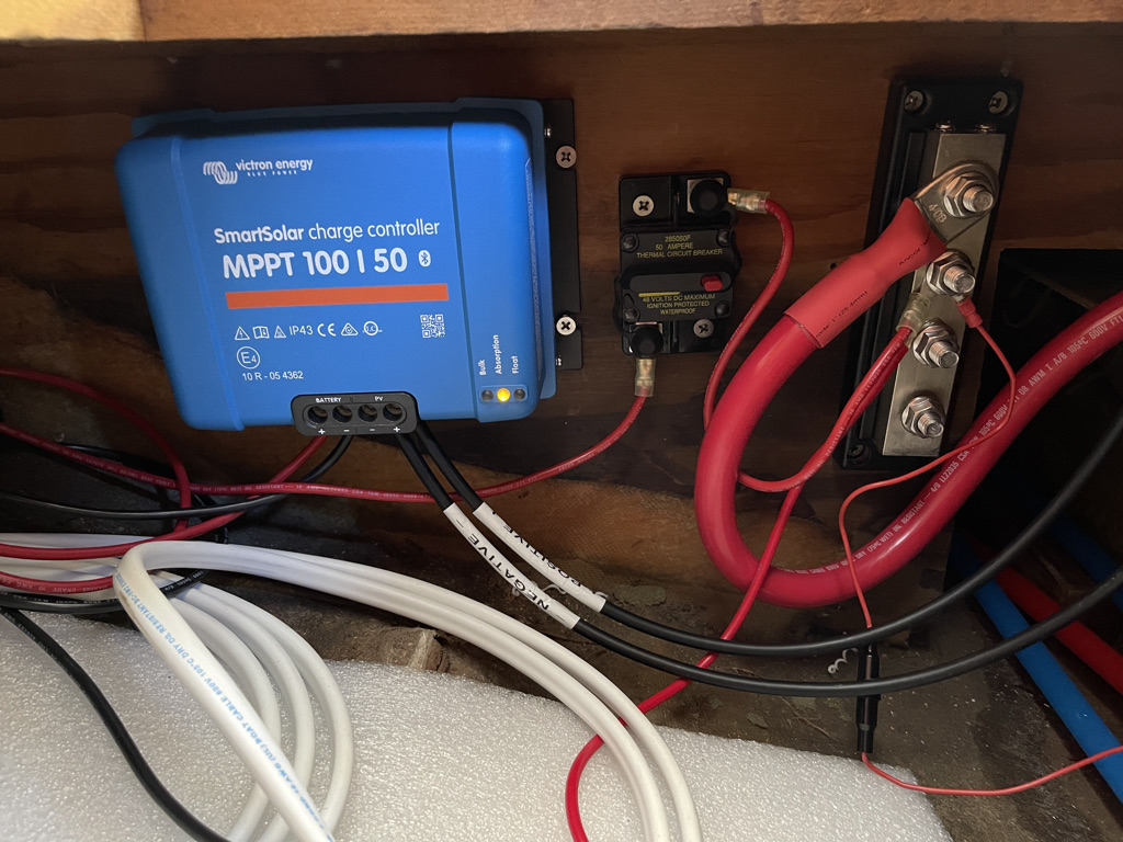

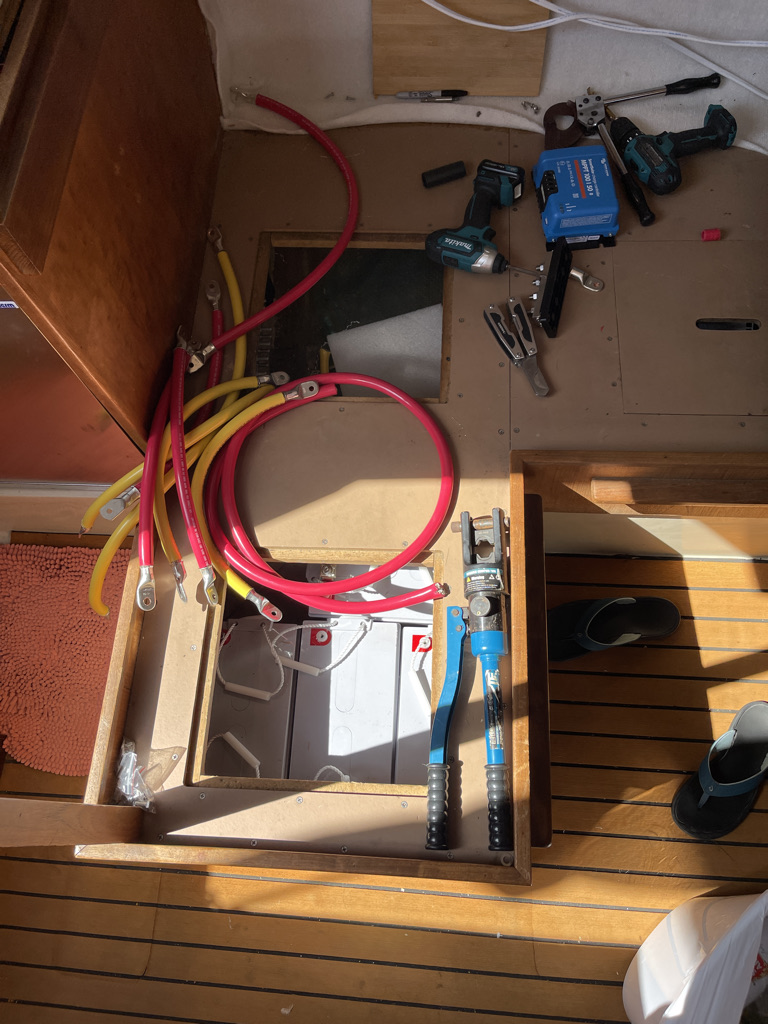

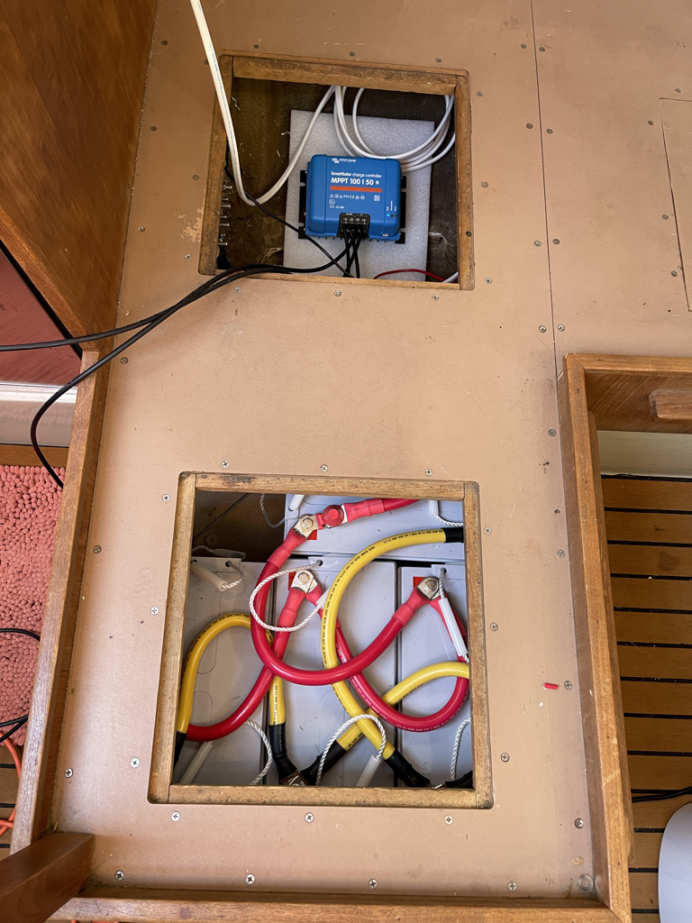

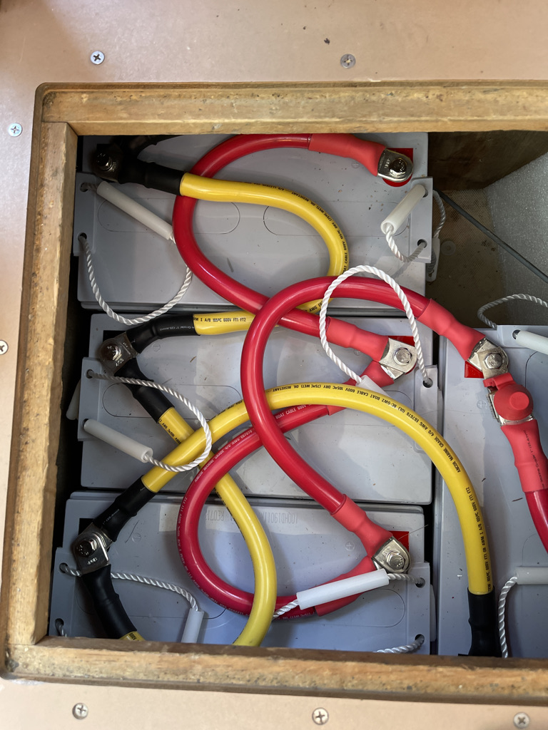

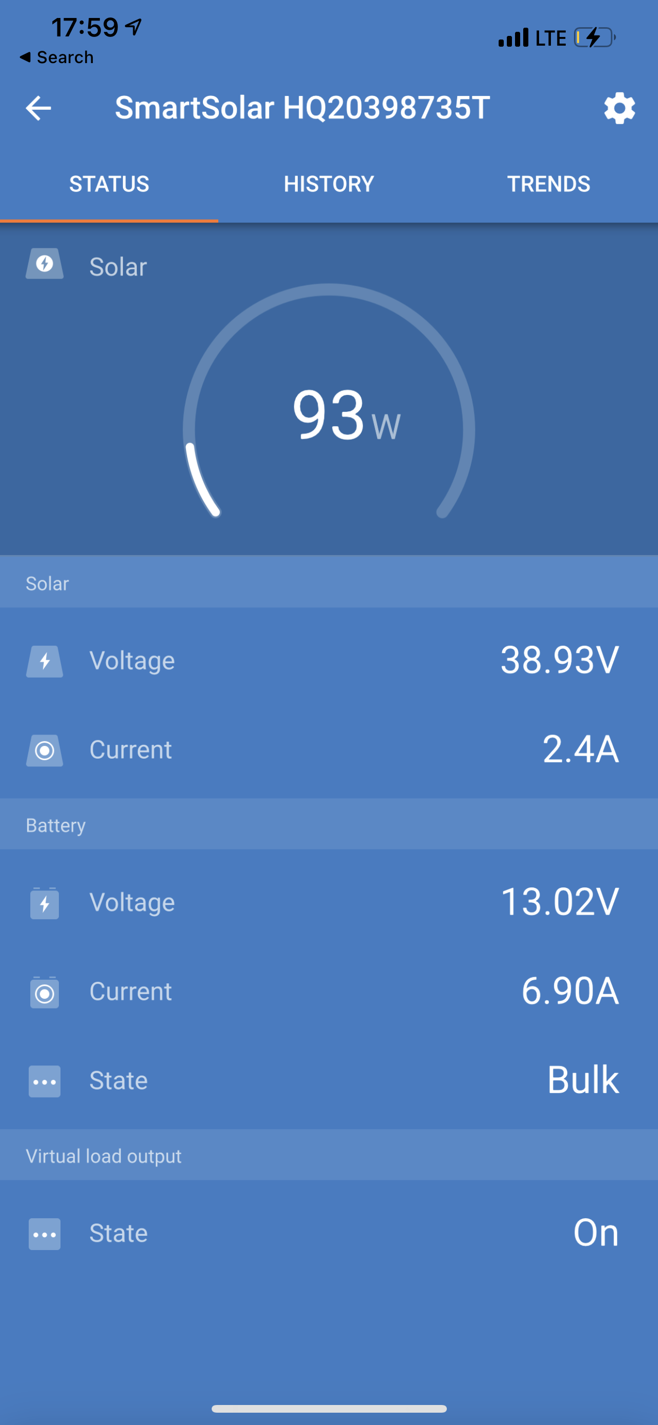

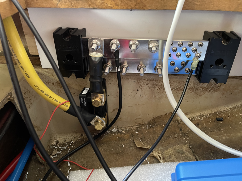

So far, I have installed a 400Ah AGM house battery bank (fits perfectly in this box!!) 100/50 Victron MPPT charge controller, Victron Smart Shunt and 2 175w Renogy flexible solar panels.
Still have to boot the battery terminals, secure the batteries, connect the inverter/charger, add battery temp monitor wire to the shunt, tidy up the wiring, run the solar panel wires through glands through the deck and re-wire everything else including the new breaker panel. I'm putting a Blue Sea SI-ACR between the start and house banks.

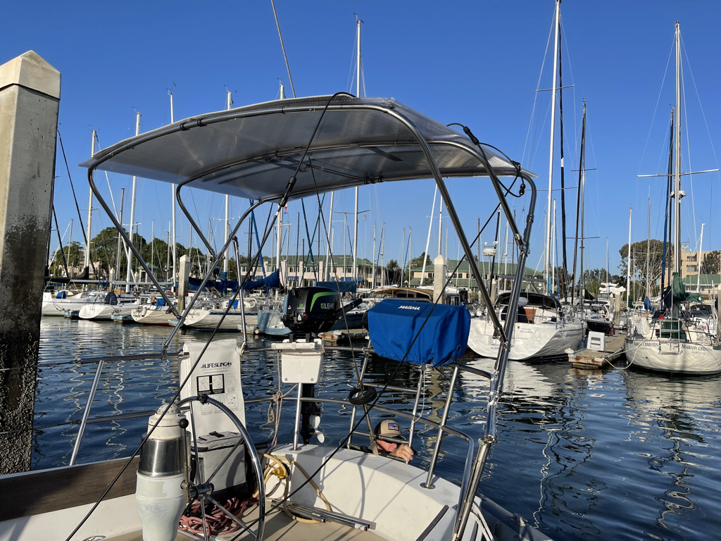

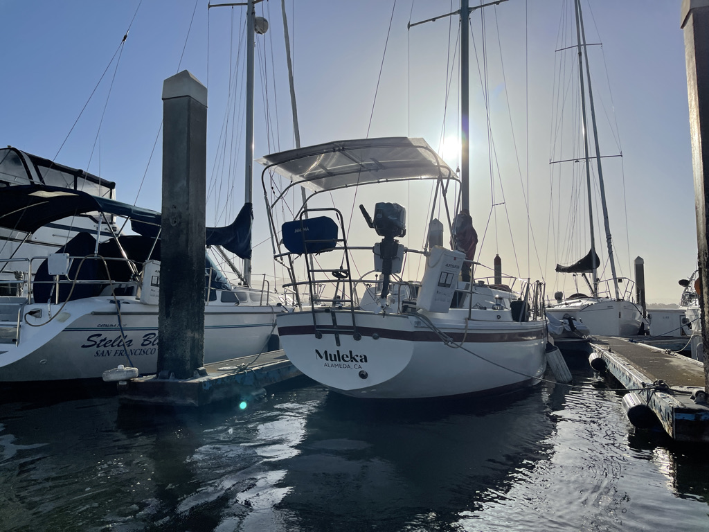

I built a 3 bow bimini to hold the panels, and they are supported by twinwall polycarbonate so they do not flex. She sails great with the bimini, and it is a nice amount of shade. I can still see the top of the mast from the helm and stand on the cockpit seat.

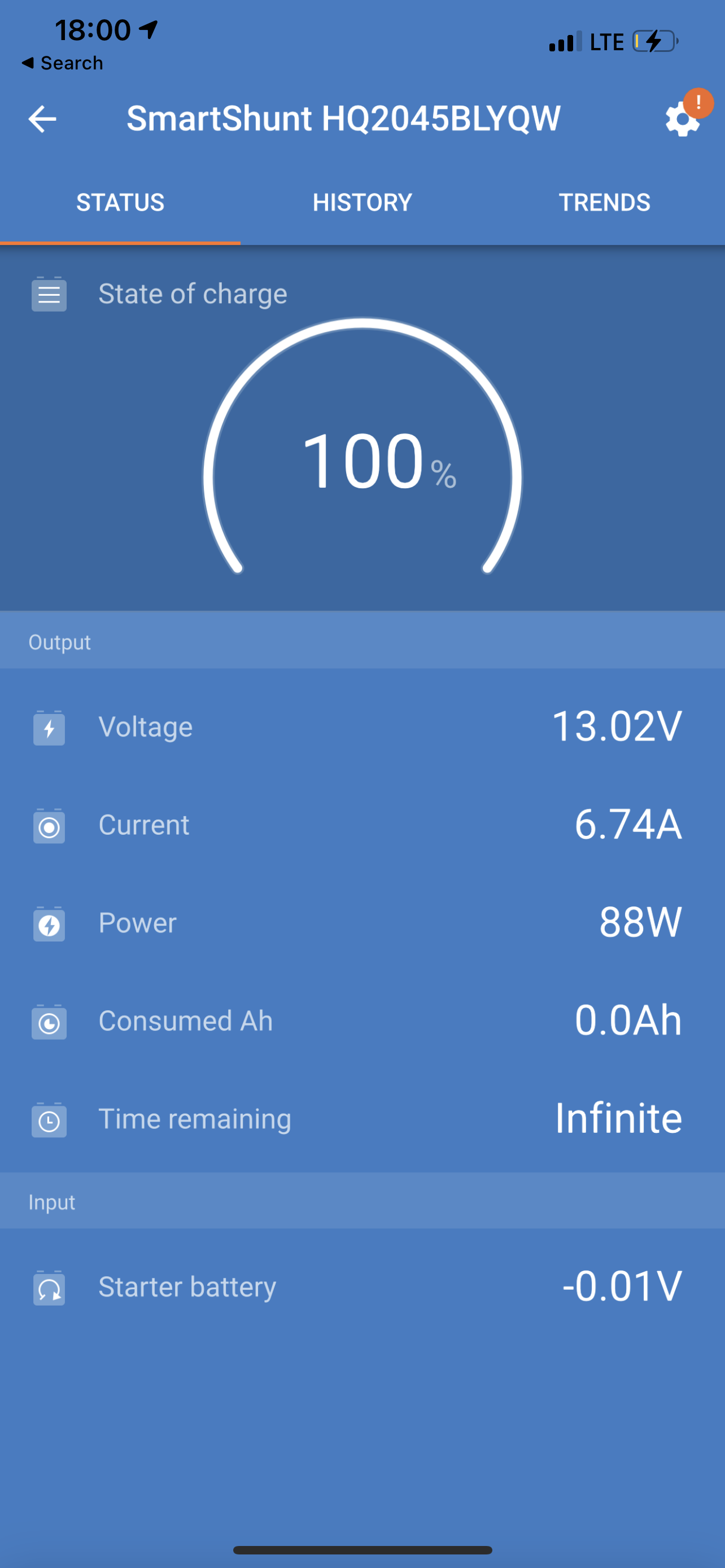

The DC wiring for the Isotherm Drawer 85 fridge/freezer that I recently added is the only thing connected to the system right now, but the panels have no problem keeping the batteries at 100%. The charge only goes down to 97% overnight. I have a new ACDC breaker panel on its way and will put everything on this new house bank when I re-wire it.

Yes, I used a Sailrite kit. I started by buying a 7/8" 2-bow kit, but added a third bow for more support. It ended up being the perfect size. It was tricky to get the height, position and angles just right since it needed to be positioned so that the backstay runs right through the middle. Of course the backstay position relative to the bimini changes as you go higher or lower. After much tinkering, it is now just right. It adds a nice amount of shade, is the perfect height so that I can still stand on the seat (I'm 5'10") and it is still easy to see the top of the mast from the helm. You can also stand on the seat and use the BBQ.
It looked aesthetically nicer with a bit of bend past 90 degrees. It is just gently bent in and held with the hardware. The two added aft supports add to the bent look since the cockpit tapers toward the stern. I have since added a small forward support and am thinking of adding one horizontally from the front to the back near the top.
You are welcome to come take a look at the bimini in Alameda. If you like the dimensions, you could measure and copy to make it easier to build. I think if I were to do a 4-bow, I'd put the extra length aft and leave the forward part where it is for visibility and ease of moving around the cockpit.
The amount of solar I have has been plenty. I haven't yet finished rewiring the new panel, so I just have the fridge/freezer, Vulcan 9 chartplotter, bluetooth for wind instrument and recently added Raymarine wheel pilot on that house bank for now. My batteries go down to 97% overnight and are charged back up before noon. I haven't been on a long enough trip with the autopilot to know what the draw will be like yet.
