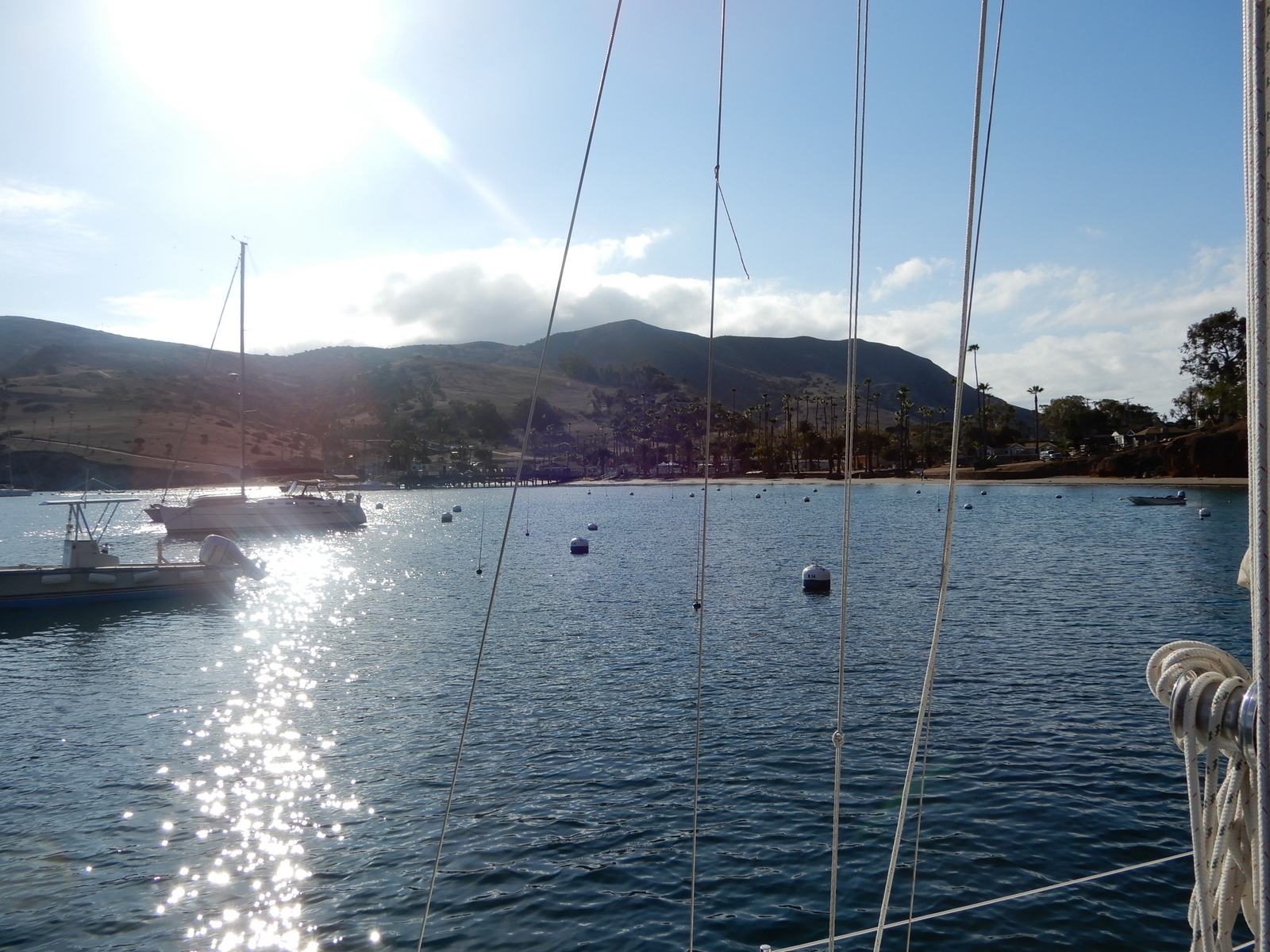

The four of us had spent the week of Thanksgiving at the island. The weather had been crisp, cold and clear and as always this time of year the Isthmus was almost empty. There were probably 20 boats in the Isthmus and maybe 30 over at Cat Harbor.

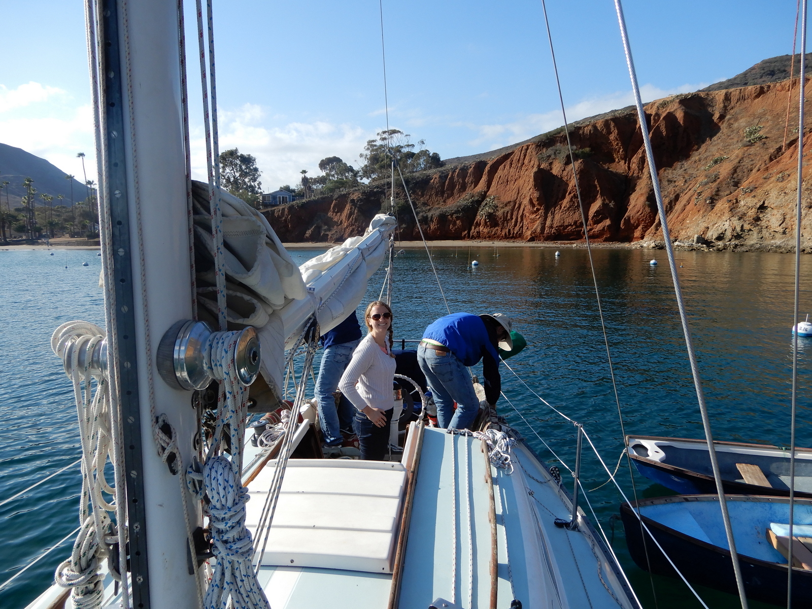

We had a nice Thanksgiving meal at the Harbor Reef and it had been pleasant enough to eat at the patio outside. The trip was winding to a close when the weather report indicated we had some weather headed our way. We started packing up, getting the sail covers off, bending the sheets back on.
The weather was still beautiful And we weren't in any particular rush. Most of the other boats in the harbor had left earlier. My better half rowed ashore to give Roxi the Klee Kai one more walk before we left. She ran into Teresa one of our islander friends. Teresa asked "So you're going to stay then?" The mate replied no, we all have to get to work tomorrow. Teresa's eyes widened, "You need to go now!"

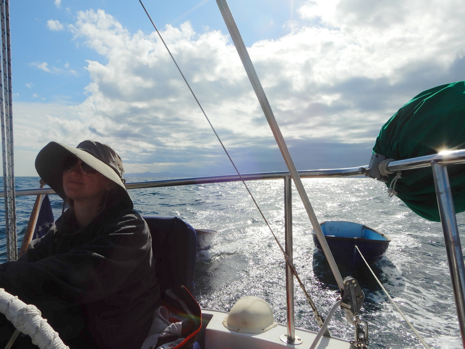

We powered out through the fairway as we raised the main and unfurled the jenny. By the time we cleared the reef and passed Ship Rock we were rail down doing 6 knots. Still a little bit cold but a beautiful day. As we left Catalina behind the funneling effect of the island diminished. Swell was a soft 3 to 5 ft. The wind was a little lighter and now coming from our port stern quarter. We were able to ease off the sheets and we are still flying along. Both dinghies were surfing.
Way off to windward we could see a black wall extending across the horizon. After a couple of hours of a beautiful sail that black wall had become more distinct, but still appeared to be in the far distance. The crew expressed some concern but the captain said no, we are well ahead of it. Another hour passed and the wind had lightened even more. The sun was out and we were taking our jackets off and enjoying the day. Our speed had dropped down to about three and a half knots.

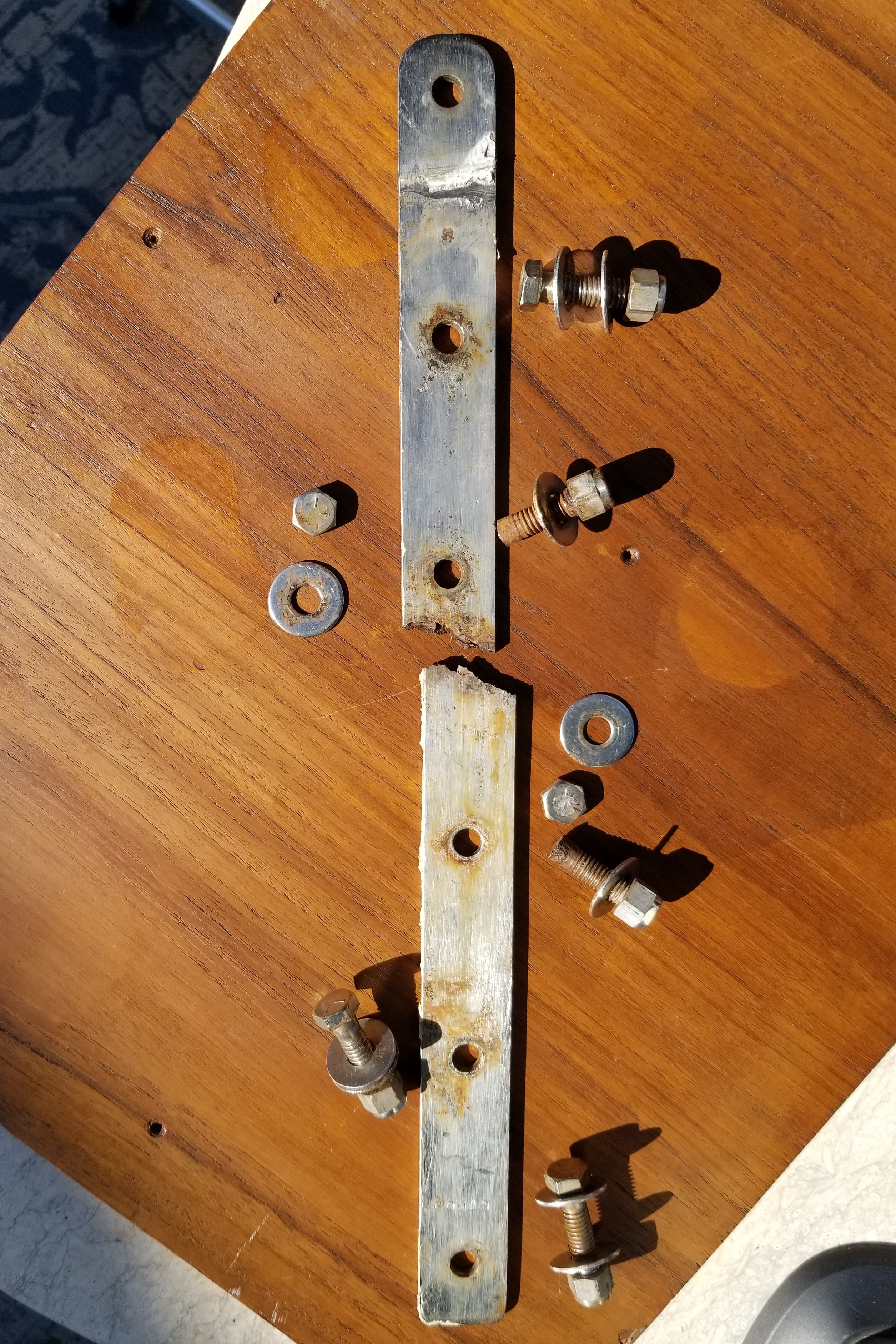

We furled the genoa and dropped the main. Once in the harbor all was calm. We now had just a steady light rain. After landing we started to pack up. My son was on the dock bailing out the dinghies but when I looked at him something seemed off. The sleeves of his foul weather gear we're too short by half, and the pants ended mid-calf. Both armpits and the crotch of the pants were split open. Somehow my 6 foot 4 son was wearing my daughter's old foul-weather set. I finally got a chance to go below. The loud noise when we were rounding the point was the cap shroud chain plate cracking in half. The heads of two of the bolts had shot off into the cabin. The only thing holding the Mast up was a single bolt and the backing plate.
