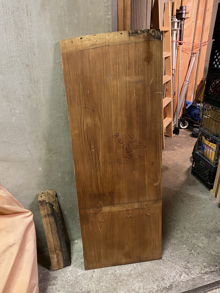

Old bulkhead with rot

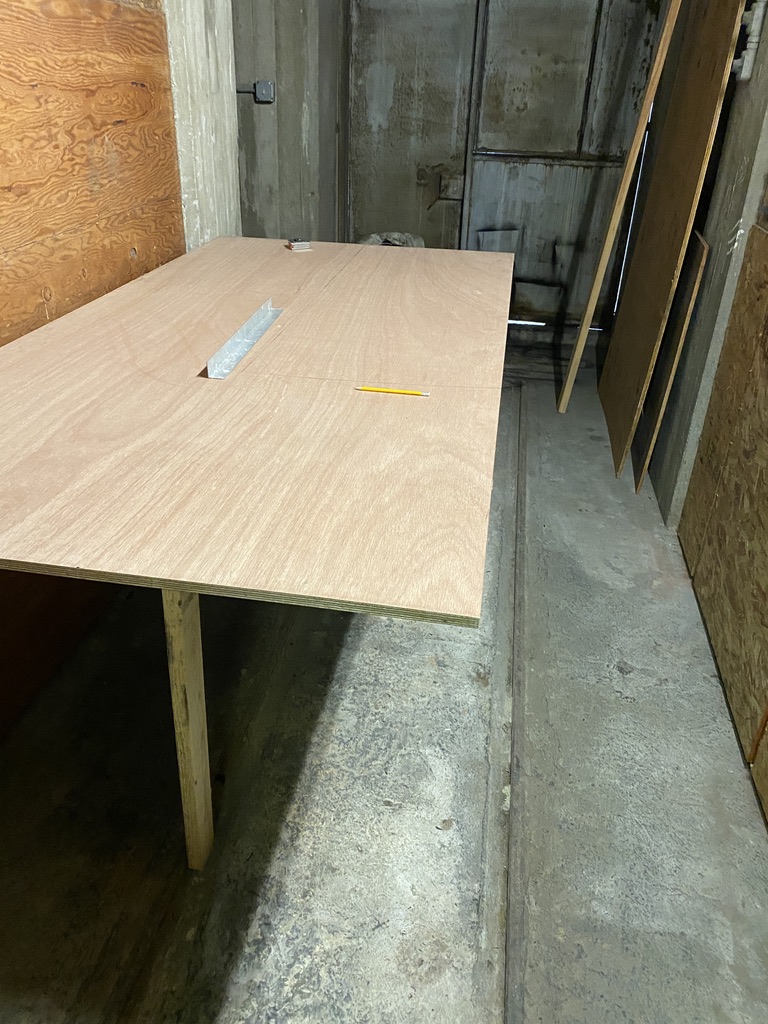

Fresh Hydro Tek
Fresh Hydro Tek
Dry fit bulkhead
Dry fit bulkhead

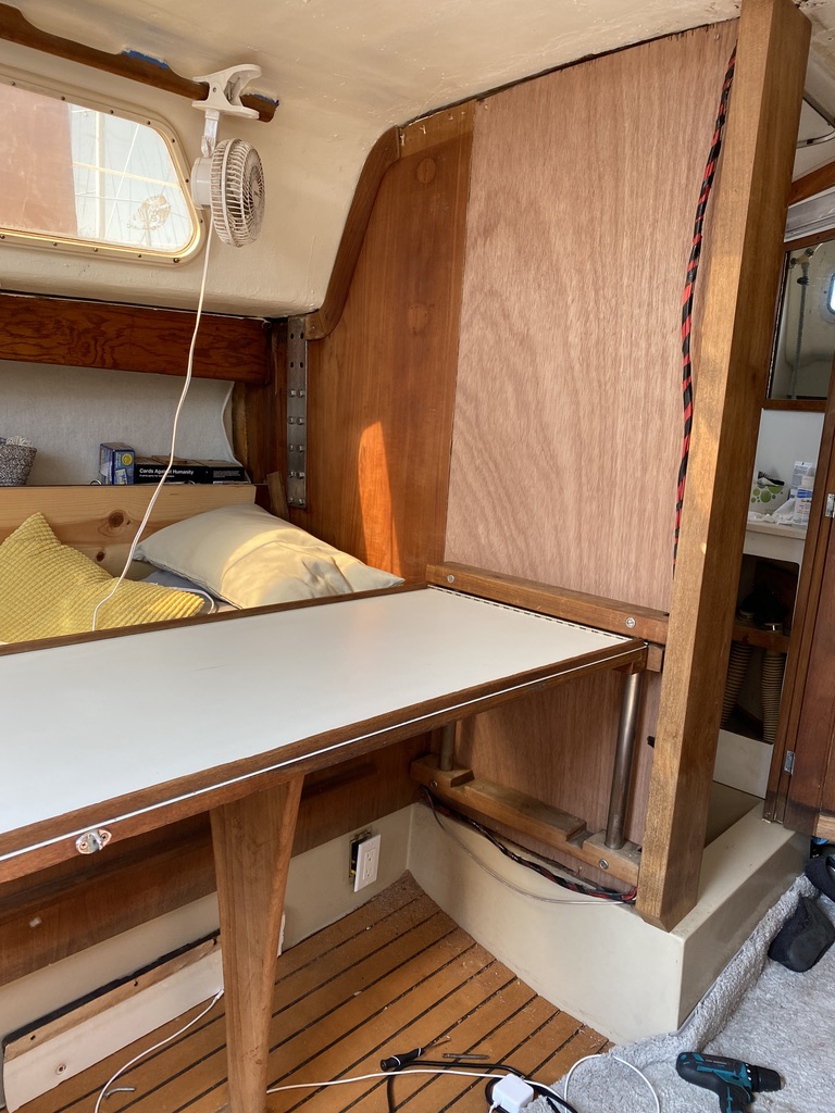

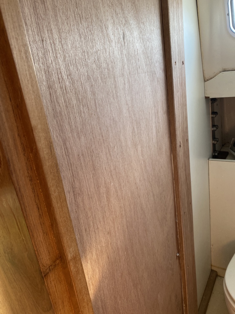

From inside head.. new compression post, new bulkhead piece, freshly glued and screwed.

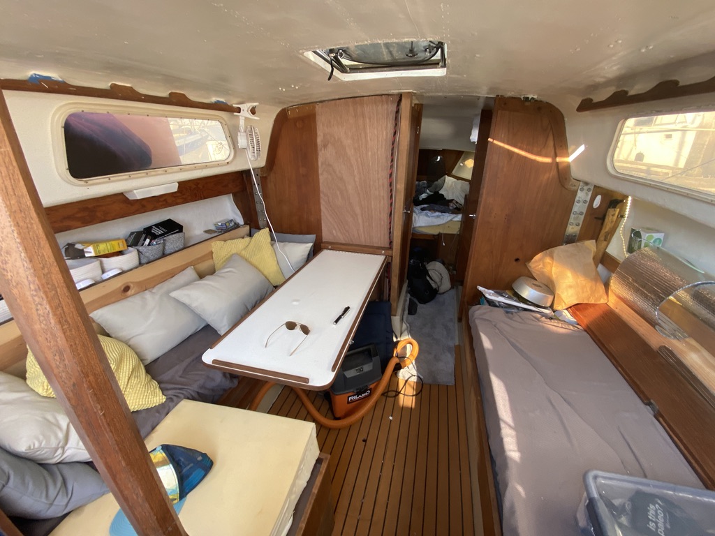

Table re-attached. Ideas for covering the mis-matched surfaces?

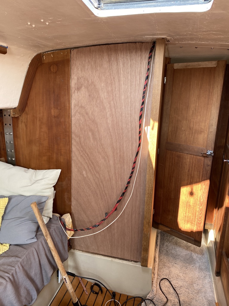

Table dry-fit with new holes drilled. Chainplate bolts removed to saturate bulkhead with penetrating epoxy. Will install mast wire cover later after saturating that corner with penetrating epoxy and creating a safe place for water leaks to go.
