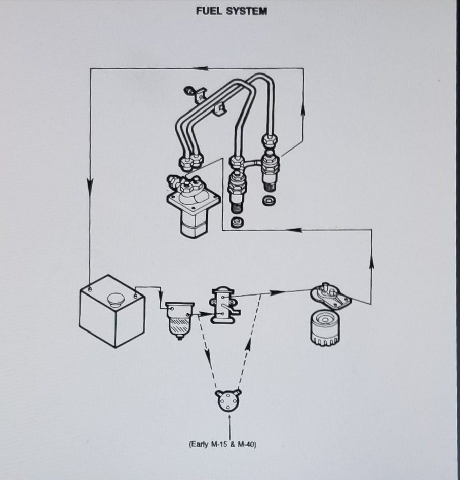

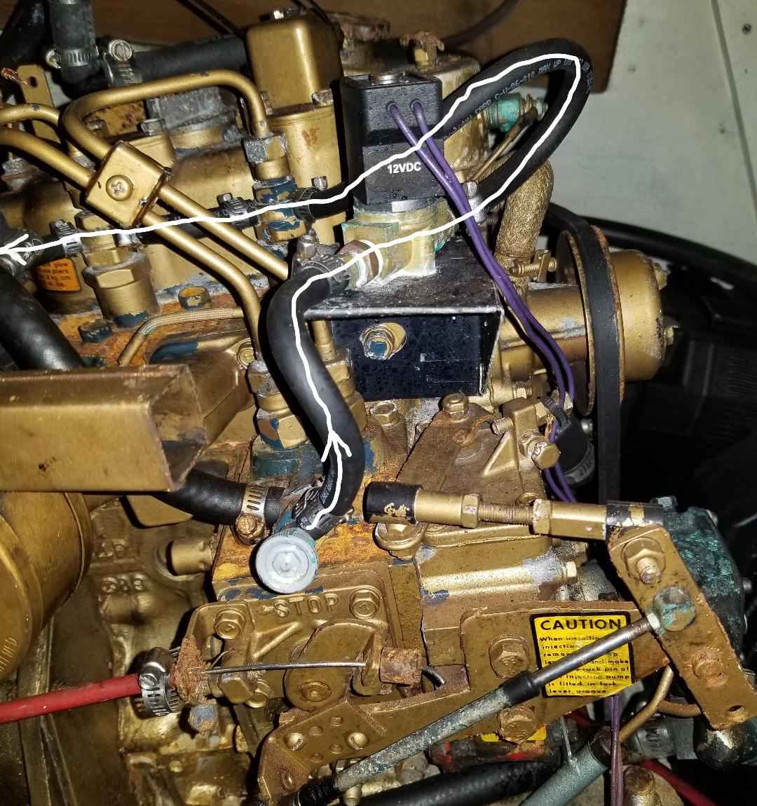

The key words here are "self bleed return valve" . Unlike many of the older diesels, the Universals have a valve instead of a bleed screw. It feeds a hose that connects to the injector fuel return line.
When this valve is opened the fuel pump goes to maximum output and fresh filtered fuel runs by the top of the injector pump to the injectors and back to the fuel tank (or day tank if outfitted).This flood of fuel will carry away any air bubbles or specks of crud that could stop your engine. By using this judiciously we were able to keep our engine running under extremely poor fuel conditions. Unfortunately it required me to deal with the valve on the engine and not be out navigating the boat when we were under power. So finally the light bulb moment. Install a solenoid valve just downstream of the self bleed return valve.
new fuel route 2.jpg (257.98 KiB) Viewed 7450 times

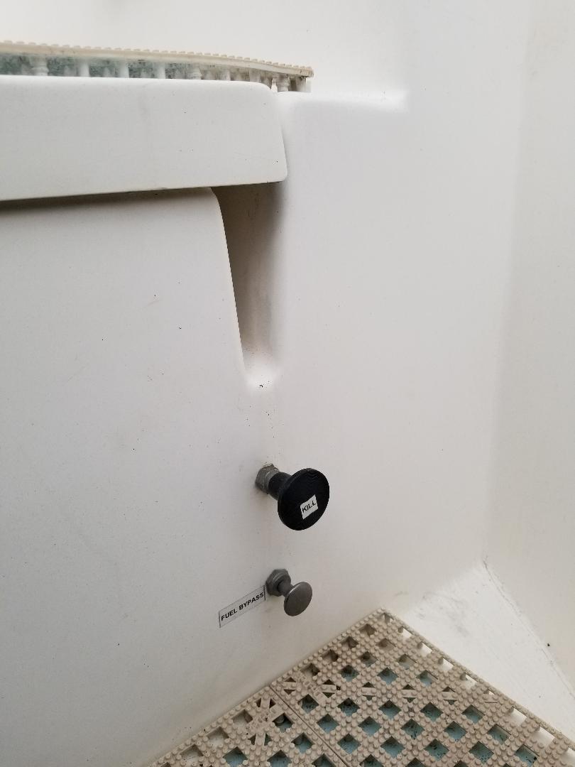

This solenoid is controlled by a push pull switch next to the helm. If the engine misses or acts odd in any way, the first thing we try is the fuel bypass switch. works every time.
new switch.jpg (53.47 KiB) Viewed 7450 times

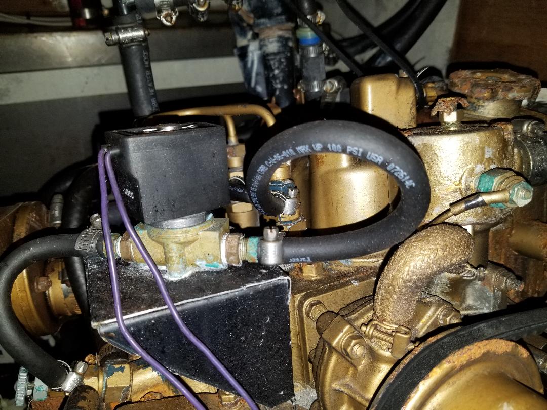

The valve is just a 1/4 inch normally closed oil 12 volt solenoid. I needed to fabricate a shelf from scrap aluminum to support it.

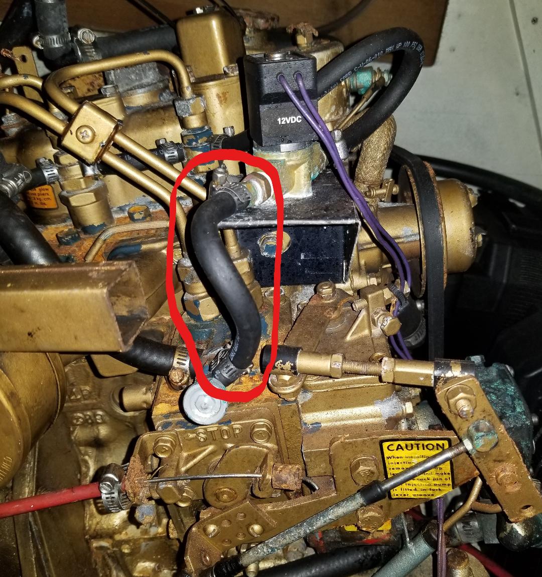

One important note about this modification! Once the solenoid is in place and you have opened the valve you will be turning this short section of hose into a fully pressurized section of the fuel line.
Do not trust this section to spring clamps or cheap hose, it is now a part of your fuel line! Cost and time to install the modification was low. I was replacing all the fuel line anyway and the solenoid was 20$ the switch 8$. Considerably less than the dinner out and a bottle of wine for the mate if I left the helm to work on the engine.
