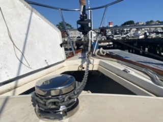

You should be able to see it if you zoom. Mounted on a Starboard plate with Starboard backing plate below. Powered by start battery under setee as the Yanmar with 120 A alternator always running when using windlass. No problem pulling 33# Bruce. Deck foot switches and a cordless remote with relay mounted under vbirth shelf just behind anchor locker. CB mounted aft wall of setee near battery.
Thank you. I like the starboard.
