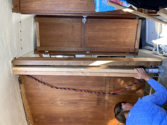

Finally got around to installing the new compression post. Using a bottle jack and a couple 2x4s worked great. Had my friend hold pressure on them so they wouldn’t pop out. Now to replace the rotten wood on the bulkhead.
