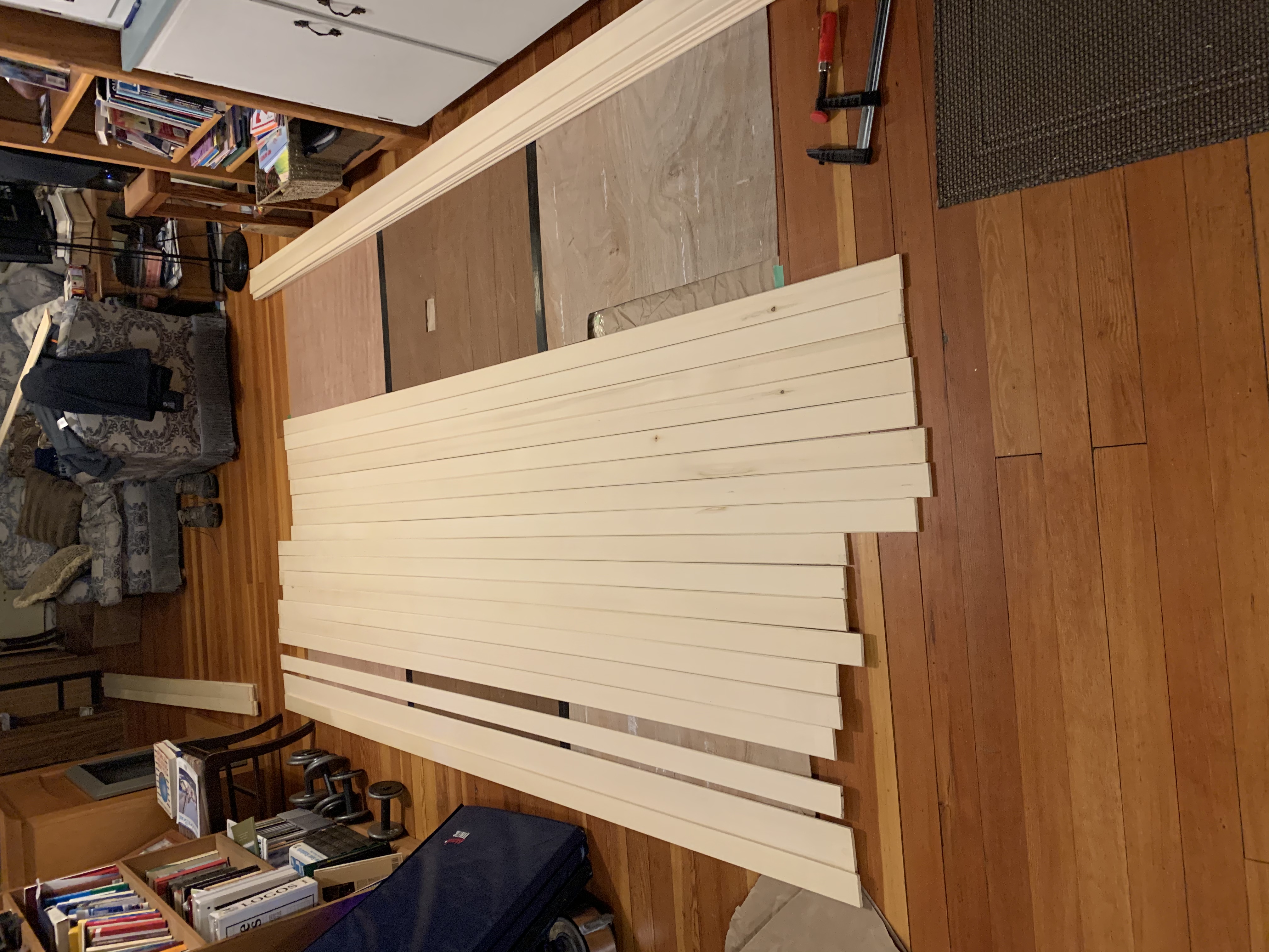

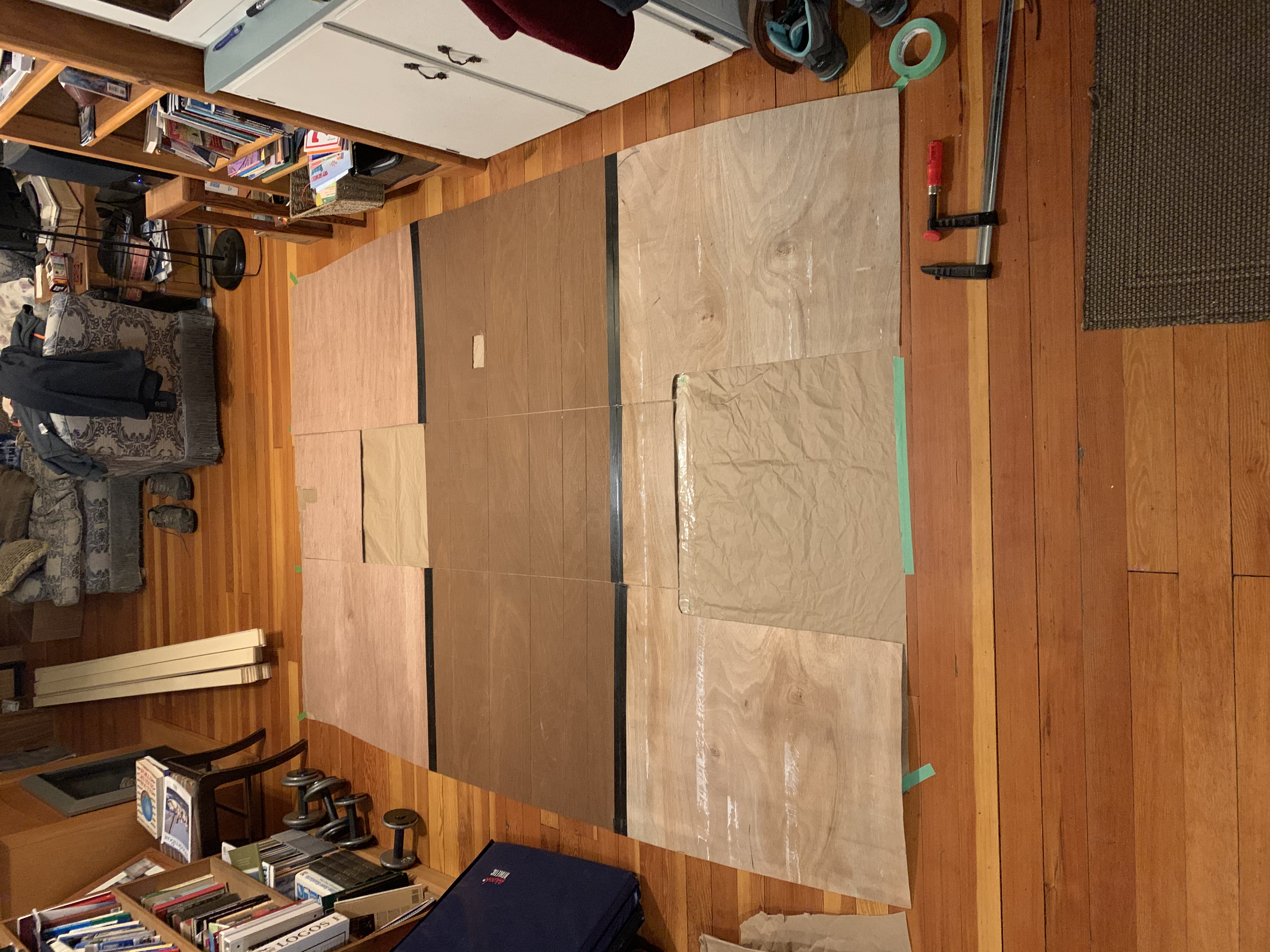

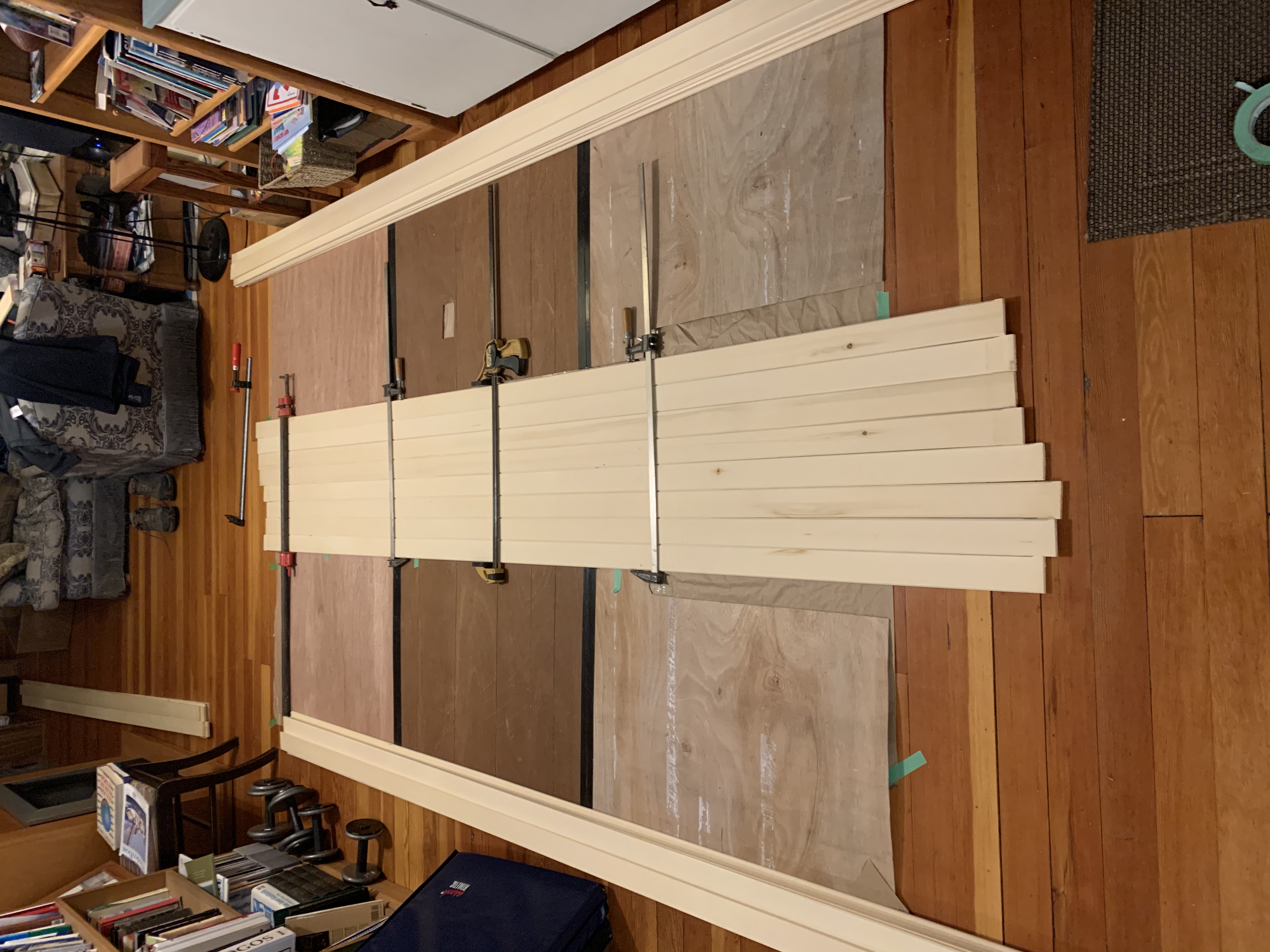

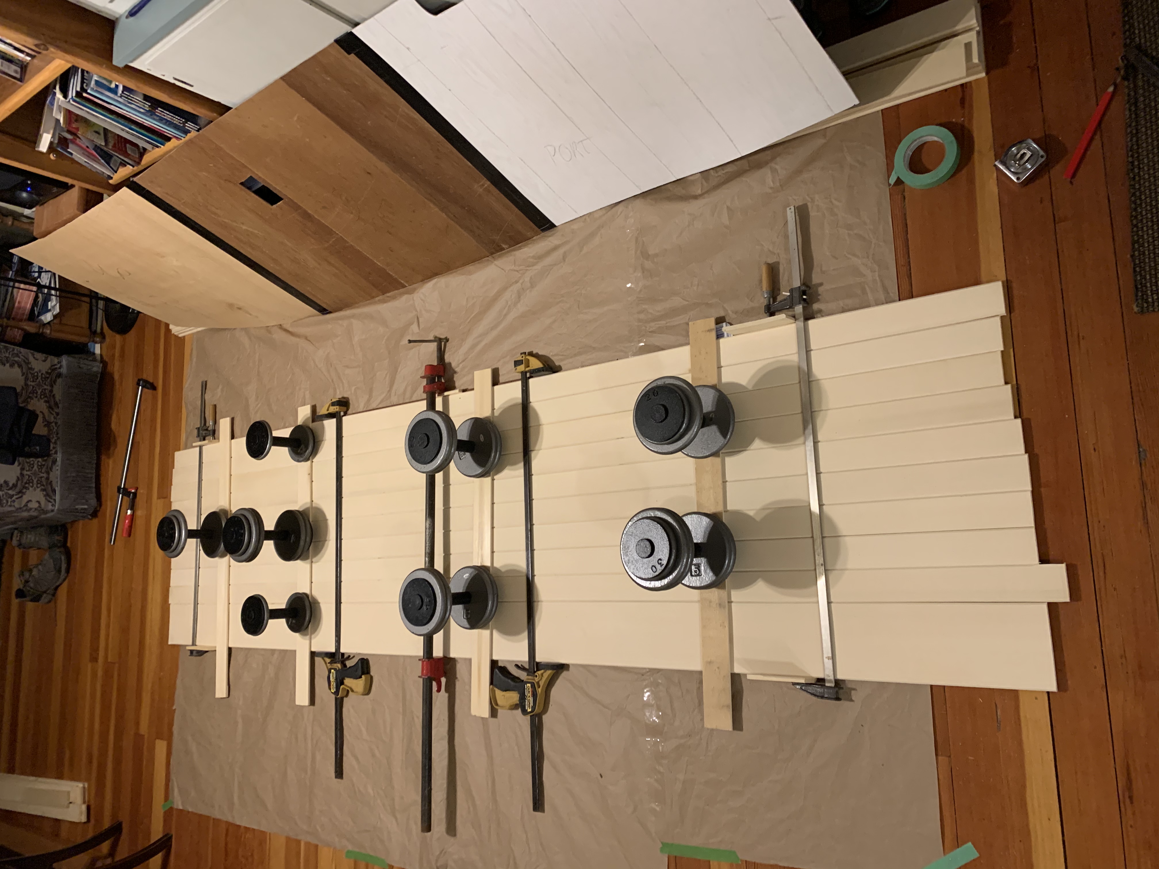

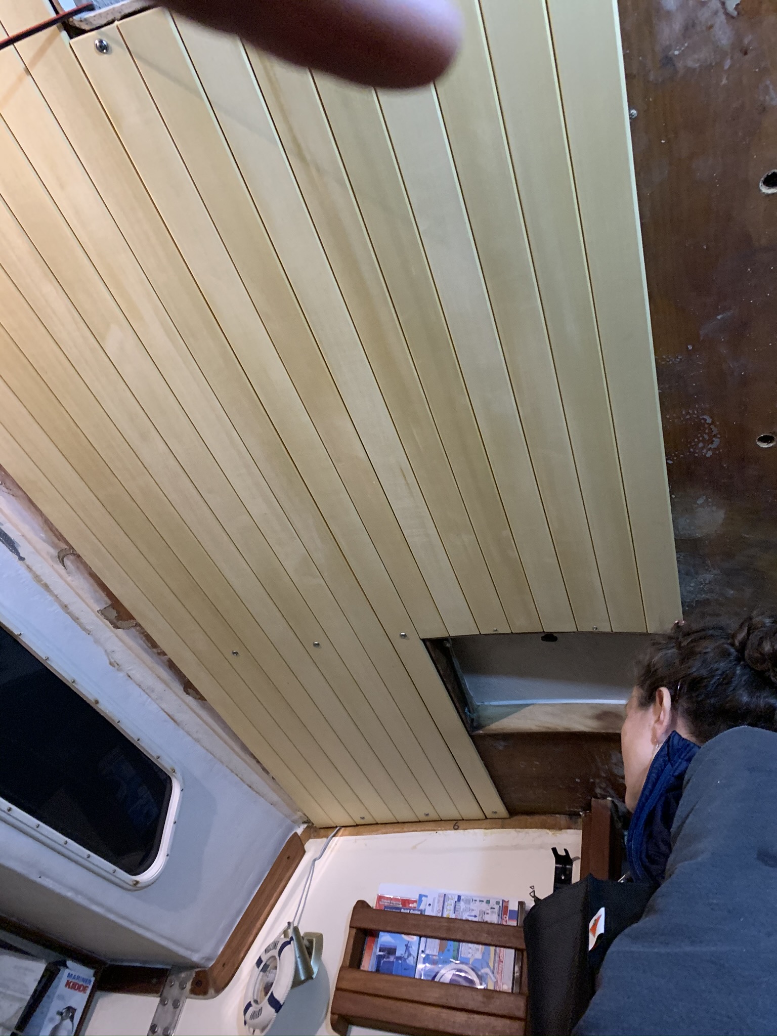

Al, we just redid our ceiling on a Cal 2-34. We used the old panels as patters to make news with a different configuration. We got a deal on some really nice Yellow Cedar screwed it up in panels with closed cell foam against the fibreglass. The yellow cedar was milled to about 3/8 x 2 1/2”. This was glued with PL Premium to door skin.
No more mould! Cleanable and refinishable. I think the same could be done with a birch ply.
