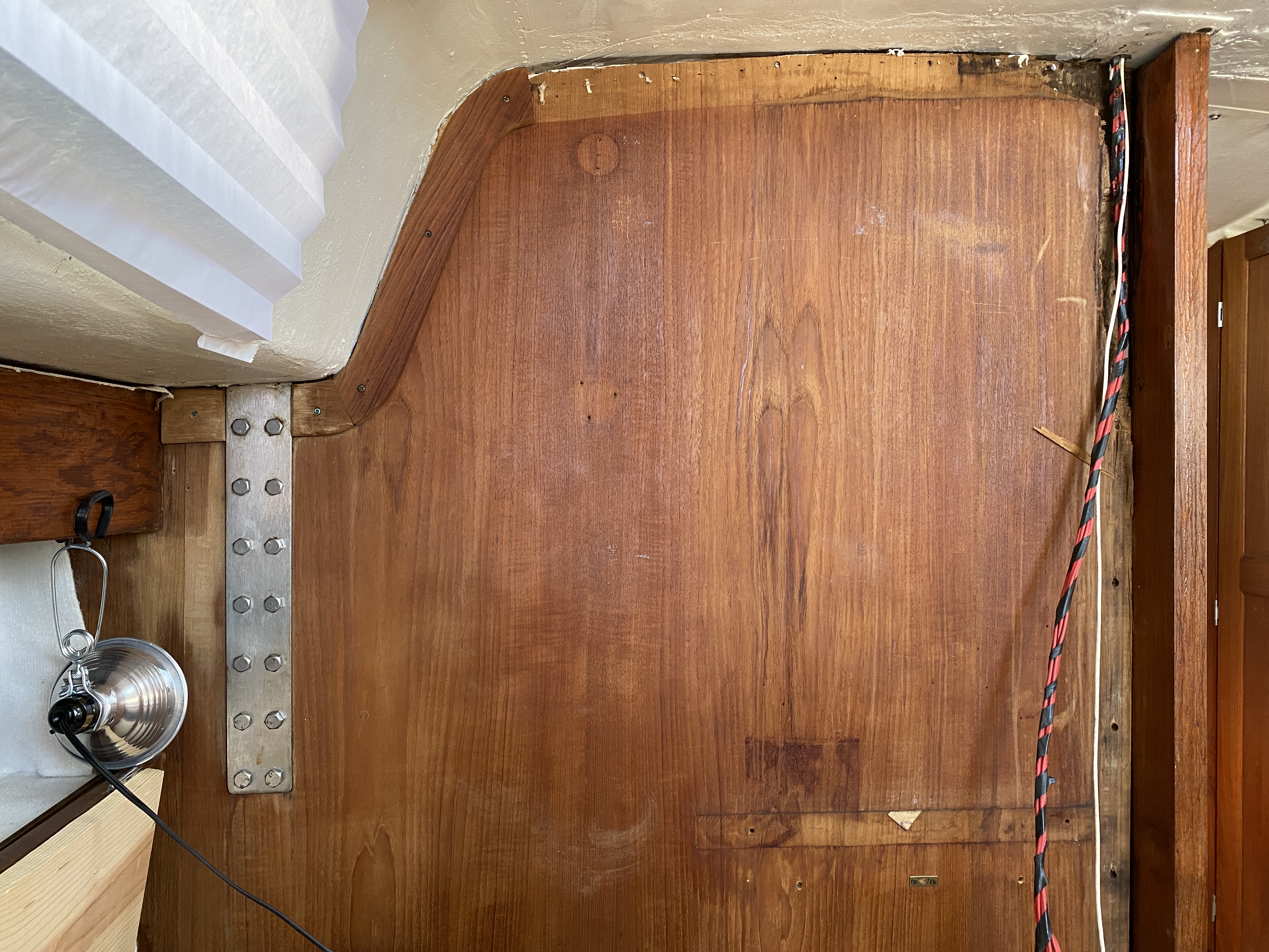

My bulkhead is not tabbed to the ceiling.. should it be? 1978 34-III

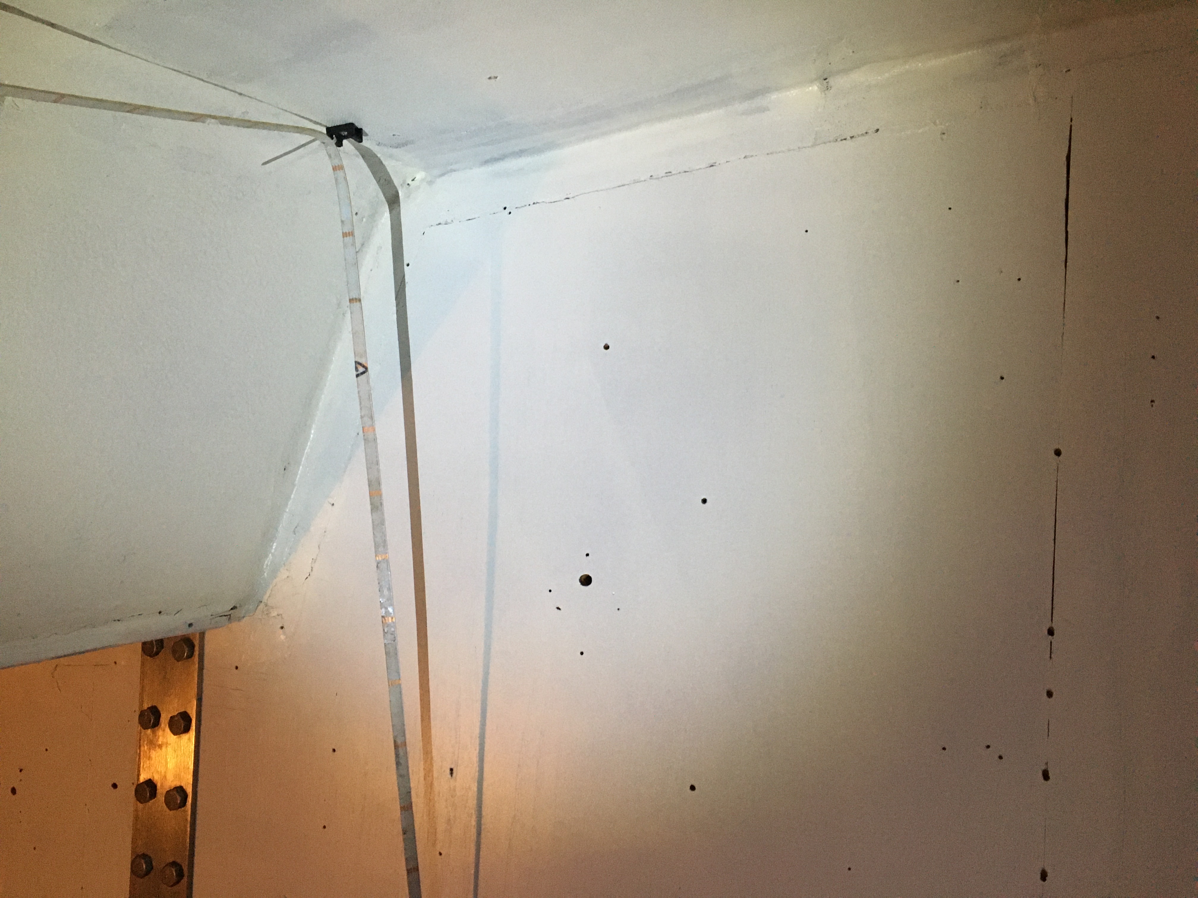

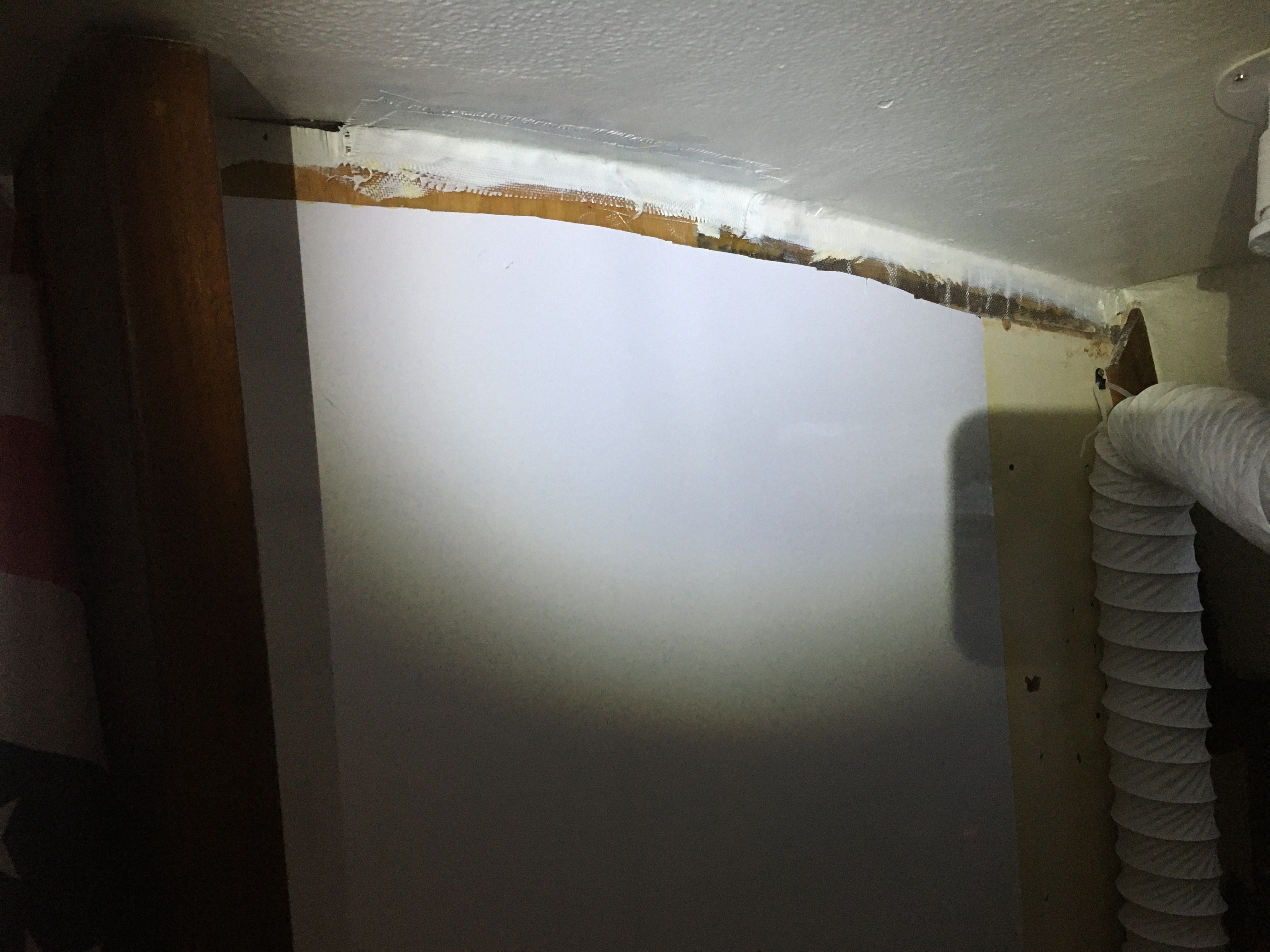

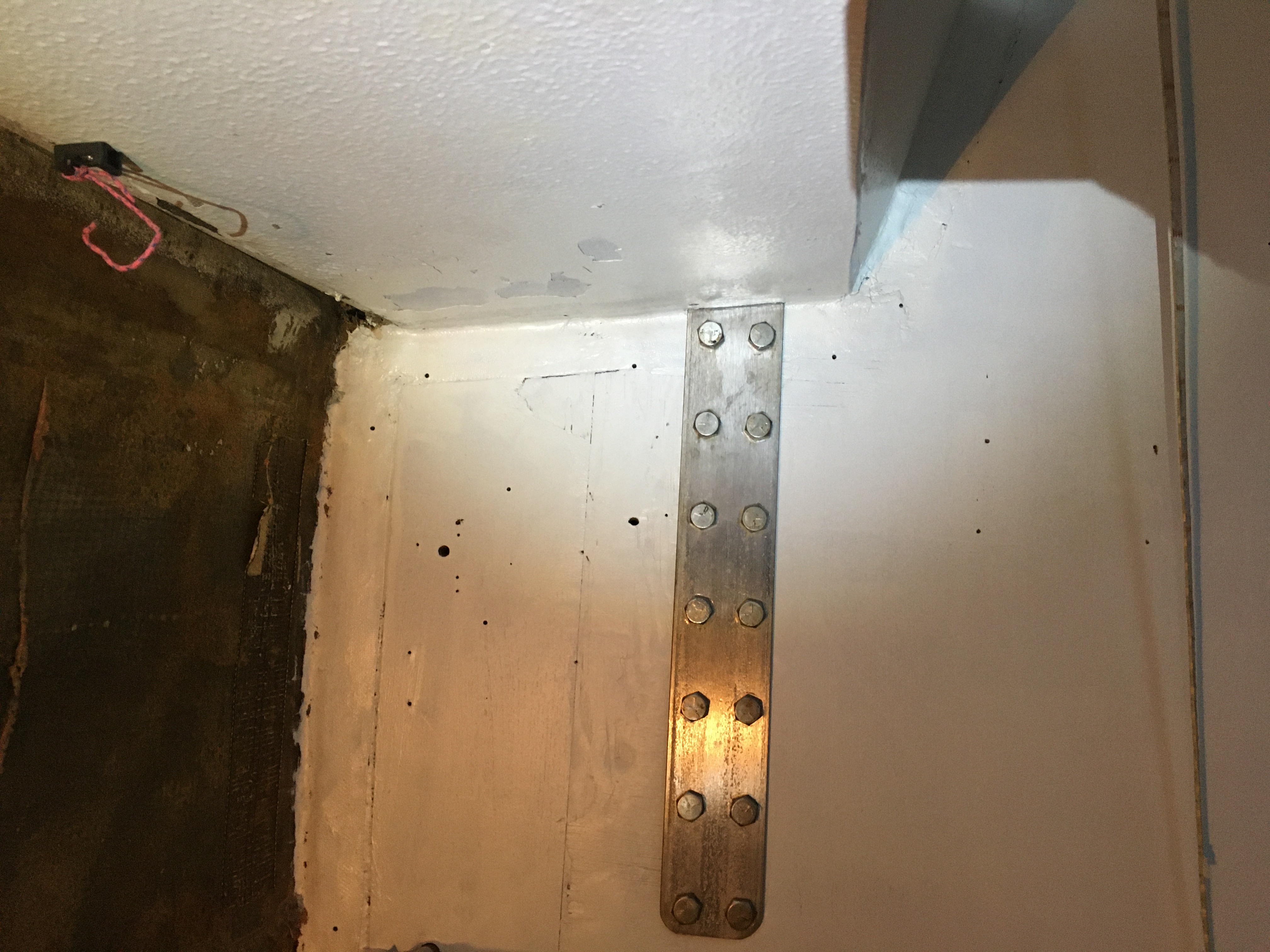

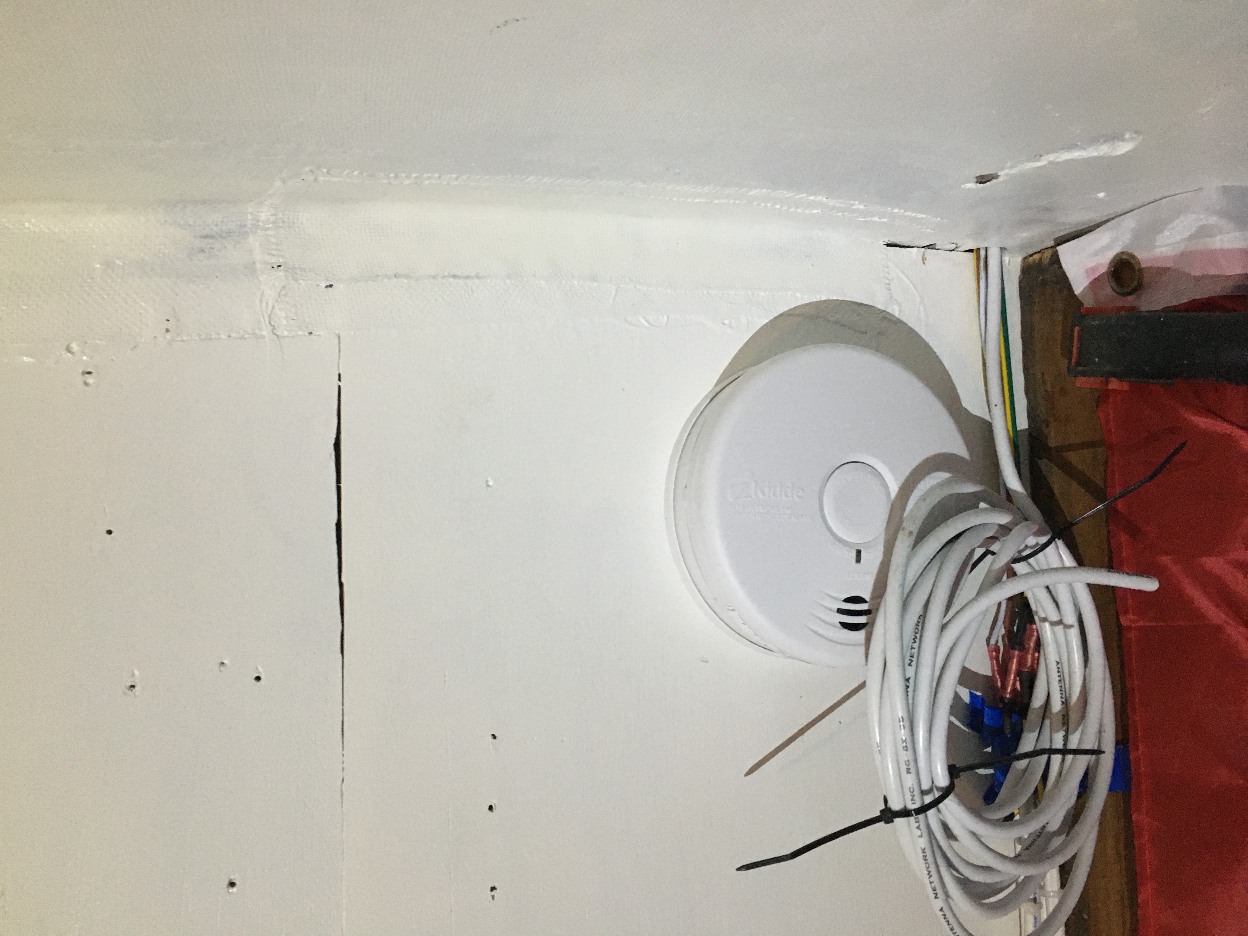

Mary, 1976 Cal 2-34. Yes, fore and aft. It only looks like 2 plies of about 4 oz. which is pretty lightweight. I used same when replacing center portion of main bulkhead. You can see the vertical seam in the third picture.

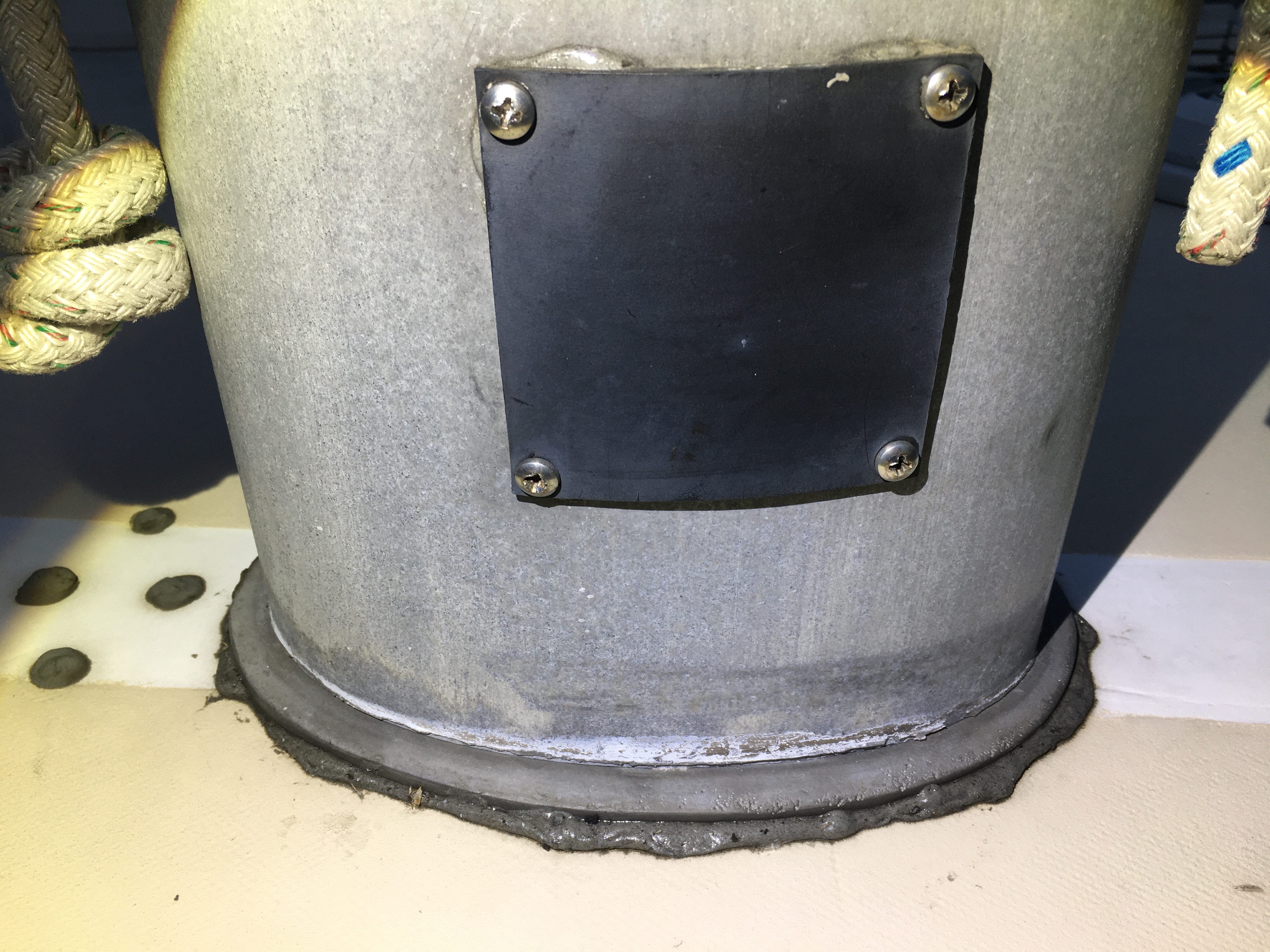

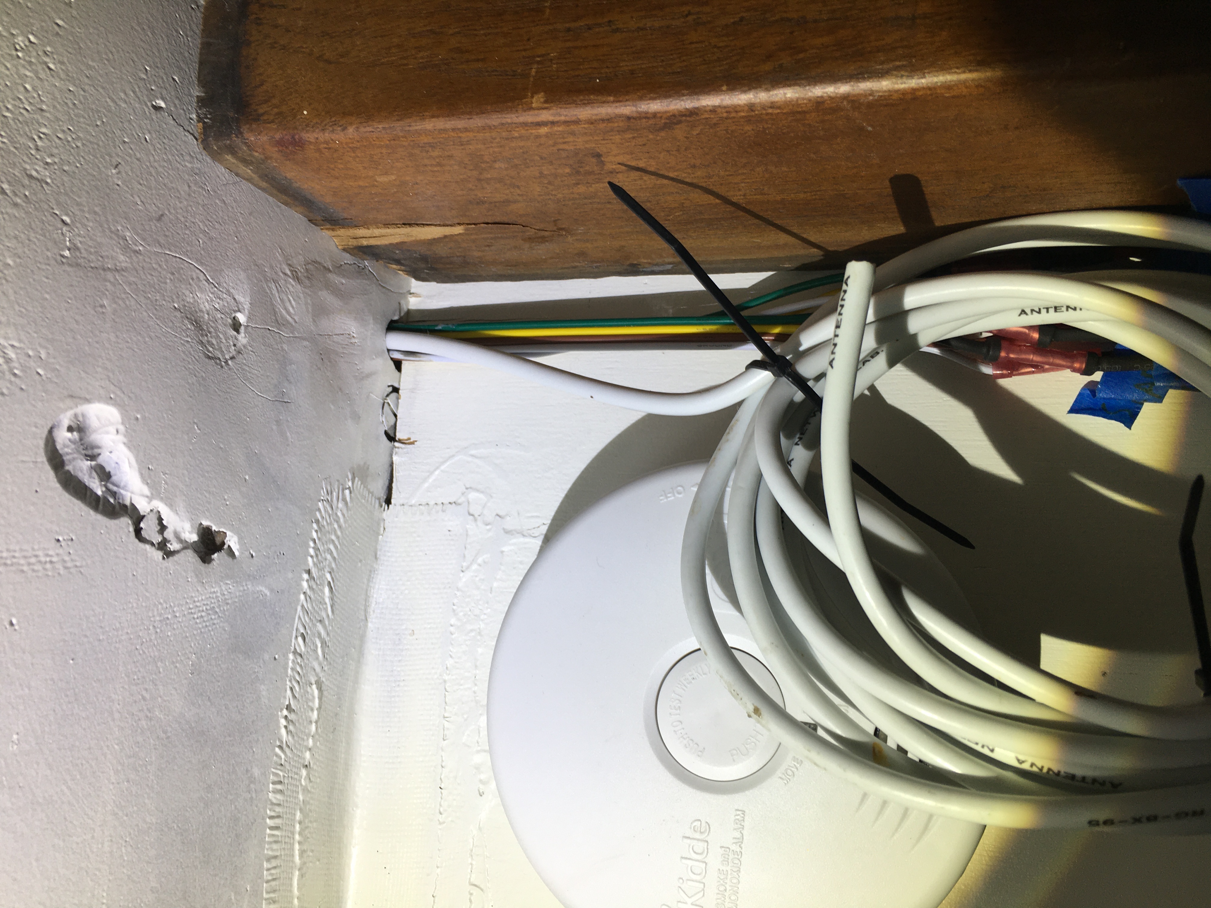

Mary, I did that from topsides with the mast down and access to the mast step. Previous owner had siliconed around the bottom of the mast step (on the outside where the mast meets the step) so any water that entered the mast could only exit through the wiring hole. I caulked in a tube around the wiring hole and fed everything through that. It’s about 2” high so in theory I could get 2” of water stuck in the bottom of the mast before any entry into the boat, however it drains well now.
I have an access port in the bottom of the mast, so it could have been possible to do all that with the mast up but certainly more difficult. I think ensuring the mast step drains well is probably the first step. You can see there is no sealant where my mast meets the step (I do have plenty of butyl oozing from under the step that I need to clean up).

For the person that placed a stainless cover over the access hole. Bad idea. The stainless <> aluminum electrolysis will eat away at your mast. Replace it with a aluminum cover plate and do not use stainless bolts to secure it. A smear of silicone would work, and if needed could be pried off..
