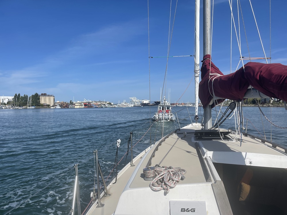

The mechanic who did the rebuild partially re-installed it and I went to help him finish the install. It did go into both forward and reverse gear, but made such an awful noise that I did not continue to run it.
Last Friday, I towed it to a boatyard to get it looked at and possibly hauled. I haven't heard back from them yet.
