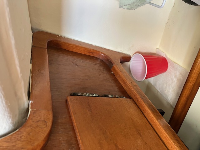

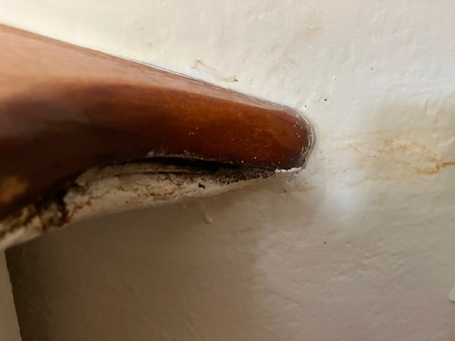

Aloha All,
I have not posted in a while. My Cal -2-30 has undergone extensive refurbishing in the last 3 years and I thought I was ok for a while, until I noticed water entry below the port bulkhead. It looks as if the water is coming from the wood sandwiched between the 2 glass sheets. Has anyone experienced the same issue? I do not see any wet areas inside the boat from hardware attachments in the area. Could it be from a bad or leaking hull to deck joint? I have a rub strip all around the boat and don't want to rip it off unless I am sure the it needs to come off. The Cal 2-30 has a gap in the toe rail in that same area. Does anyone know if the hull to deck joint could be the culprit? If so, how do I go about fixing it. You would think the joint does not have any vertical gaps when attached to the hull.
Thank you for any input. I appreciate your advice.

Hi Joe. your pictures did not come through and they would be very helpful to make some educated guesses. The deck to hull seam is bolted and then glassed. The leaks that I have seen in the past were related to impact, but now possibly just age related stresses. Odd though that it would leak in only one spot without impact damage. The first thing my mind went to was a leak further up that just shows lower. Specifically the chain plate. water can travel along the margin of the bulkhead till it finds a exit point below. If the leak is indeed at the deck hull seam it is not a killer job if you can just pull the rubrail off in a small location. It will depend on how brittle the rubrail has become. I look forward to your photos.

Thank you for your reply. I got to find out why the pictures did not go through. Nonetheless they just show the spot right below the aft wooden bulkhead where the water enters into my newly painted cupboards. Looked at another CAL 2-30 yesterday. The owner showed me where he applied 5200 sealant to stop the same leak in the gap between the rub rail and the toe rail. I have done so thing morning and we'll see if that did the trick, albeit a temporary fix. The rub rail is coming off when I haul out in April. Also a good time to reseal and look at the chain plates again. I have done extensive removal of the core on the stb side and it's dry. Time to go back to work on the port side. Unfortunately that core is a big problem on these old boats. Aside from that they are build like tanks compared to today's yachts where you can see through the hull with a flashlight.

Without the pictures I was thinking of the main bulkhead so my theory was less than accurate. It sounds like the suspected leak would be about at the area of the scupper, the gap in the toe rail. I personally have issues with the 5200. Their motto of "sticks anything to anything, forever" indicates what a pita it is to take apart when the time comes. If you find you need a source for a new rub rail we do have a couple of places on the site. Hopefully the sealant will do the trick.
